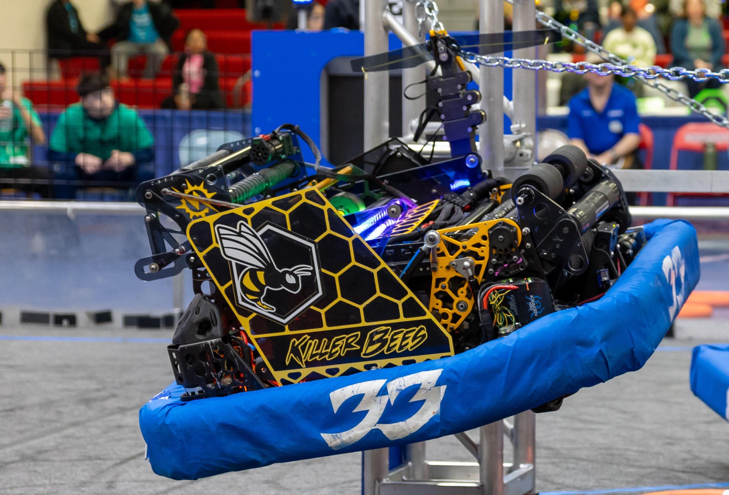

Wanted to come on here and share a good picture of the robot and additions that we ended up competing with at Michigan State Champs and the Championship.
  • Entire new shooter that was used for Livonia, MSC, and champs. Featured a polycarbonate teflon skinned tab-and-slot box that compressed the note side to side down to 12 inches. New shooter was powered by 4x Kraken x60 for each “set” of wheels to be driven independently. This allowed us to be able to increase our consistency moving back to the wing line. A few matches at champs, the auto pathing ended behind the truss and was still drilling shots.
  • Fast last-second side climb. This was a big addition for Livonia and allowed us to increase our chances of ranking high due to abandoning the trap right before Kettering. Features a similar mast to our 2020 robot, and has a spring loaded hook that would pop out and grab a single link of the chain similar to 1678 and other teams.
  • Fourth limelight in the center of the robot added for MSC for TargetPose, along with hours and hours of software development. This was the biggest change for us between MSC and Champs. We were able to redefine some of the targeting and localization (not a software guy so can’t really comment further than that) in autonomous and teleop that greatly increased our shot accuracy.
  • Updated intake to remove the vertical flappers and move to a full width complaint front roller. The flappers worked great in the shop, but after week 1 and new notes + new carpet, the notes were flying like hockey pucks on ice. The full width complaint roller worked very well for us the rest of the season.
The Killer Bees thoroughly enjoyed playing in Hopper this past weekend at champs! We were very fortunate to be able to select and play with 4414 High Tide, 3128 The Aluminum Narwhals, and 8576 Golden Warrior Robotics. This alliance worked great together and was disappointed to see it end early.
We will be competing in many off-season events this summer, feel free to stop by and see the bot! We would be more than happy to answer any questions you may have.
