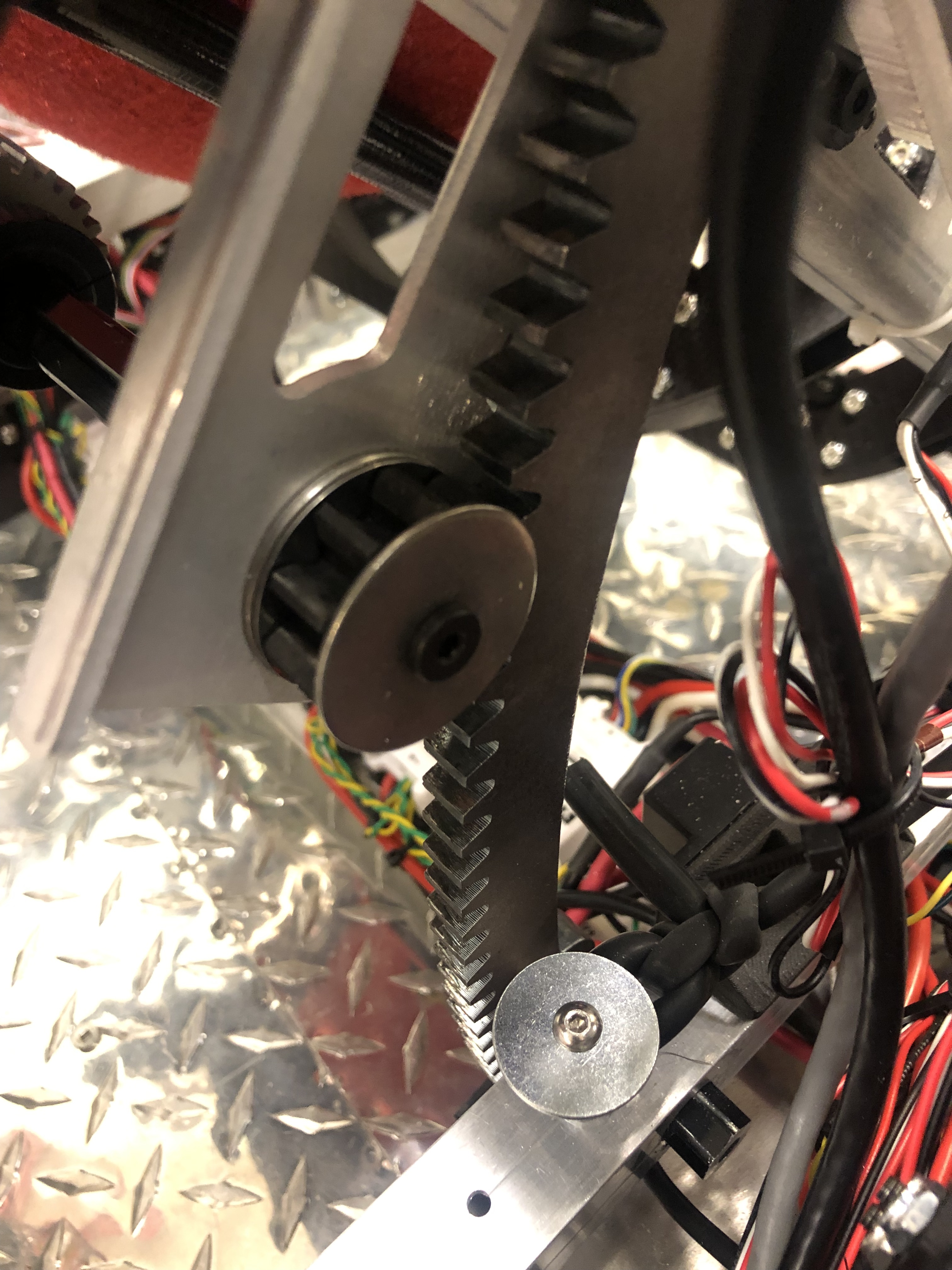

We did, in fact, take a lot of inspiration from our Stronghold robot. The shooter and hopper is conceptually similar, but with a couple of key changes:
-The hopper can hold two balls and loads them from the opposite side than the way the balls shoot, so the balls are “first-in-first-out”.
-The way the hopper/shooter tilts is by using a small gear that drives along a cutout of an enormous gear that creates a rack/track type of structure:
