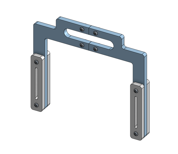

As there already seem to be a few requests for one- here is my design for a simple 3D printable cube jig.
It should be heavily noted this is not intended to be weight accurate to the official cube jig, however, it is a functional alternative.
Note: I recommend having a build plate of at least 256mm x 256mm. I was just barely able to fit each half piece on my Bambulab x1.
OnShape CAD Model
Hardware
  • 4x 1/4-20 x 1.75in Bolt
  • 4x 1/4-20 x 0.85in Bolt
  • 8x 1/4-20 Nut
Enjoy!

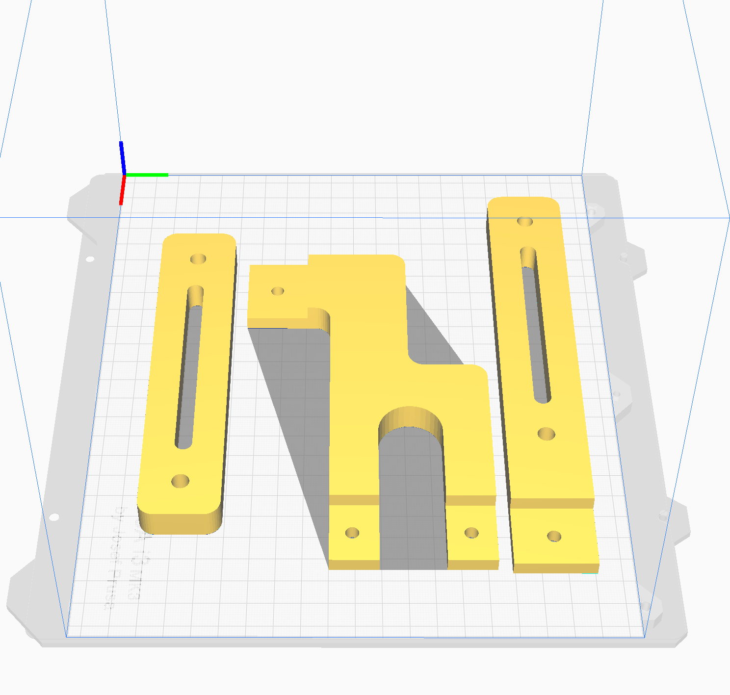

This is cool. It would be really great if there was a way to fit it on a 220x220 build plate. I’m not at a computer today. Will it fit?
I highly doubt it will. Here is how I had to rotate it to fit on a 256 plate.
I just modified the jig parts so that it can be fit onto any 210mm+ printer, and can either be bolted together or CA glued/epoxied. See the layout below (parts are symmetrical so make 2 copies of each). Does anyone know the official weight? I will print with a specific infill % to account for that, but can’t find the exact weight posted anywhere.
Note: the holes are slightly offset (0.01 in) to account for printer dimensional expansion tolerance. I am printing this now so I will share results when it’s done

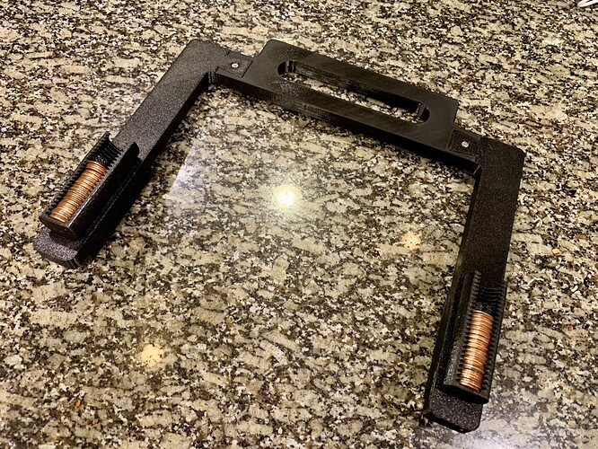

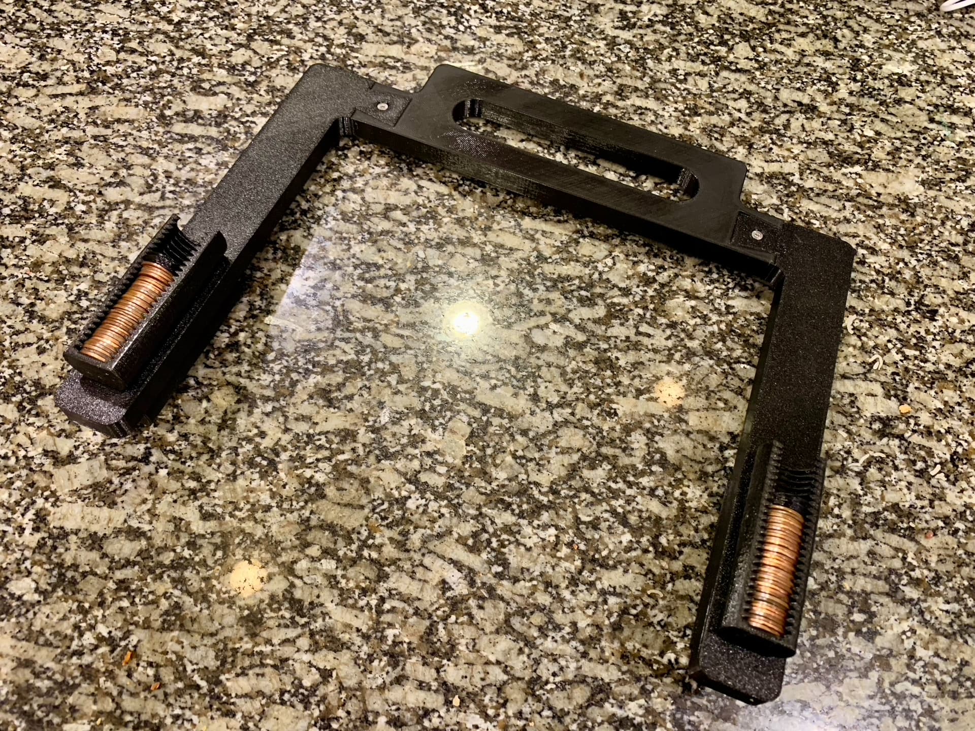

Here is my version. PETG 15% infill with pennies for calibrated ballast.
Thingiverse link is 404 :frowning:
Try now.
