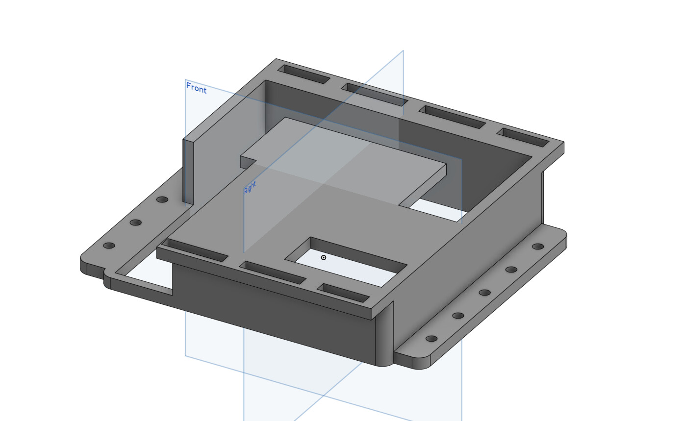

I would recommend printing most of your electrical components a case ( helps with mounting using 10-32 hardware), and you can design slots for ZipTies to go on.
Heres an example of a rio mount case that i made for 10-32 hardware + zipties.

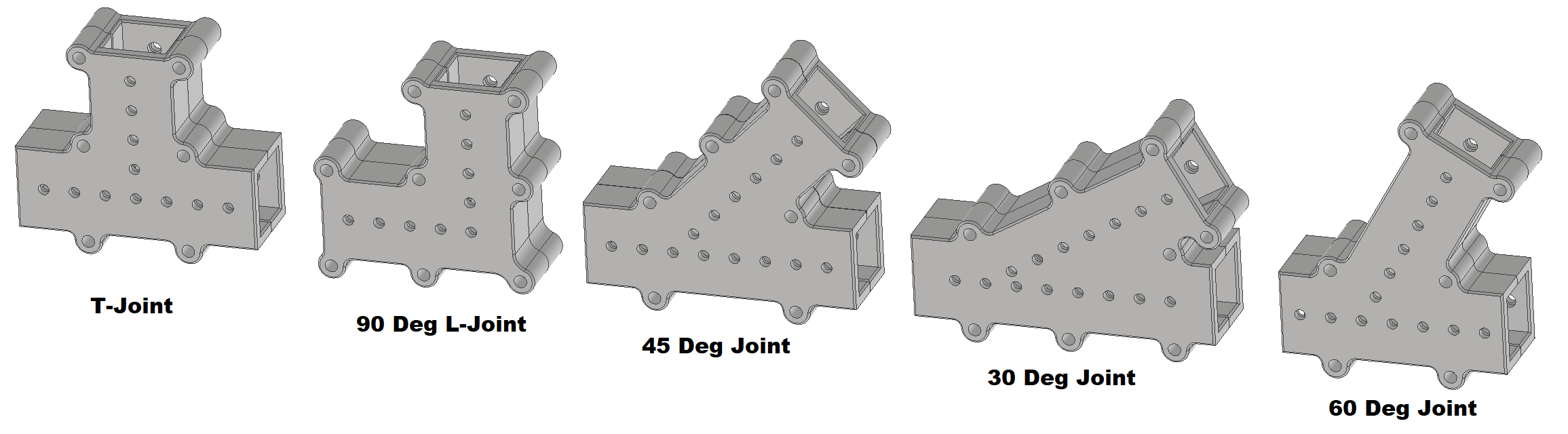

Quick build blocks -

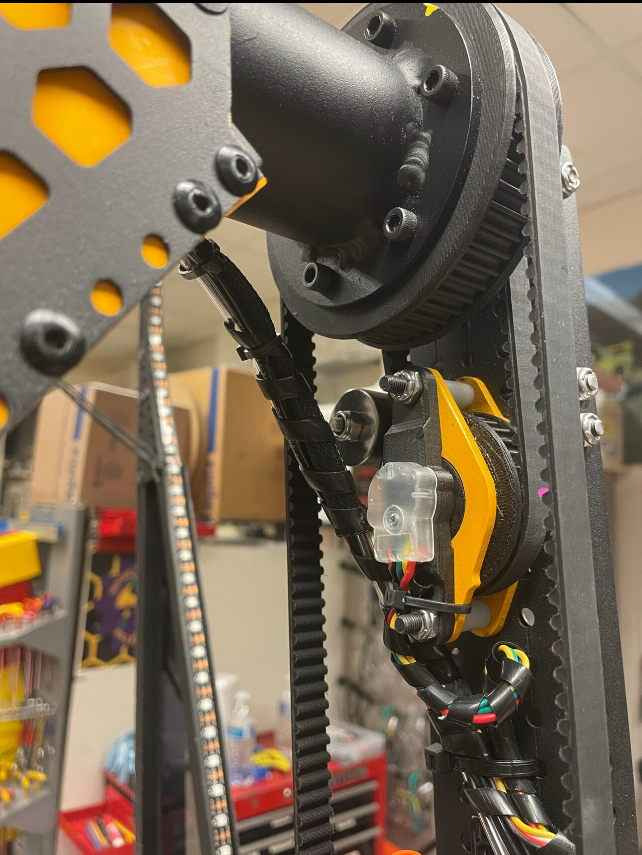

Big fan of printed pulleys if you’re using Onyx / PA-CF. Use the 3D printed insert from TTB and you’re good to go. All of the main pulleys on 33’s double jointed arm this past year were printed.

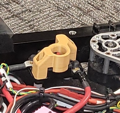

Last year’s thread on this had a great main breaker shroud posted by @cadandcookies. I remixed it for nuts and bolts rather than tapped holes. Worked great for us.
20231107_175320~2

The original Onshape document: Onshape (or Printables if that’s more one’s speed: Printables)
While this version does not include that exact design, it does include various options that have been requested over the years.
Edit: I made the counterbore versions usable with a captured nut. They aren’t exactly the same, and I highly encourage folks to remix and repurpose the design as needed, but since a lot of people have used the original I’ve been trying to make sure as many common variants as possible get captured there so they’re more visible to folks.

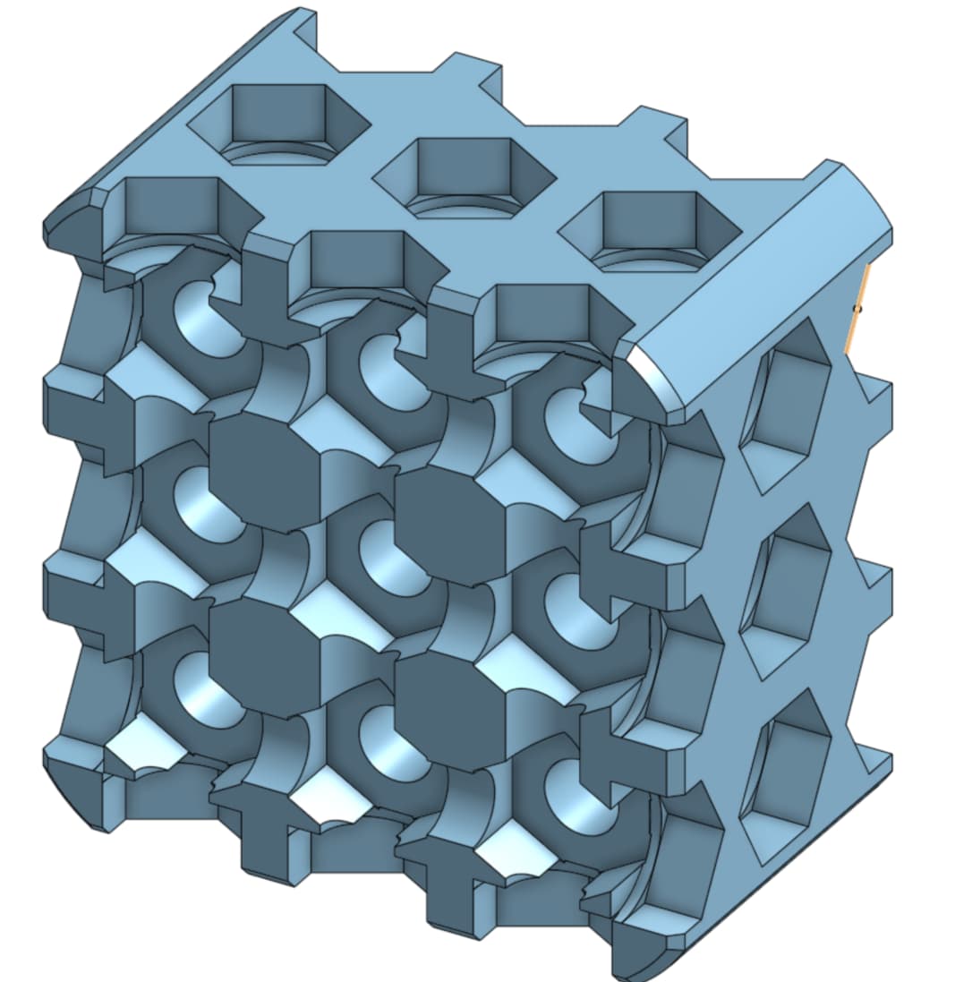

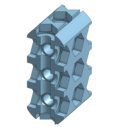

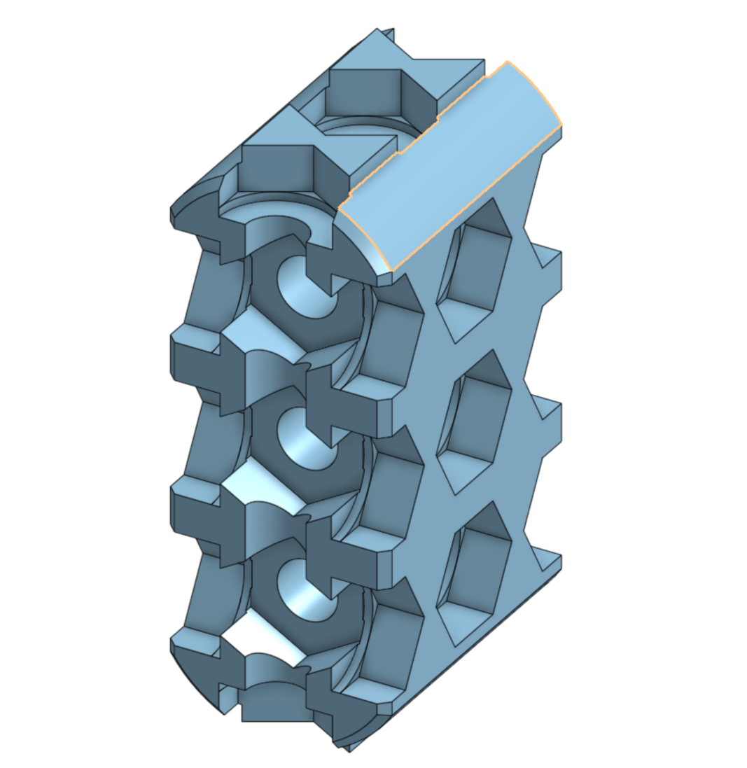

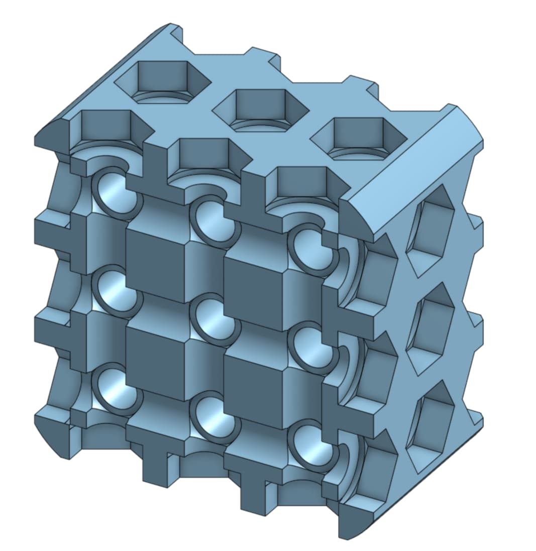

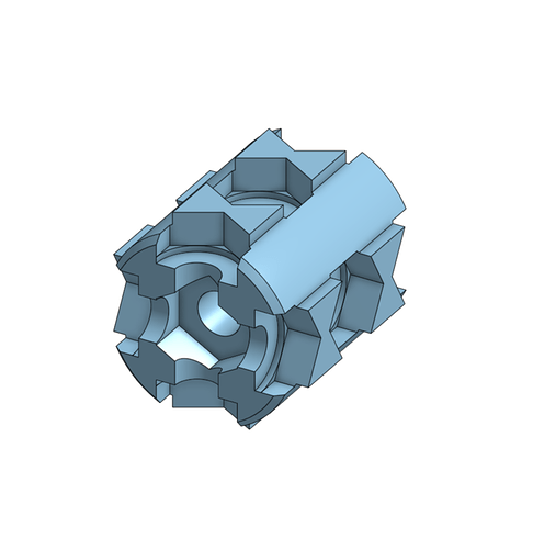

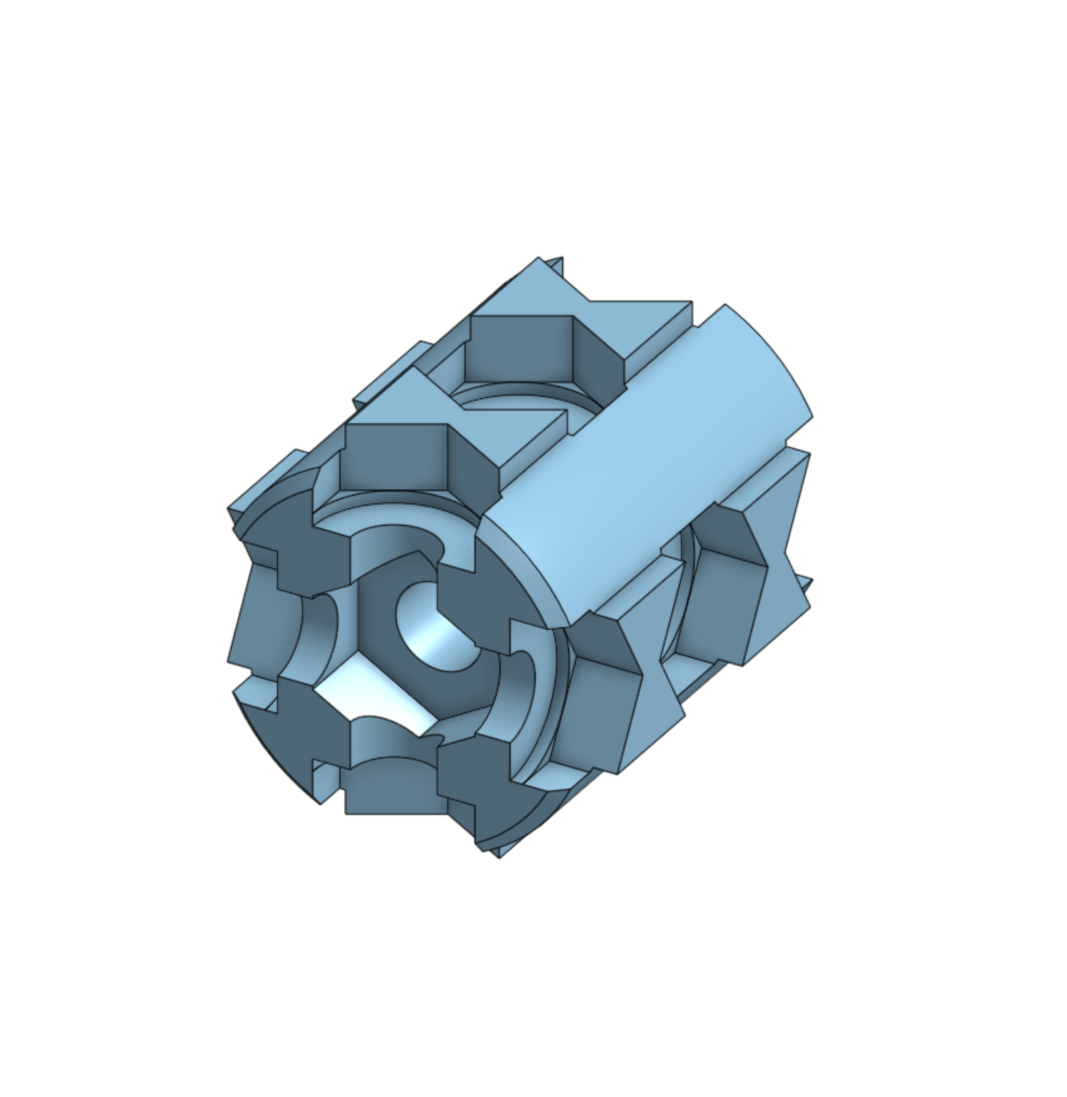

In the spirit of sneaking in under the wire:

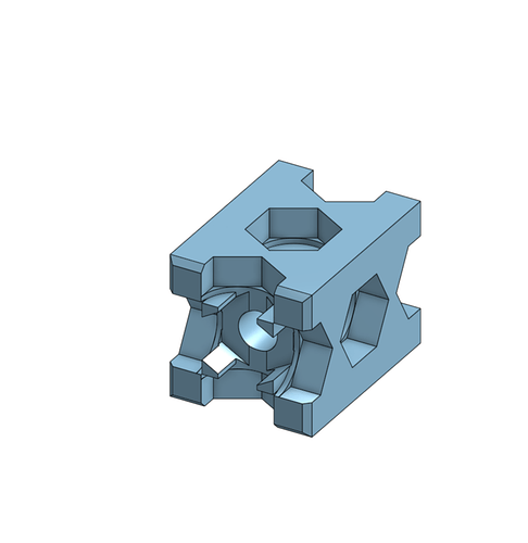

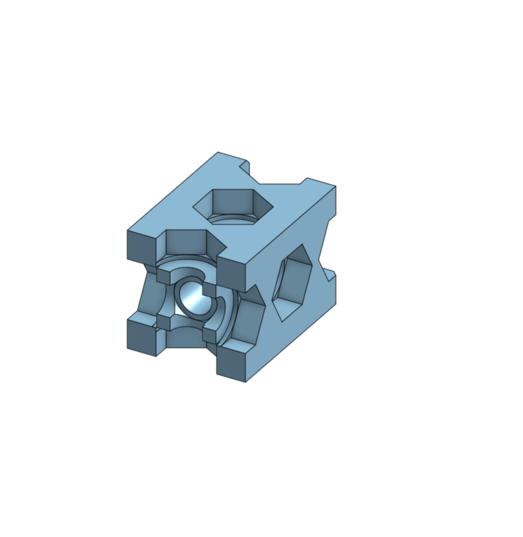

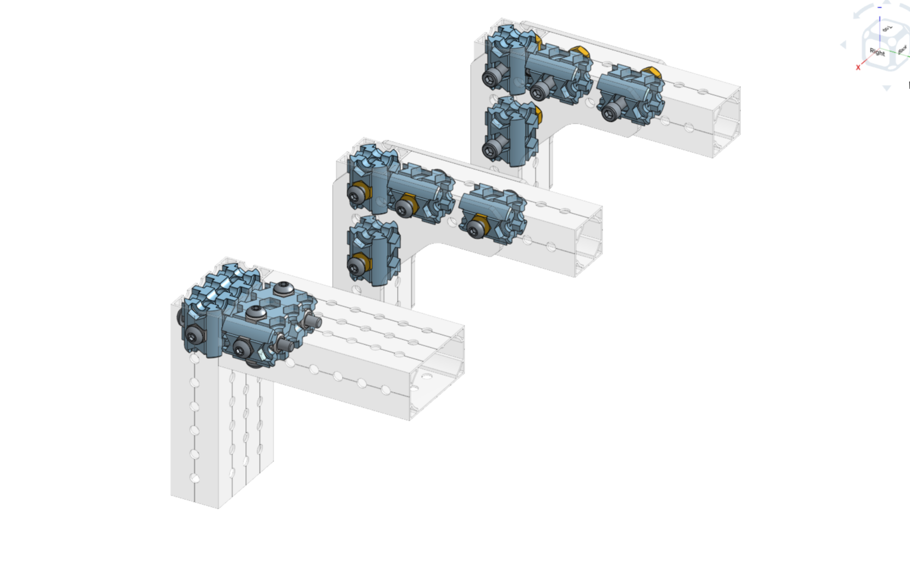

I made some configurable crush blocks for the 0.5"-pitch 10 hole pattern tubing that has become the defacto standard around these parts.
The idea was to have a single part per tube size that we could print a bunch of and keep in stock to make assemblies less prone to people (often me) putting just a little too much force into a tool and starting an irreversible trend of squished tubing.
I opted to make them retain nylocks rather than use heat-set inserts because it’s one less thing to add to our workflow. The blocks have features for anti-crush, blind nut retention and through clamping for situations where you need to attach tubing without adding any external gussets. They can also be configured with clearances to accommodate MAXTube gussets. I’d recommend using the edge clearance holes as depth stops for inserting the crush blocks - stick a through bolt one hole past where you want the block to stop and push up into it. There’s a little 0.25" boss on the outside face for folks who like using pushrods to do so.
Examples:
For 1x1x.125
For 1x1 MAXTube
For 2x1 “Heavy” MAXTube
For 2x2 MAXTube

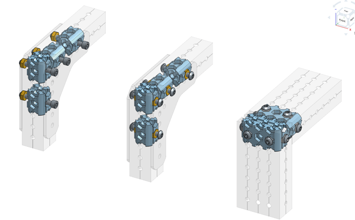

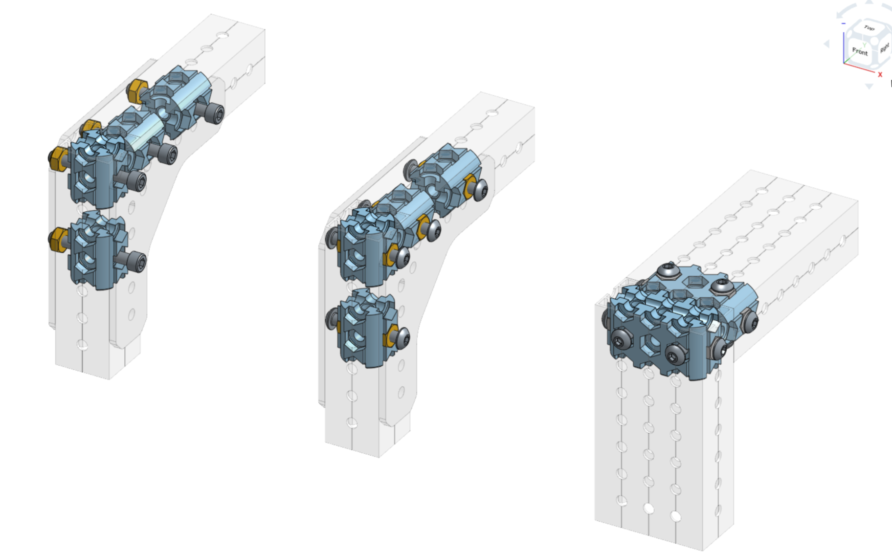

Application Examples:
Through bolted, using the nut retention for blind bolting, and using the clamping feature.
I’d recommend printing chamfer side up for good results. The parts are configured to encourage you to put the chamfer into the tube first so that you can take advantage of the clamping feature. The default inset (10 thou each edge) was what I found best for a reasonably tight fit without being difficult to insert.
