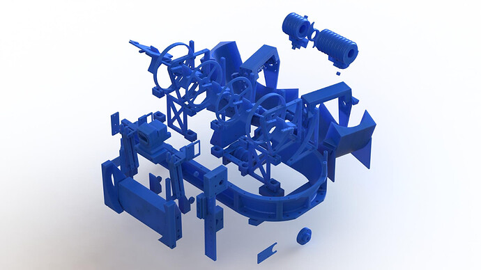

I also think this render of all of the printed parts on our robot in 2017.
We aren’t crazy over the top like the teams that Akash mentioned, but I think we integrated printing more effectively than a lot of teams

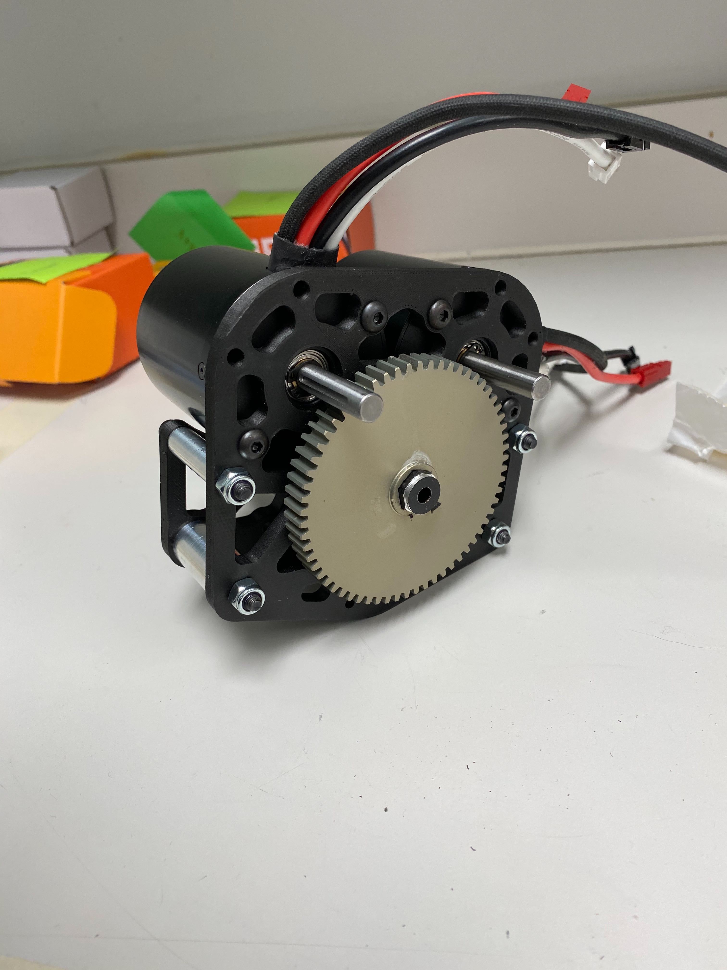

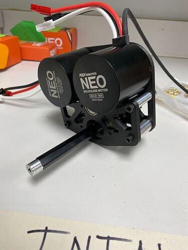

In their build blog, 6328 discussed 3d printing a gearbox plate. The quote is from this post: FRC 6328 Mechanical Advantage 2020-2021 Build Thread - #138 by davepowers
While we’re waiting on some metal to get cut for our gearbox plates we decided to print a few on our MarkForged out of Oynx with Fiberglass Inlay. We’re going to drop them into our practice robot frame and see how well they hold up this weekend. I think they came out pretty slick and feel very solid.
They also discuss how it held up in their build blog.
