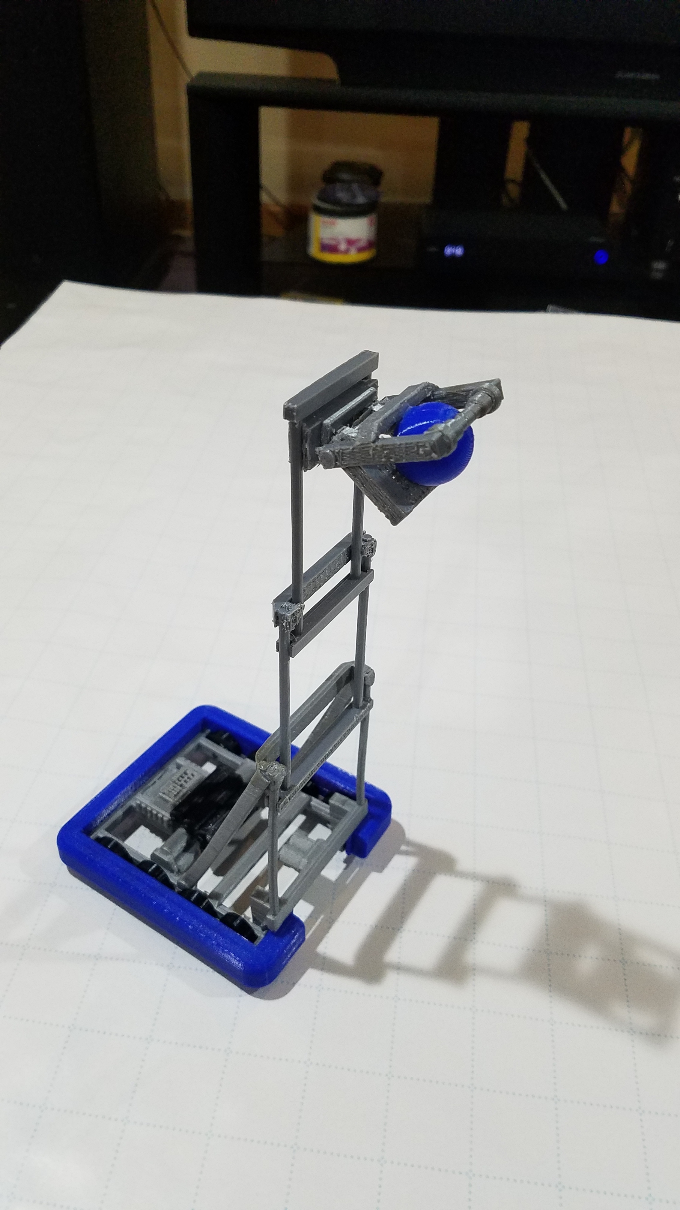

What scale is that from full-size? Do the lift parts actually slide within each other and move?

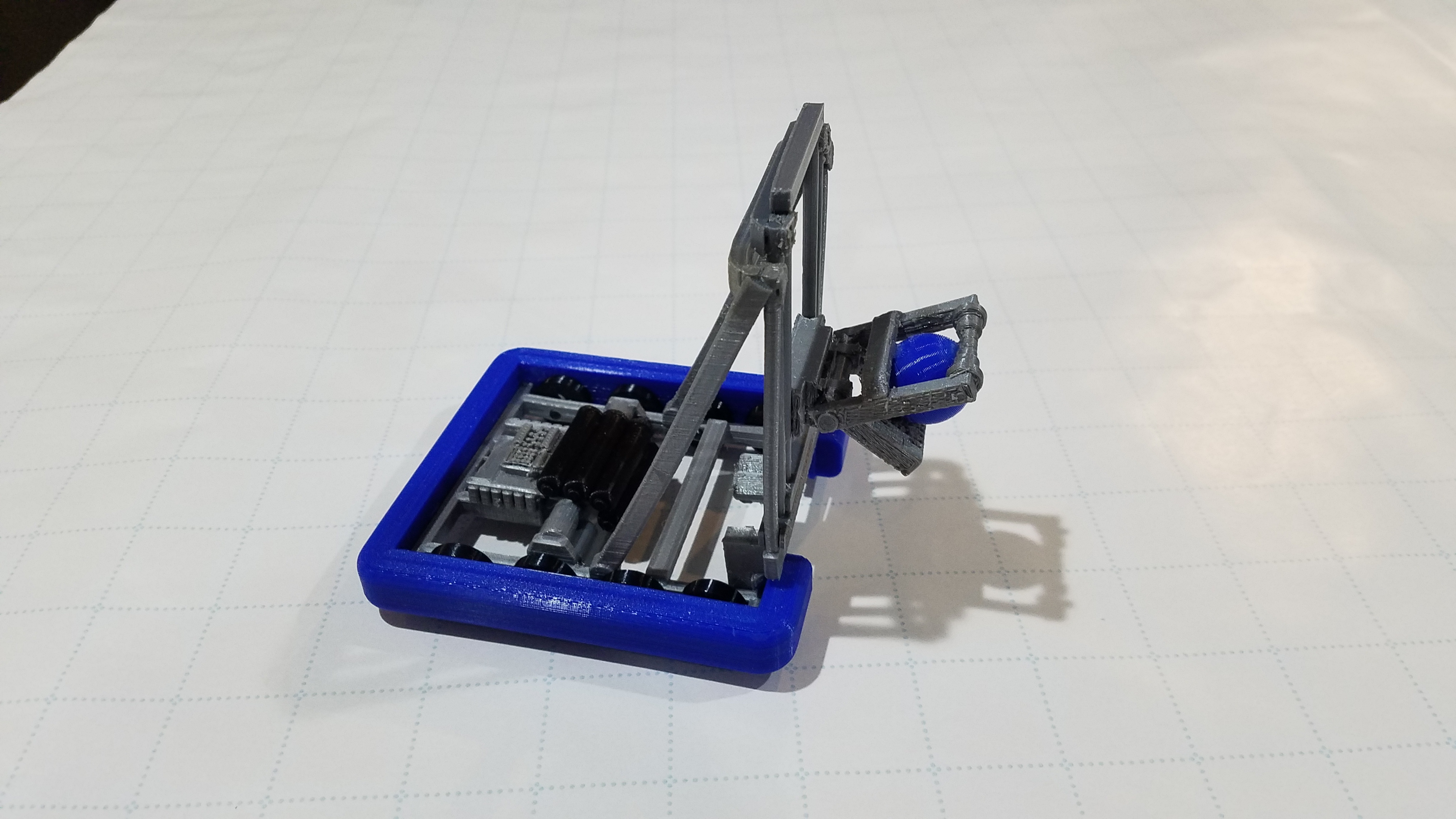

I printed a 20:1 model of our robot but made it all one solid part and printed two different configurations of it, full height/extended and low/retracted. I’d be interested in how much trial and error it took to have those thin lift parts actually slide within each other

I took the main cad files and reduced it to 10%. The files were still too large for my slicer program. So i took the physical measurements and designed it in Tinkercad. Believe it or not i got the elevator functional on the second design. The first design the elevator would fall out at the bottom. So i added little tabs to keep it in. This model has the drivebase and main elevator as one piece. I am currently seperating them so it’s easier to print and I’ll just glue it together. I rushed the design so we could take it to Detroit. I will be refining the design to make it better. I also had aproblem with the silver filament. It didn’t extrude very well. I’m going to try Hatchbox or 3d solutech
I have said this before in other threads, but 3d printing is an amazing tool for FRC. This year every single one of our 1/2in hex hubs on our drivetrain wheels were printed with basic Hatchbox PLA. While this may not sound like a good idea, it worked very well for us. We tried it first on our practice bot, and then after seeing how well it performed, we put them into production for our comp bot. These hubs survived driving off of hab 2 every single round with no hubs breaking during any of the matches. We were blown away and will be using them again in the future.
Oh really? you printed that in one piece and still got the elevator to move? Would you mind sending me the step files for that model? I want to see what tolerances you left while still printing it in one print.
Sure. The drive base and main elevator stage were one piece. 2nd and 3rd stage were printed separately and just snapped together along with the cargo grabber. When iget home from work I’ll get in touch with you to see what you need.
