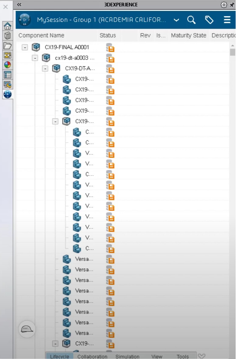

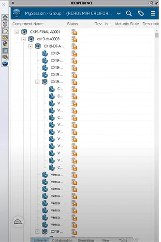

I made it this far in the tutorial video. The trouble is, I can’t get the side bar plugin in Solidworks to look like this:
All I’ve got is this (files are ones I added to 3DExperience Drive in WIndows Explorer).
I don’t see how to get my plugin to be like in the video.

I believe that you need the new version of solidworks, don’t quote me on that though. @OccamzRazor
You should use the latest version of SOLIDWORKS with the platform to use the service window shown below - but there is also a download you need to launch from the platform in your browser first and any time you want to connect to the cloud using PLM services (smaller image attached).
Thank you @OccamzRazor you are correct. You need the SOLIDWORKS AddIn App from the Compass in a browser.

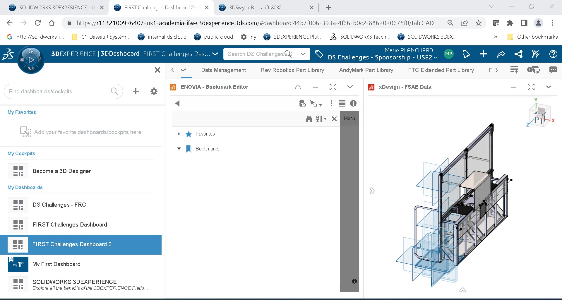

  1. From your invitation you open a web browser. Click the compass in the upper left - big blue circle.
  2. Create a Collaborative Space with the 3D Space Apps. Use 1 Collaborative Space for your team.
  3. Select the SOLIDWORKS Add in from below the compass - install the HotFix. This should connect to SOLIDOWORKS 2022-2023. But I strongly recommend you apply for sponsorship and get SOLIDWORKS 2023.
  4. We also have a new FIRST Dashboard now that has Bookmark Editor and xDesign your cloud CAD. The AndyMark and Rev Robotics and Lego Libraries are tabs across the top.

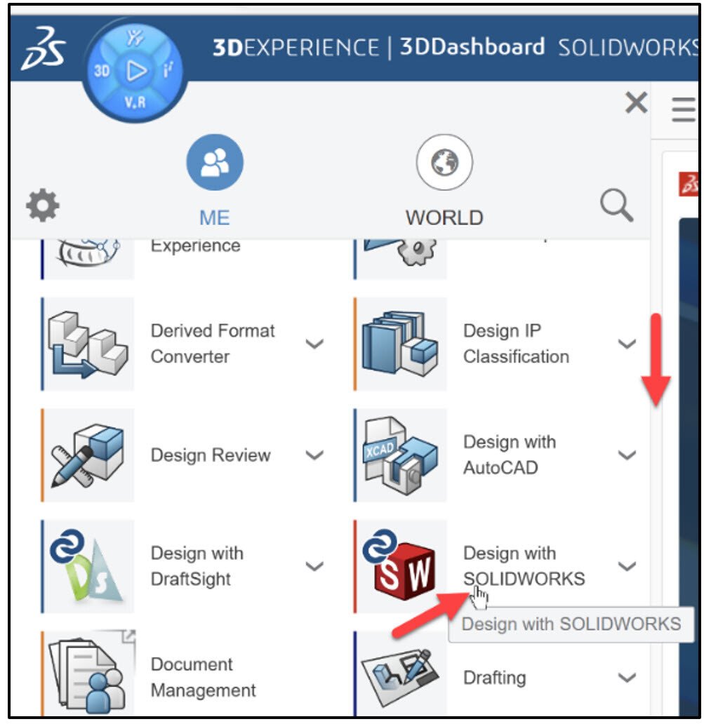

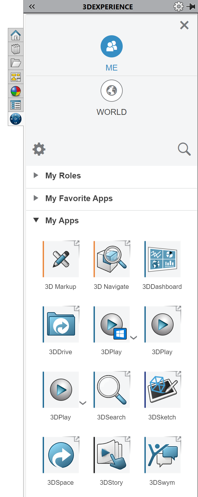

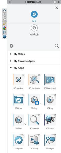

I tried following Lesson 1. Again, I didn’t get too far. I do not have the “Design with SOLIDWORKS” “app” in My Apps.
This is what I need (I think)
This is what I have
Is the “SOLIDWORKS Add-in” the same thing as the “Design with Solidworks” App and it got a new name? Or are these two different things and I don’t have the right thing?

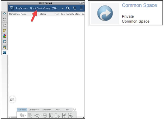

However, in Solidworks 2022-2023, my 3DExerience panel looks nothing like the tutorial.
This is what I have:
This is what I need:
It’s like my version of the hotfix is completely different or something. Is this 3DExperience Add-In something that just flat out does not work in Solidworks 2022-2023 and it’s mandatory to install SolidWorks 2023-2024? Or am I doing something wrong?

  1. yes Design with SOLIDWORKS and the SOLIDWORKS app are the same.
  2. I sent you the code for 2023 SOLIDWORKS for you and your FIRST team. Uninstall 2022. Install 2023 and then exit - reboot.
  3. Create a Collaborative Space from your browser window (not inside of SOLIDWORKS). Select 3DSpace App.
  4. Click SOLIDWORKS App from your browser window. This launches SOLIDWORKS desktop and the 3DEXPERIENCE Add Inn,
Please remove any SOLIDWORKS 2022 or earlier and then install the new sponsorship of SOLIDWORKS 2023 desktop! Very important. For more technical support and questions go to go.3ds.com/studentcommunity and post your questions.
Thank you for the help Marie. This was my issue. 3DExperience seems to function as intended with SolidWorks 2023-2024, but not with 2022-2023. I really appreciate your patience and support in helping to get me going on this.
