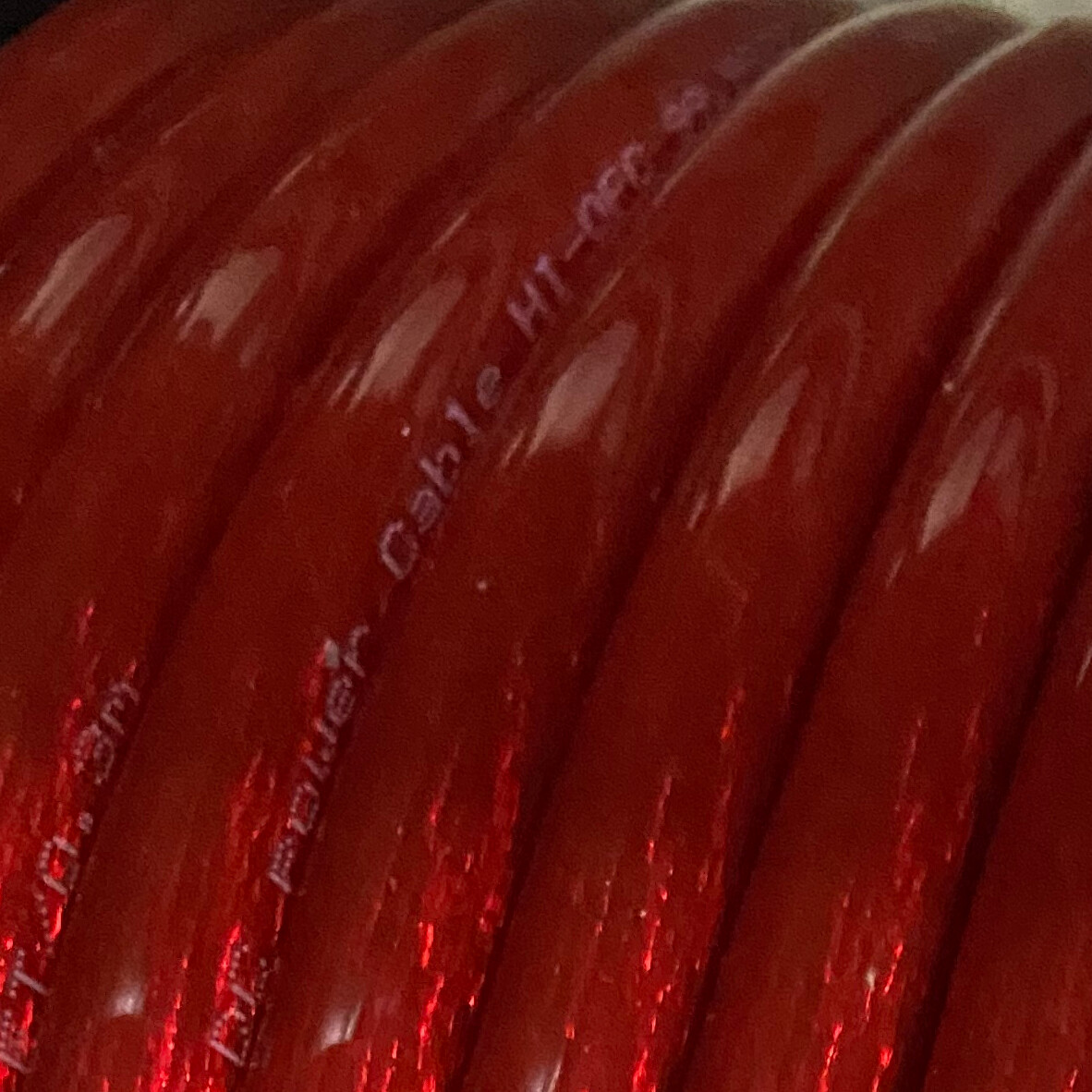

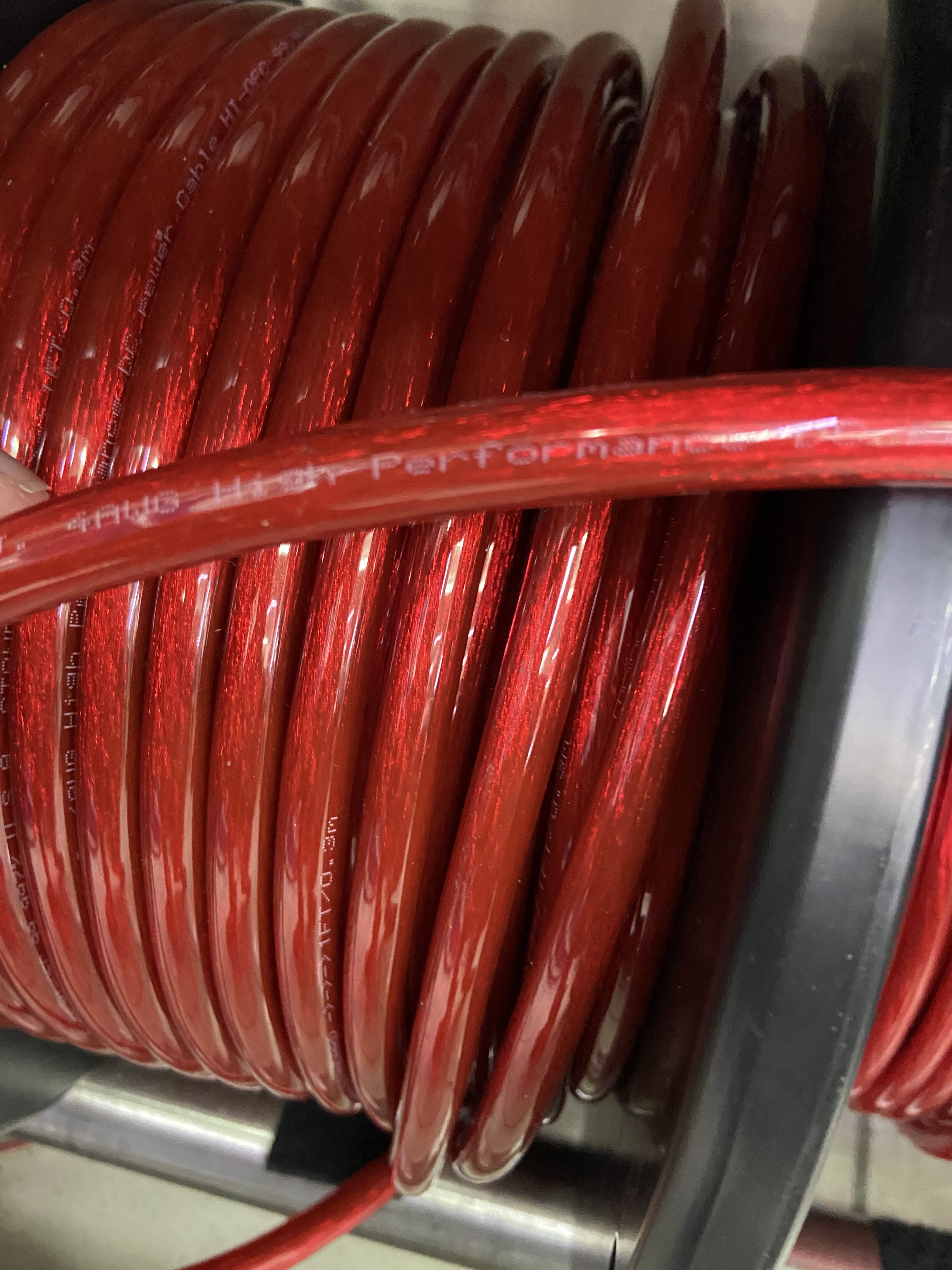

Are 4awg clear red power wires allowed on the robot?
4AWG is perfectly fine, but I think you’ll need to clarify what you mean by “clear red”. Can we see a picture? I don’t think translucent insulation is banned, but it definitely needs to be identifiable as “red” (or another legal wire color for positive wires).

EDIT: Given the above picture, and past experience as an inspector, 99% legal without any hassle, 1% chance that an inspector gives you a hard time but is overruled by a LRI. I’d call it legal, it’s clearly red and clearly marked as 4AWG.

OK, to answer the first question, yes, the clear red insulation does meet the rule. Tinned copper wire also meets the rule but may not be obvious to some inspectors who have no electrical background. Ask to have your LRI rule on it if there is a question. If the LRI does not have an answer, they will call me or Chuck for a ruling.
Copper clad or copper plated aluminum is not legal under the rules listed above.

To settle if this cable is CCA or not: Looking closely at the picture, you can see it says “HI-OFC” on the side:
OFC stands for Oxygen-Free Copper and the HI appears to just mean “high-fidelity”. This wire appears to be legal.
