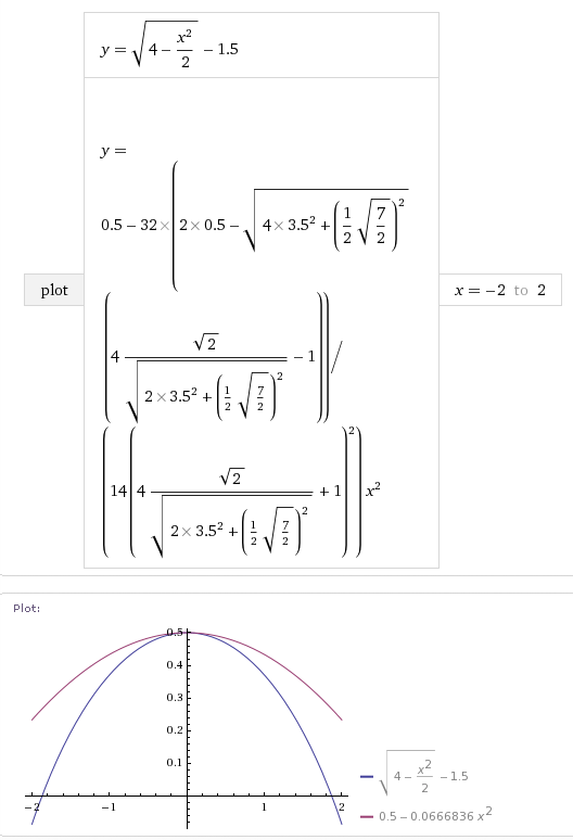

Your parabola plot is correct.
The equation simplifies to y= 0.5-0.066683598*x^2
The roots are not supposed to be +/-sqrt(7/2). Why do you think they should be?
If you want the radius to go to zero, you need a longer roller.
I found the problem: the ellipse you plotted was not correct.
The ellipse you plotted was y=sqrt(4-x^2/2)-1.5 (see attachment 1).

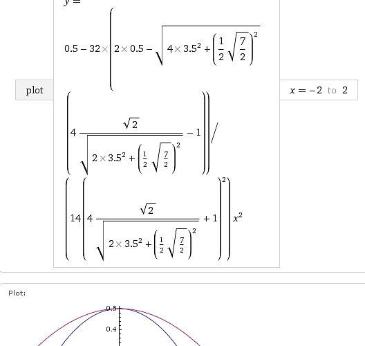

The ellipse should be (sqrt(64-2x^2)-7)/2 (see equations #1 and #4 of attachment 2).

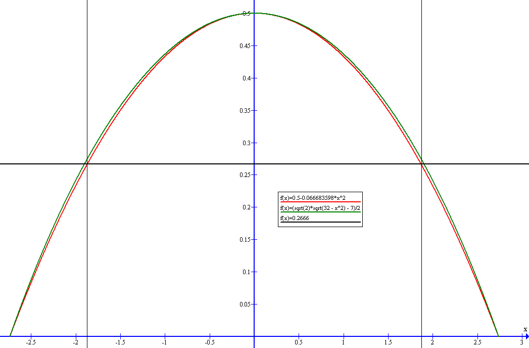

The ellipse in attachment 2 is plotted in attachment 3. It is a close (but not exact) fit for the parabola you plotted.
If your rollers are indeed contoured per the ellipse in attachment 1, then they are quite a bit off.

From eq.#1, it looks like you used the diameter of the mecanum wheel as the radius instead of the radius. The equation for the ellipse without translation should be y^2/4 + x^2/8 = 1. The second ellipse needs to be translated up 3 units in order to give the roller a diameter of 1 in the middle, so the second equation is (y-3)^2/4 + x^2/8 = 1. Solving for y, you should get 3/2, and plugging that back into the first equation gives roots of x as +/- sqrt(7/2).
I did a quick check on the wheel I CADed, and the rollers do indeed follow these ellipses (and have the correct side profile on the wheel itself).
Heh, just checked back on the parabola equation, seems I made a small error in setting the radius of the wheel R equal to 4" instead of 2"! That would do it. Here is the fixed parabolic equation with the ellipse above. Sorry about the confusion.
I used the radius that you gave me:
Heh, just checked back on the parabola equation, seems I made a small error in setting the radius of the wheel R equal to 4" instead of 2"! That would do it. Sorry about the confusion.
Not to worry. The difference between the ellipse and parabola is probably negligible for these size rollers anyway.
I did the analysis mostly to satisfy my own curiousity. However, for larger rollers requiring expensive tooling to be commercially produced, it might be worth using the parabola instead of the ellipse.
