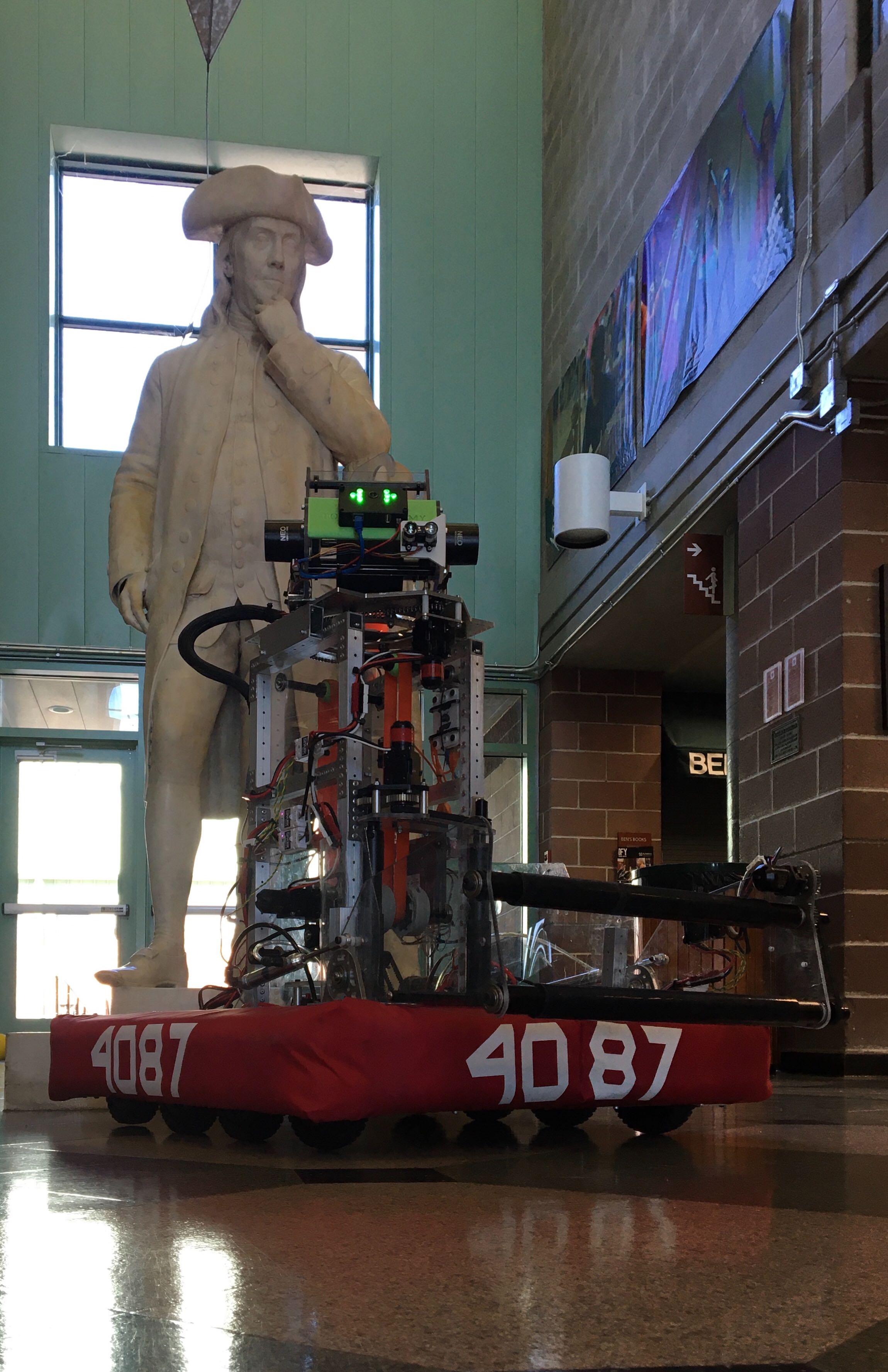

I’m proud to present the current state of FRC 4087’s machine for Infinite Recharge - Aluminium Falcon. This is by far the most complex robot we’ve ever built and represents a lot of firsts for our team including our first custom chassis, first flywheel shooter, and first turret. None of this would have been possible without our new Omio X8, a wonderful vendor ecosystem, and our incredibly generous sponsors.
Some subsystem details:
Chassis
8WD WCD
6" pneumatic tires
2-speed ball shifters, 4 NEOs
Blaster
Superstructure
Modular - attaches to chassis with 8 bolts
Wiring harnesses allow for quick removal and mechanism iteration
Blaster
4" 60A WCP flywheel
2 NEOs @ 1:1
Fixed hood
GreyT Turret
Limelight and LIDAR
Loading Bay
3 NEO 550s
1.25 Aluminum tubing with surgical tubing
1’’ urethane flat belting
Docking Port
1 NEO 550
Everybot-inspired linear elevator
Custom gearbox with integrated pneumatic friction brake (allows for retry of missed grab)
No falcons on falcons robot???
The irony is not lost on me :laughing:
We invested heavily in the Rev ecosystem during the off-season and chose to delay a foray into yet another new system, especially in its debut.
