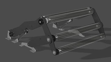

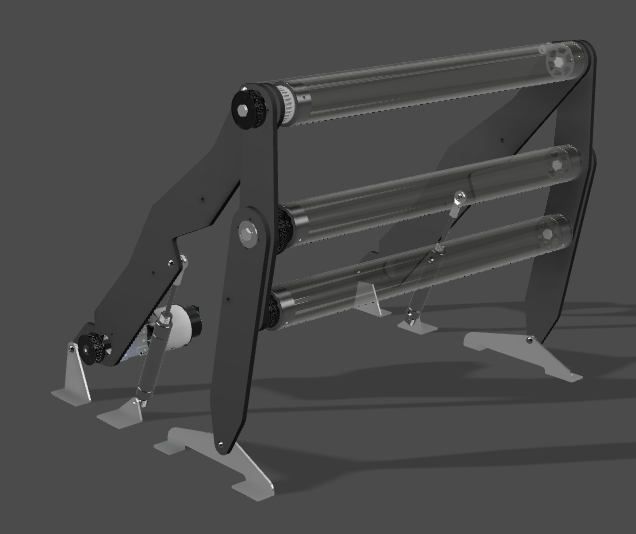

We learned in the 2020 season some of the difficulties associated with fitting a full-width intake on a swerve drive, especially with limited drive tube space. This year we explored a four-bar design, allowing the intake to retract over the front modules and prevent balls from coming out the front of the robot. We have three powered 2” rollers and a smaller passive 0.625” roller above the top roller to block balls from being ejected out of the robot by the intake. The intake is powered by a Falcon 500 with a 5:1 Versa-Planetary gearbox with the bottom roller having an additional 1.5:1 pulley ratio to help pick up balls from the floor before being run over by the robot.

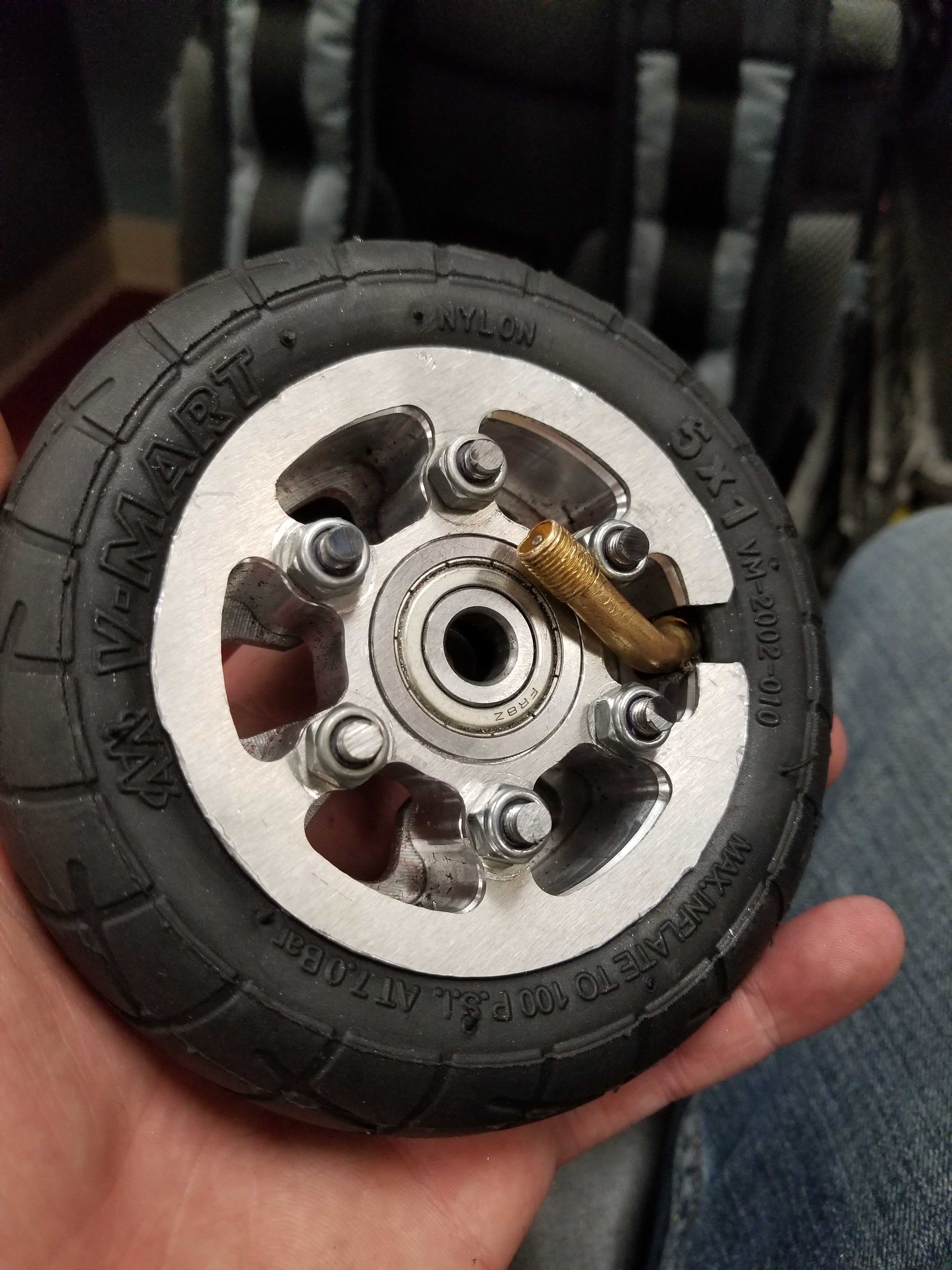

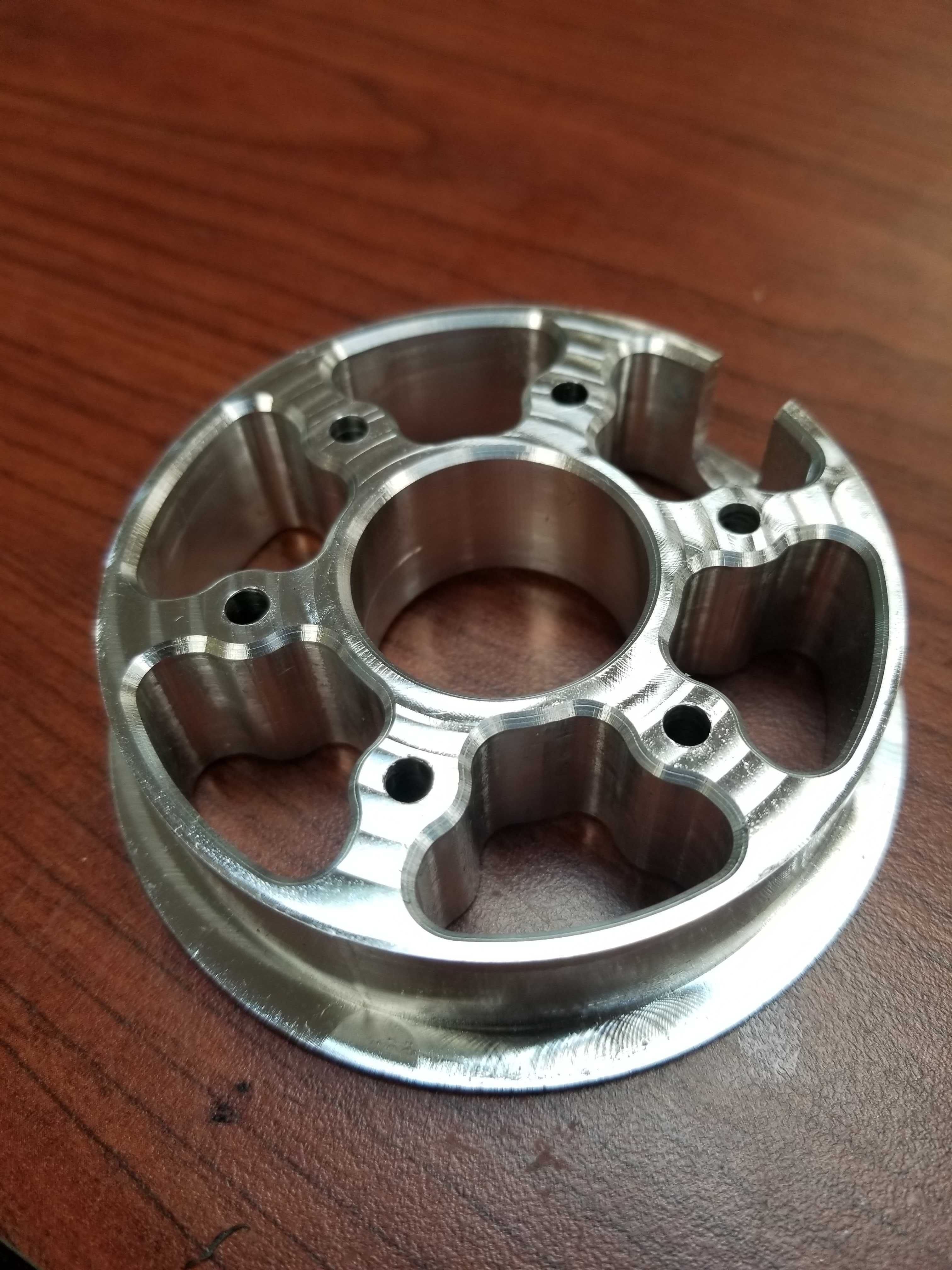

Any pictures or additional info on the custom 5” wheels?
Of course. The wheel is machined in two parts, one being this part, which the wheel can be slid into.
Then the second part, a plate, is bolted to the primary hub to keep the wheel fully captured.
*This is an older version, instead of bolting all the way through the wheels, we now tap the bolt holes and have bolts on both sides of the bevel gear and the plate. We also now machine a slot for the valve stem to sit in so it doesn’t hit the wheel mounts.

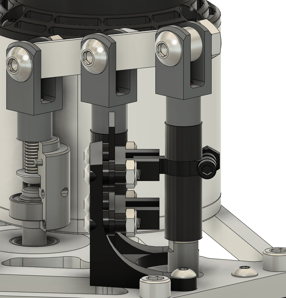

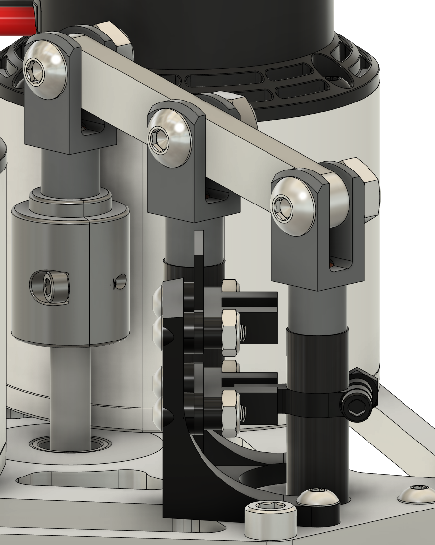

Im really curious on how the shifting mechanism works. (how it runs and everything), is it one before the contact bearing?
Do y’all plan on putting out the cad?
The shifting mechanism is a simple lever linkage with a pivot in the center:
Low Gear:
High Gear:
We are using these plastic clevis joints for the pivots. The linkage bar is manufactured and the photo interrupter stack and flag are 3d printed.
As far as putting out CAD we are not sure if we will be making another iteration on the design during the offseason implementing some of the things we have learned from actually assembling and running the modules for the first time on the robot. Either way CAD will certainly be up before the 2022 season begins.

The pivot bar is slotted on the side of the piston but is just a simple hole on the side of the shifter rod. This is because the shifter rod has a lot of wiggle inside of the shifter shaft, so when we slotted it the shifting became inconsistent as the joint would just slide back and forth in the slot due to in not being constrained concentrically to the shifter shaft. The hole instead of the slot at least makes the action consistent although technically we are pulling the shifter rod slightly out of concentricity. Hopefully that makes sense.
