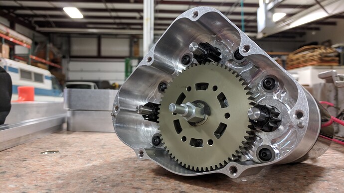

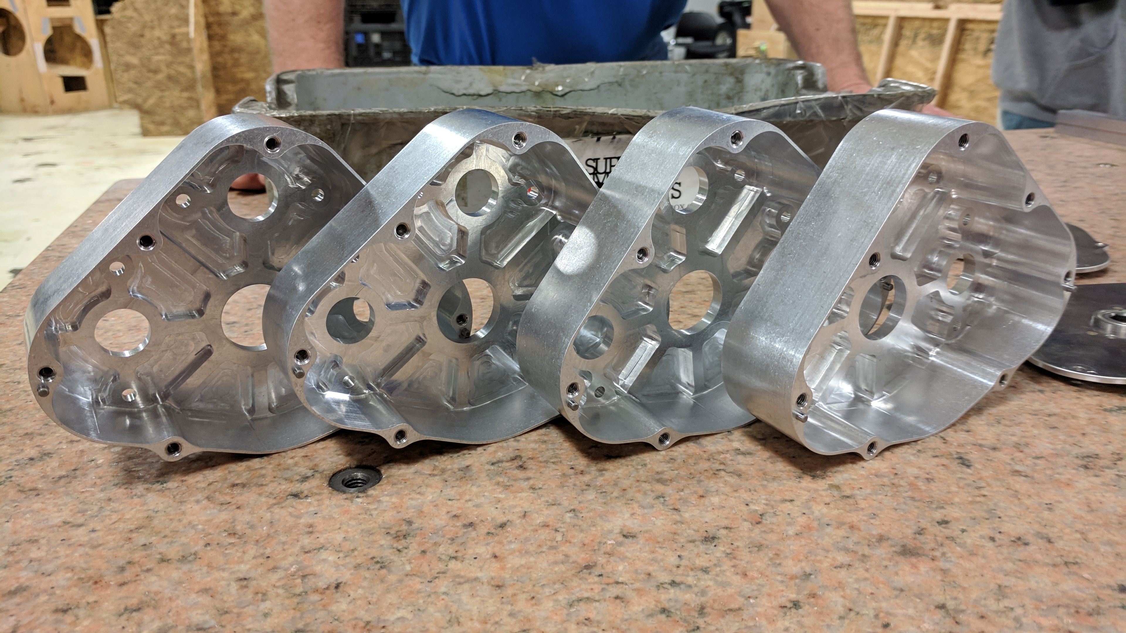

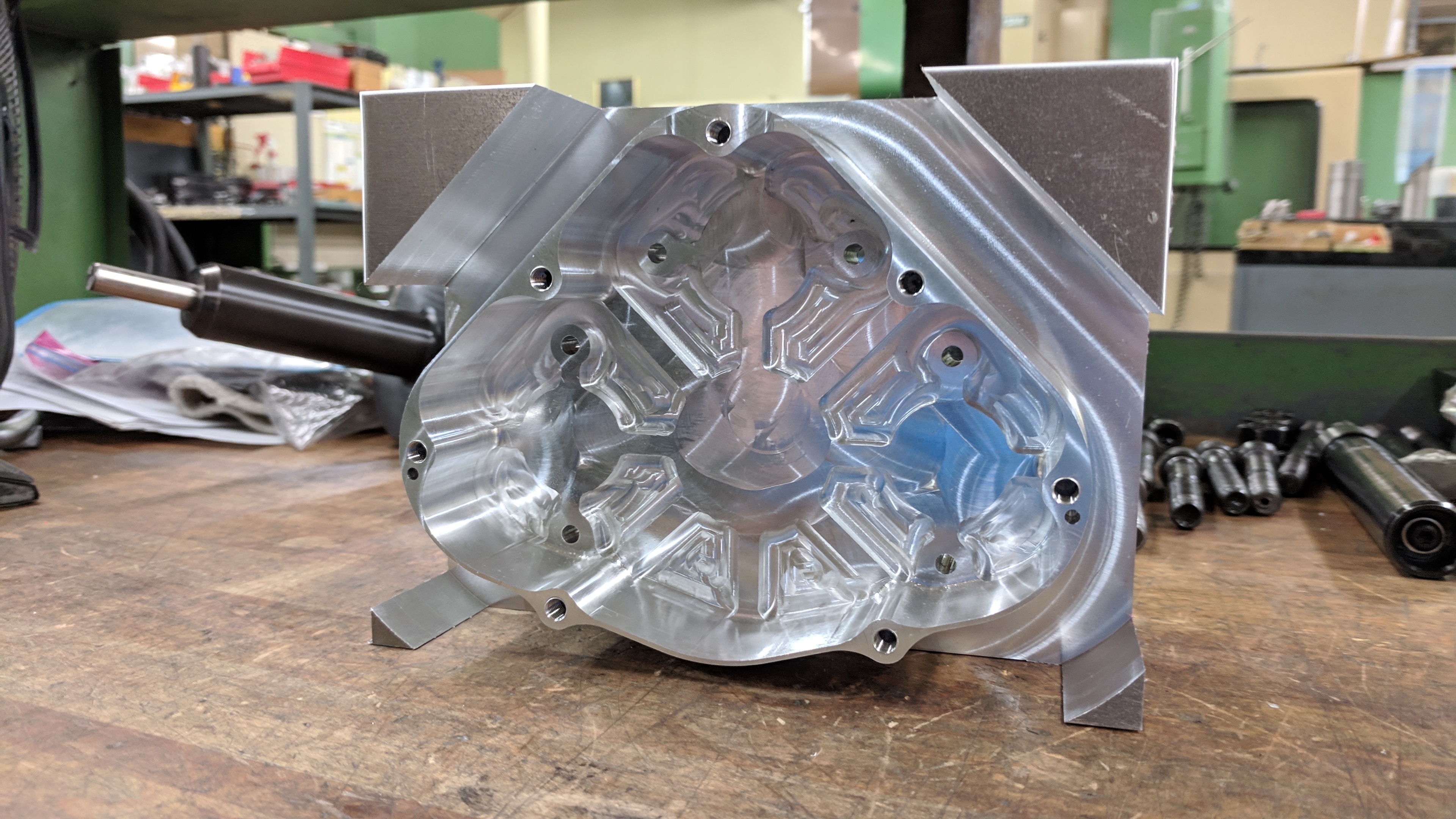

My team just finished machining our 2019 gearboxes, so I thought I would share a few pictures. It is a three Mini CIM drive and has an adjusted top speed of 13.76 ft/s.
Those look awesome, great work! Did you sand the outer parts off, or did you face it off from one side?
I hope this answers your question, but we ran an end mill across the opposite side to remove all excess material.

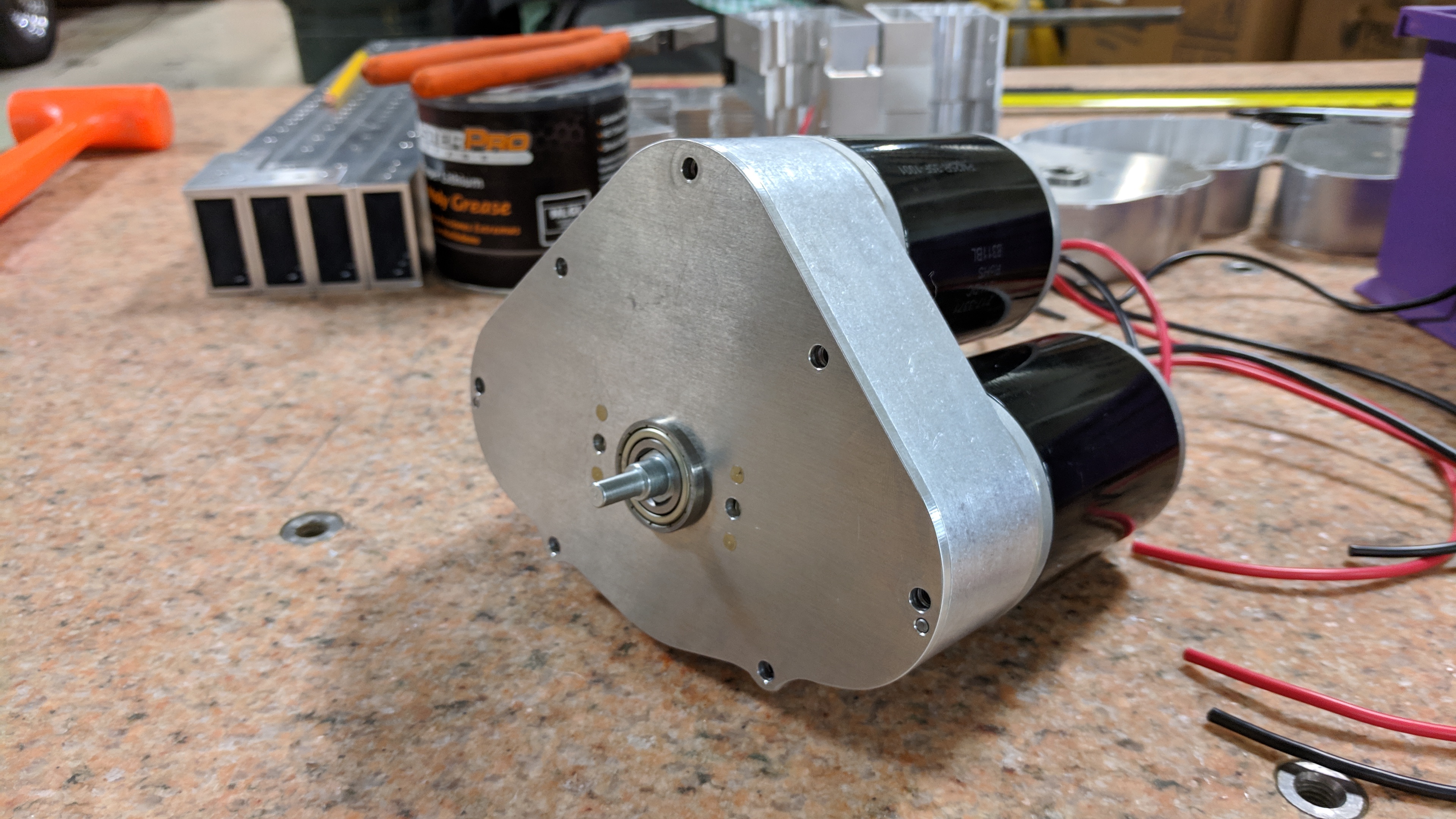

How much is the total weight per gearbox?
I have not weighed it yet. Solidworks says it weighs 7.5 pounds with motors and the main aluminum housing weighs .5 pounds.
Interesting. Why’d you chose to go billet over something simplier like a parallel plate gearbox?
How are the 10t pinions treating you? I’m wary of increased wear, but they’re mighty convenient for making existing gearbox designs more flexible.
We designed them that way for stiffness, to protect the gears, safety, and so that we can apply lots of grease.
I don’t know yet. They were very loud when we spun them up so I am thankful that we can drop in 12 tooth pinions if needed. My only concern with that is higher current draw and slower acceleration.
This seems unnecessary
Nice design. Definitely looks “over-engineered” but you can never be over-engineered for gear protection. How easy are they to take off if you need to replace a gear?
