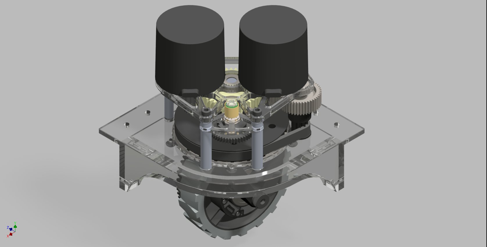

Hi all,
The team was busy this summer and preseason working on our swerve drive. We ended up making some modifications to the 2910 MK2 swerve modules and 3D printed a majority of the module. Everything was printed in PLA on a Prusa MK3. Big credit to 2910’s design that even 3D printed they held up great and allowed us to do some serious software development with them.
Here is a link to the CAD:
Grabcad Link
One significant change is that we 3D printed the main central pulley. It’s a difficult part to machine and we felt a 3D printed version would hold up for our testing. For the main pulley, we changed a few pieces of it in the CAD, but then we took the STL and used a different tool to add back the extra pulley teeth and regenerated an STL to print. You can find that on our thingiverse account (link here).

I certainly like the idea, and you executed it very well. The beefed-up base plate looks great! Did the motor plate still hold up despite the lightening features?
A possible place to take advantage of the capabilities of a printer would be to integrate the motor and encoder plate as one part, and hopefully reduce part count on that front.

Very cool, and a neat idea for testing! If you use swerve this season, do you plan on getting a milled pulley?

Thank you! The base plate modification eliminated a ton of the flex. We put bolts through the horizontal holes to give it rigidity.
The upper plate ended up being made with poly since we had time to make those before we had to leave the school for the summer construction work. If we were to 3D print them we would likely remove the lightening.
We’ve considered it, but feel that depending on the challenge a 3D printed central pulley would work just fine for a real season. There’s enough contact across the pulley that the loads are well distributed. Would we drive this off level 2 in 2019? With a metal base plate, maybe. But for a flat field game we would definitely stay with a 3D printed central pulley.
