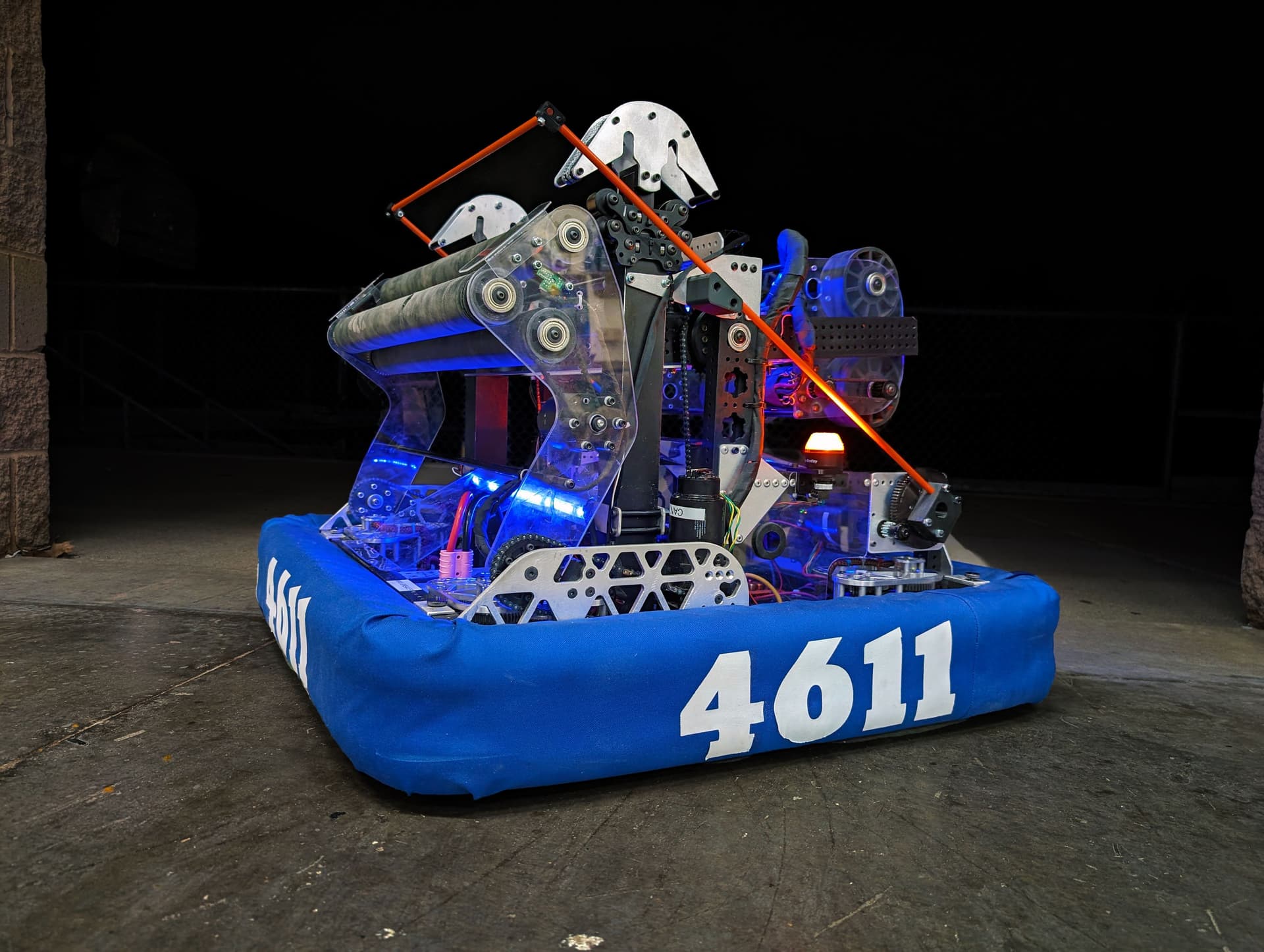

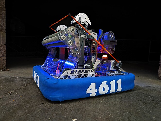

4611 OZone Robotics - 2024 Robot
OZone Robotics is proud to present our 2024 robot.
We will be competing at Week 1 Greater Pittsburgh & Week 6 Miami Valley.
Thank you to all of our generous sponsors, parents, students and mentors.
Feel free to ask any questions about our robot.

A lot has happened since my last post after week 1 with some slight mechanical changes and a lot of software development. Apologies for the long post.
  • Before going into week 6 Miami Valley Regional we changed our shooter wheel configuration. We realized from slomo videos during debugging that we weren’t getting much contact with the note on the right side of the shooter wheels due to how the note deformed. We quickly changed to move the right 2 sets of wheels inward 1in and were able to get more consistent shots. With this we were able to shoot from farther away with more confidence.
  • We also changed over to Kraken drive with FOC (from falcons) on our SDS MK4i L2 modules with the 16T pionions. This gave us a noticeable difference in speed as we knew center line auton face offs were going to be more common
  • OZone ranked 5th at MVR and were the first pick by the first alliance 5667 The Digital Eagles and selected 3193 Falco Tech to round out the alliance. We ended up being finalist overall and were awarded the Industrial Design Award again!
  • Between Week 6 and champ we knew we struggled with our amp deflector bar. We add some additional stiffness to the deflector by adding another set of fiberglass rods. This made our amp shot more consistent and gave our drivers the confidence to do more amp shots since we struggled with it at MVR.
  • For our intake we moved away from the SHARP IR distance sensor and replaced it with a Banner retroreflective sensor. The SHARP sensor died during MVR and we could never get the replacement one to work as intended. With the new Banner sensor, it was a simple on or off decision in code. We paired that with current sensing to rule out any false positives we saw with the old sensor or noise.
  • We developed 4 new autons to help with center line rush. Both our amp side and source side auto had the preloaded note on our bumper so we could drive away as soon as auto started and drop it in a known spot to pick up later. Both of these autos were highly compatible with our alliances as we knew that would be critical for higher level play. We also created a center subwoofer auton that navigated around the spike notes to the center line middle note if we needed to run that. You will notice that some of the paths are longer than 15s, this is built in logic to skip to the next path if a note is missing from pickup. You can see all our champ auto paths on my YouTube https://www.youtube.com/@melchiorvester
    We ended up running our source side auto 14 of 15 matches mostly from a compatibility stand point and we never lost a race to the center for our first note
  • OZone ranked 8th in Johnson division and were captains of the 7th alliance with 1787 The Flying Circuits, 4766 Team SCREAM Jr., and 325 Respawn Robotics. We finished out as finalist and had an incredible run. OZone was awarded Industrial Design Award for the third time giving us 3 for 3!
Overall this was a huge development year for OZone with our accomplishments. We ranked 3rd in the state of Ohio, brought home 6 trophies, and won our team’s second blue banner. We will be competing in some off season events so feel free to stop by and ask us any questions!
