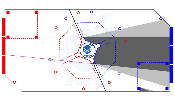

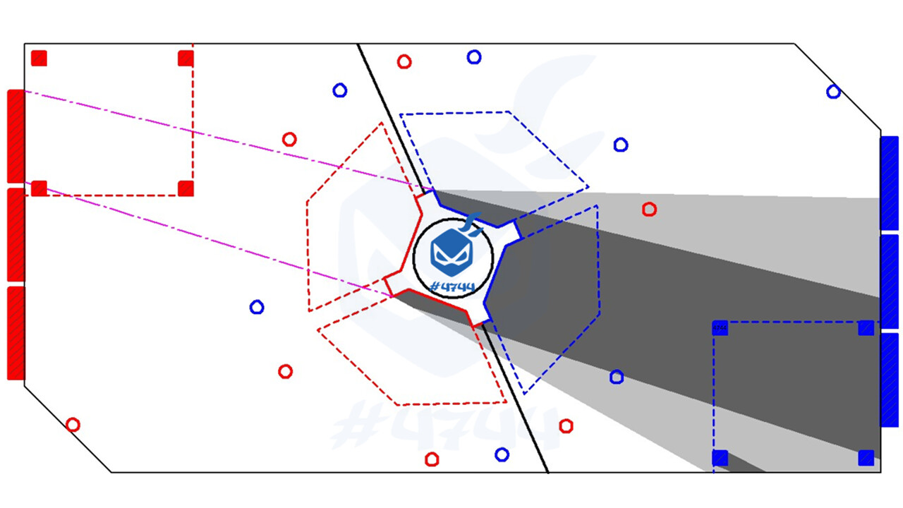

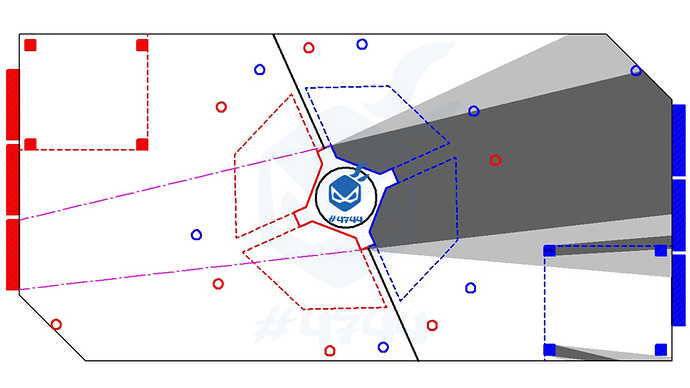

  • Delivety-bot: as previously claimed, the game element can be thought of as a resource. a robot with a good intake and outake but not very good shooting abilities can help its alliance by making the balls more accessible to its alliance member, rather than trying to score it itself. In advance, there are optic dead-zones for every close-by team station in the alliance wall. The third station has a complementary field of view for those exact dead-zones, meaning a 2nd pick robot can make the balls accessible for the more offensive alliance captain and 1st pick. This strategy can’t win a match on its own, but can help even a medium-shooter alliance member to score more points.
  • Snatcher-Hider: This strategy is the exact opposite to its prior. If the goal of a delivery-bot is to make balls more accessible to its alliance members, this strategy’s goal is to make balls less accessible to its opponents. The snatcher part makes it harder by increasing the demand for the same type of balls as the opposite alliance (therefore increasing the price of point scoring), and the hider part makes it harder by decreasing the supply of those balls by hiding them. Hiding spots can be found in the exact same places of the other alliance optical dead-zones: on the robot itself, near the truss legs, near the hub fenders and out of the field via the terminal. Once again, this strategy can’t win a match on its own, but can help in creating a point difference between the alliances. Here is a video of us testing out this strategy, you can notice that from the moment of placing, those balls haven’t got picked up by the opponents.
Drawings of the optical field of view and dead-zones can be found at the end of the post.

Also, full drawings of the optical fields of view and dead-zones are available down below for anyone to use, just keep the team’s logo for credit for the work.
Good luck for all teams, both the still competing teams and the next season competing teams :slight_smile:
**Optical analysis of fields of view and dead-zones, created by #frc4744 **

Balls right against the driver’s station wall are also invisible…
A really skilled human player can indicate where balls are, assuming anyone is actually paying attention :wink:
You are right.
We didn’t add this to the list (and also the dead-zones created by the opposite hangar) because it may decrease the cycle time for the opponent alliance, rather than increase it, having the opposite effect.
Your alliance wall is also quite of a dead-zone (mostly from the middle station to the left towards the hanger).
The human players, cameras and auto-ball-targeting make it harder for the strategy, but from our drive team experience - even when you have cameras and a human player who can signal, it is still hard to drive the robot correctly.
