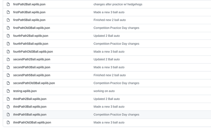

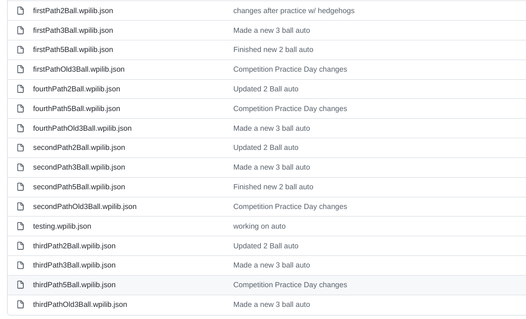

I know, but l find that @Strategic uses PathWeaver and he also uses swerve. And l notice that he has written two paths. l think if they are useless, why he still keep them in his code?

Next year we might use PathPlanner, but PathWeaver actually works pretty well for swerve if you’re willing to deal with it e.g. using reverse spline for when your robot is going backwards, or drawing the trajectories a little different than normal. PathWeaver works with swerve because of the WPILib class SwerveControllerCommand. All of the code for following trajectories is in FollowTrajectory.java. FollowTrajectory is just a wrapper command for SwerveControllerCommand that gets the specified trajectory’s json file from the argument trajectoryFilePath and resets the odometry of the swerve if toReset is true. When it is called with a path, it drives that path for the specified amount of time. The code is a little hacked together and I would want to handle how the command ends a little better next year (we do .withTimeout when calling the FollowTrajectoryCommand), but overall I’m really proud of our auto.
When you say we have 2 written paths, if you’re talking about the Auto folder in the PathWeaver folder, those are just so that we can share our PathWeaver configuration files over github, they’re not important. All of our paths’ json files are in src/main/deploy/output/.
