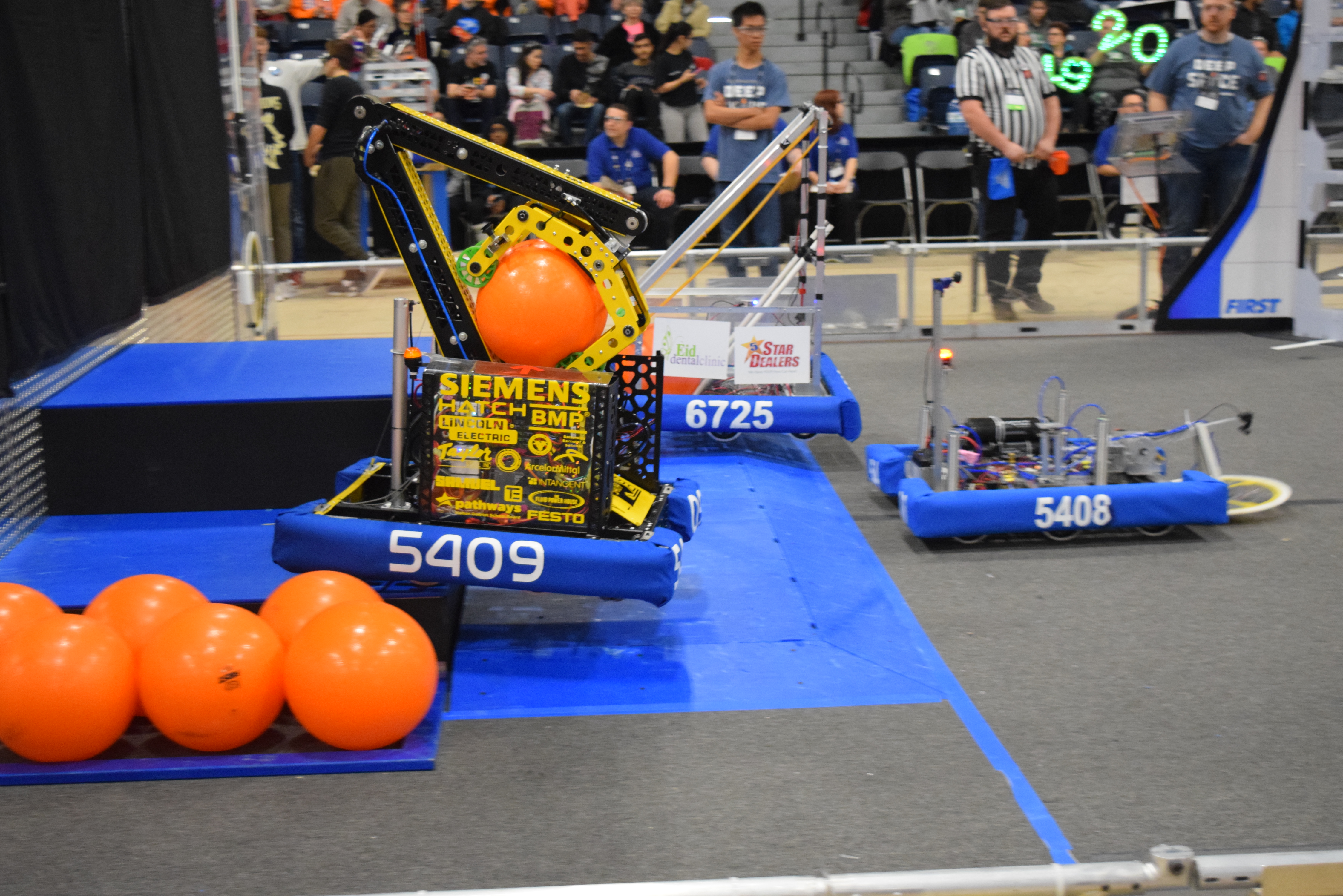

Hey all,
I’ve been a member of 5409 for 2 years now, and this year was by far our best. We’ve qualified for ONT DCMP for the first time in our team’s history, the farthest we’ve gone as a team in our history. (Never been to worlds or any event farther than regionals before).
We won the Quality award at Durham College and the Imagery award for the Technology Division at ONT DCMP.
While I love to show off our robot, I also want your thoughts and opinions on it.

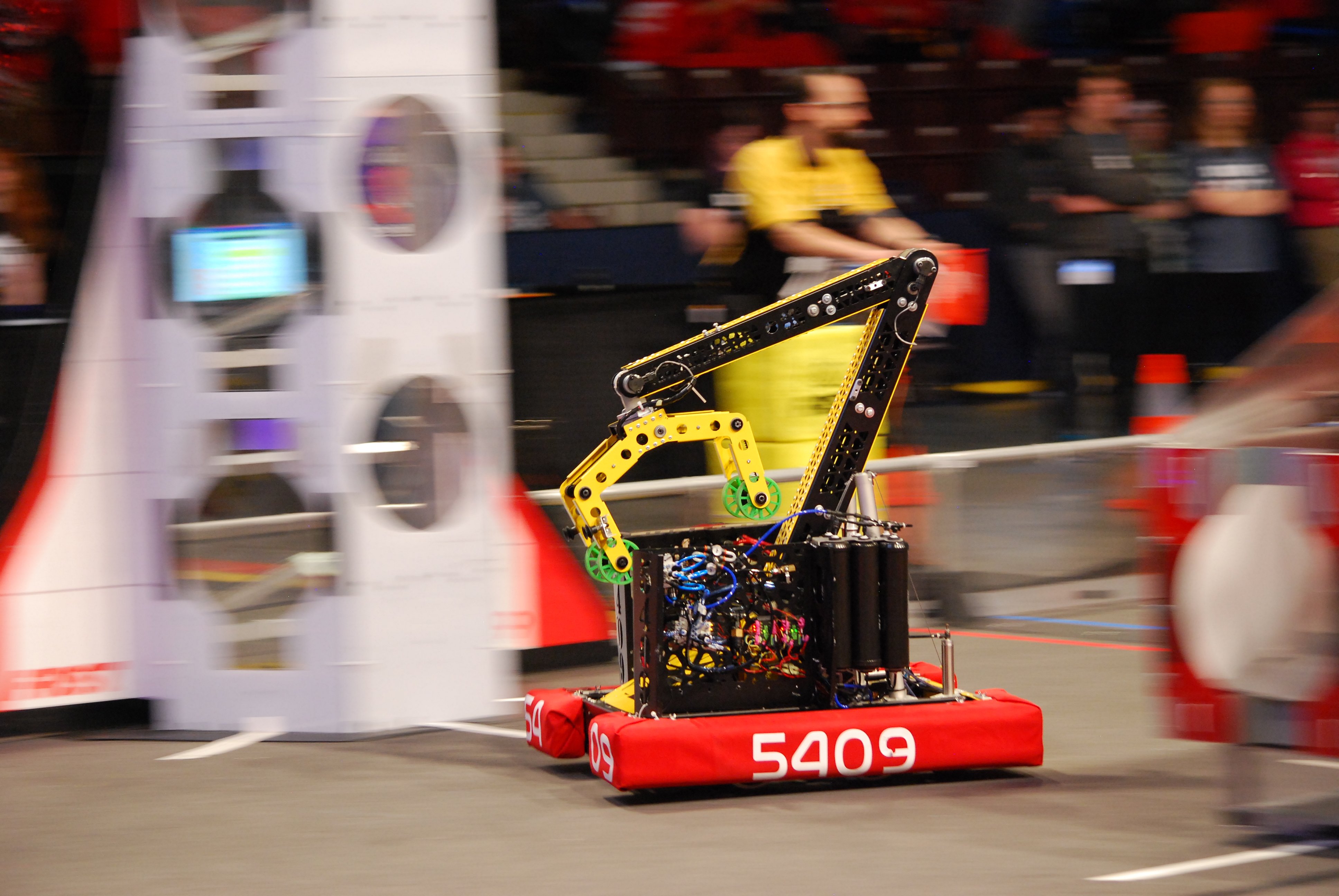

Specs:
4 wheel dual-speed tank drive, 2 CIM’s per side
Magnetic PID’s to control the Arm
2 Neo’s powering the Shoulder joint
775 pros powering the Elbow and Wrist joint
Microsoft Life Camera for Vision
Capabilities:
Cargo placement everywhere
Hatch placement everywhere (Added in offseason)
HAB 2/3 Climb
I would absolutely love to hear what you think about our design choices and your thoughts on our robot as a whole.
Thank you!

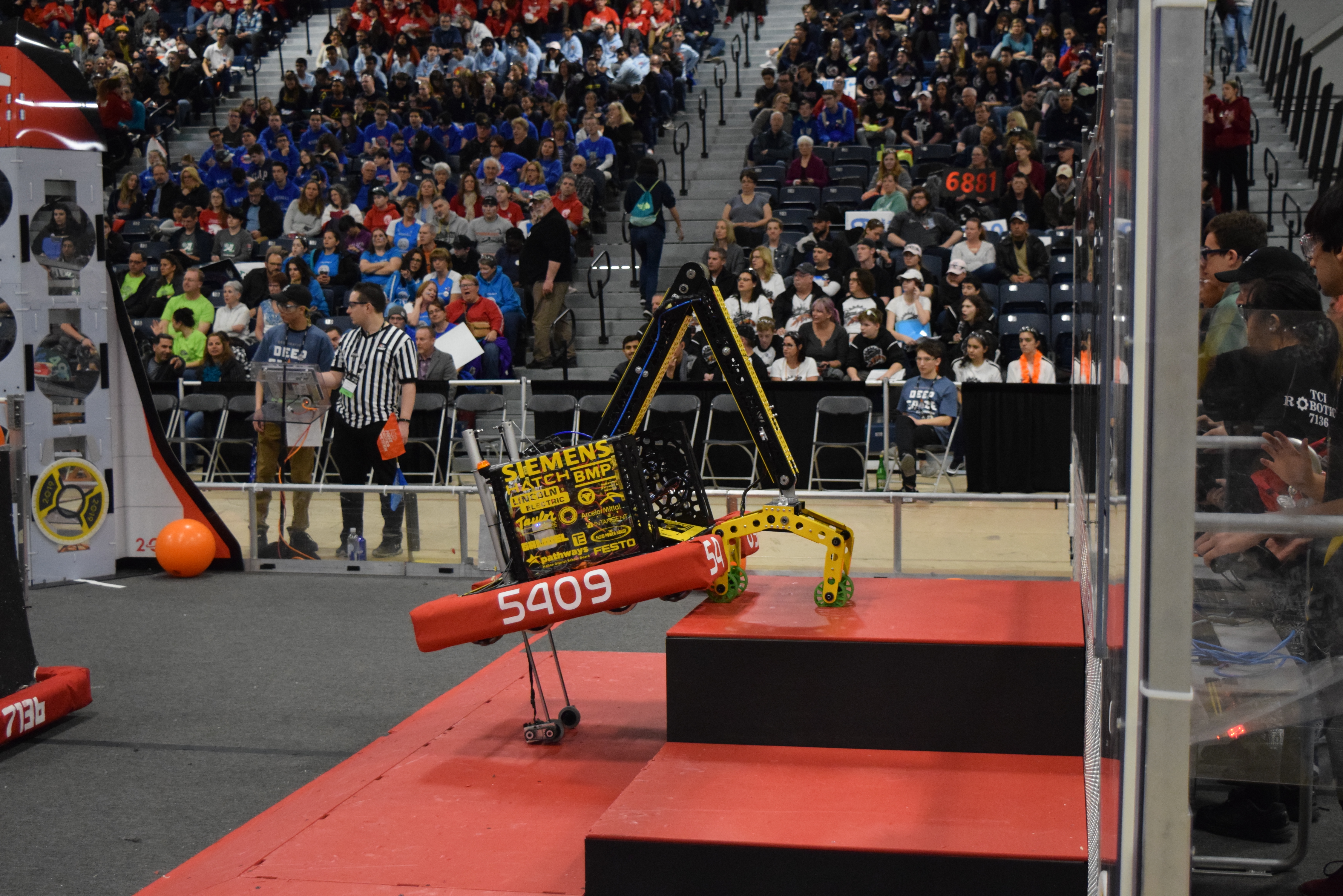

I LOVE that third photo!

The bot looks terrific and the photos are awesome. I watched 5409 with interest this year as the design looks good and also well built. Watching your earlier matches in Windsor, I noticed that the bot didn’t have smooth motions. This can make it really hard to drive and acquire objects. This looked markedly improved by DCMP.
The other suggestion I would make is that for ball intake the device should be wider than it is, maybe a single roller about 8-12 inches wide with another bar below, 2056 is a good example of a really simple single roller intake that just works. Even 3-4 seconds hunting trying to ingest a ball is too much, it means losing a full cycle over elite level bots for every 3 or less that you perform.
I’d have to review anything else about hatch mechanisms as I don’t recall how yours worked.
Overall I think the 5409 bot was really well done this year and looking forward to seeing next years!

  • I’m not a huge fan of the use of bevel gears in the arm joints.
  • I’d maybe try and stiffen up your climber if you have the room and weight.
