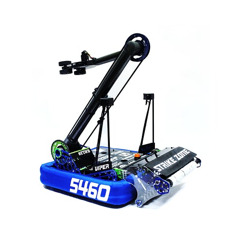

We are proud to present our robot for the 2023 season: VIPER
Robot Details:
Drivetrain
  • 26" x 26"
  • SDS MK4i L2
Intake
  • Deployed with Falcon 53.3:1
  • Driven with Falcon 3:1
  • Orients cones and cubes for handoff
Arm
  • Powered with 2 Falcon’s
  • 140:1
  • 3D Printed joints with aluminum supports
Claw
  • Powered with a Falcon 8.4:1
  • Thrifty bot wheels
  • 2.7 lbs
Competing at:
  • Week 1 - Kettering University
  • Week 3 - Western University
  • Week 5 - Macomb CC

A lot of Improvements have been made over this season so I wanted to break them down before the State Championship. A few of the big ones are:
  • L3 on our MK4i’s (Speed is the name of the game)
  • Changed to 120:1 on our Distal Arm
  • Shaved off a half pound on our EOAT and relocated the motor for less rotational mass.
  • Ton’s and ton’s of driver practice.
  • Removed LL April Tag alignment
Thanks to out alliance partners at all three of our events so far: 1506, 8728, 1241, 216, 3175, 2604, and 6085. And another shoutout to all the event staff who made the events run seamlessly for all teams. We are excited to carry this momentum into DCMP this upcoming weekend. Just waiting on those divisions :pray:
