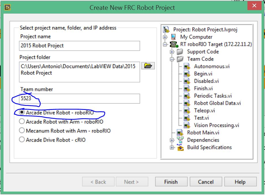

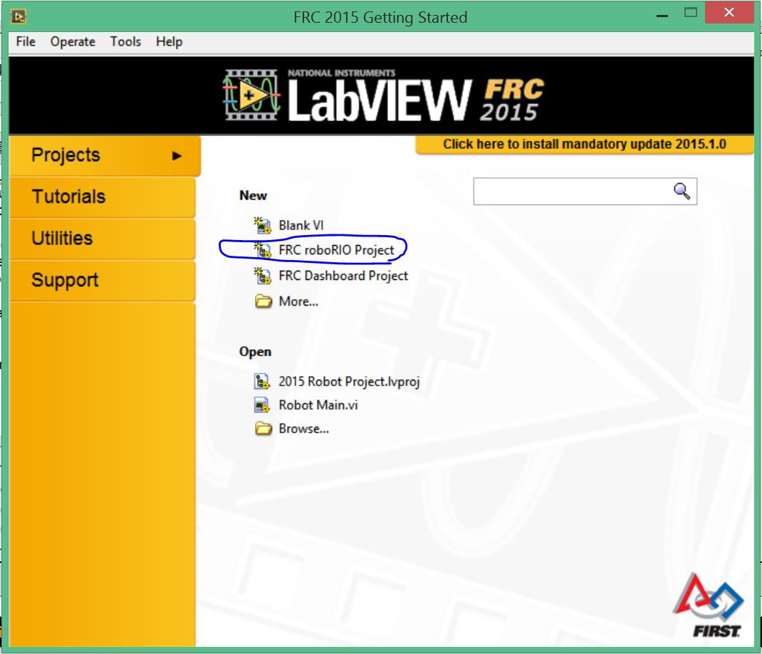

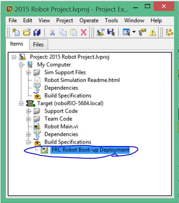

That program comes default with LabVIEW (it uses the y-cable setup). I’ve attached images showing you how to find it.
You need to right click on “FRC Robot Boot-up Depolyment” and click “Build” to compile your code. When that is completed you should connect to your robot. Then right click on “FRC Robot Boot-up Depolyment” again and select “Run as Startup” to put your code on the robot.

I had done the steps in screen-shots 1 & 2, but instead of using the FRC Boot Up Deployment, I loaded the RoboRio with the RobotMain.vi.
I will try the boot deployment tomorrow and see if that will activate the left talon as well.

I also want to reiterate that AGPapa is correct, but also add that when on the robot’s wifi, one can click on the run button on Main.VI which is useful for debugging (this will make the code run on the robot in a probable state, but this “deploy” method does not stay after reboot).
