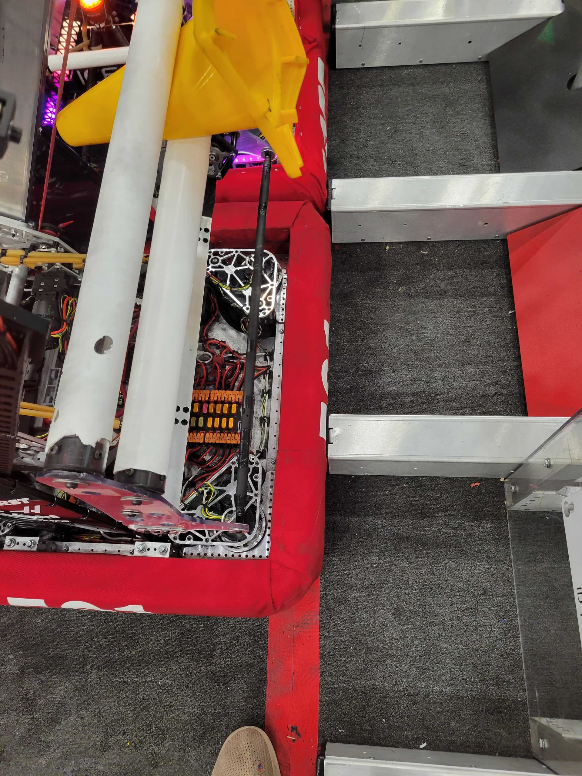

In addition to the main parts of our robot, we experimented with using “forks” on Spike so we could buddy-climb off the side of the Charge Station during the endgame. The forks that we ended up with pivoted around the elevator’s lower steel hex shaft. They were articulated with a cable that ran up from a winch to an idler located high on the frame of the elevator, then down to a crossmember on the forks. We used these forks while we competed at our Week 2 Regional, but we removed them from the robot ahead of the Week 6 Regional as part of a larger upgrade that made Spike faster and more stable overall.

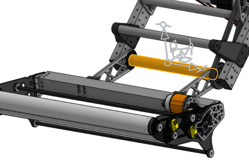

How was the torque tube attached to your intake?

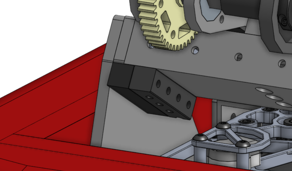

Is this nut strip a mount?

We started by sanding the inside face of the torque tube and the outside face of the VersaHubs, then bonding them using some green Loctite. We also carefully drilled & tapped holes through the tube and into the VersaHubs so we could use a few #10-32s to help transfer the torque even further. Unfortunately, I don’t have any pictures of this process, but this sketch hopefully captures the general idea:
We found this method to be really reliable; we never had to touch the torque tube again after it was installed!
This was an experimental addition to the robot that would have helped boost the strength of the elevator mount. A combination of months of use and some (pretty significant) over-torquing led to us experiencing the threads of our tube plugs being pulled out right before our offseason competitions, so we were looking for some ways to beef up that connection. Ultimately, this one never made it onto the robot as we were able to resolve the issue by replacing the tube plugs and being more mindful about how much we were torquing our bolts down.

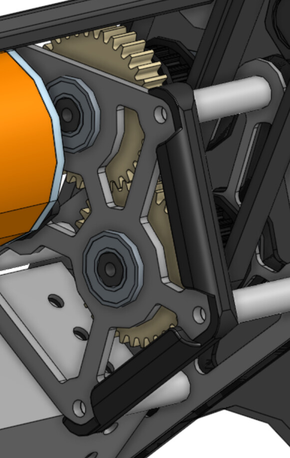

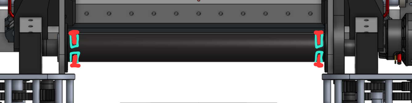

I’m curious what these little printed covers do on the intake though:

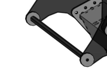

Are they anti-cube-slicers? I also noticed you have an exposed hex shaft acting as the bottom of your intake, near the ground - did you destroy this often or did the polycarb absorb any accidental impacts?

They are indeed! Proud to say this particular claw rev never chewed up a single cube in all the time we used it.
We never had to replace it, but it did get a little bent. You can see this bending in this picture taken at CalGames:
Being attached to the polycarb definitely helped with absorbing impacts. Having this be a standoff and not a roller was one of the biggest optimizations we made to our claw over time since it was both much lighter and could tolerate bending like this much better.
