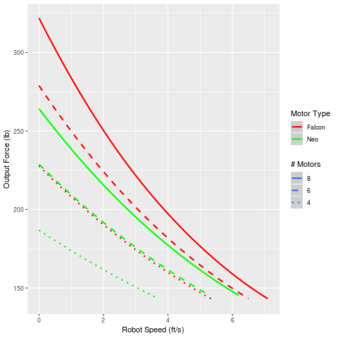

I’m not sure what motors you intend on using for your drivetrain but I modified his script for the Falcons and the Neos and this is the result with a power limit of 1687.5 Watts (the amount of power that will drop a 20 mΩ battery from 12 volts to 7.5 volts):
NOTE: The power given to each system of motors is the same
If I understand correctly, more motors means greater efficiency due to the lower resistance of having them in parallel. If the graph above is to be believed, I think a 6 Falcon WCD could operate on 30amp breakers without losses to performance and with added efficiency gains.
