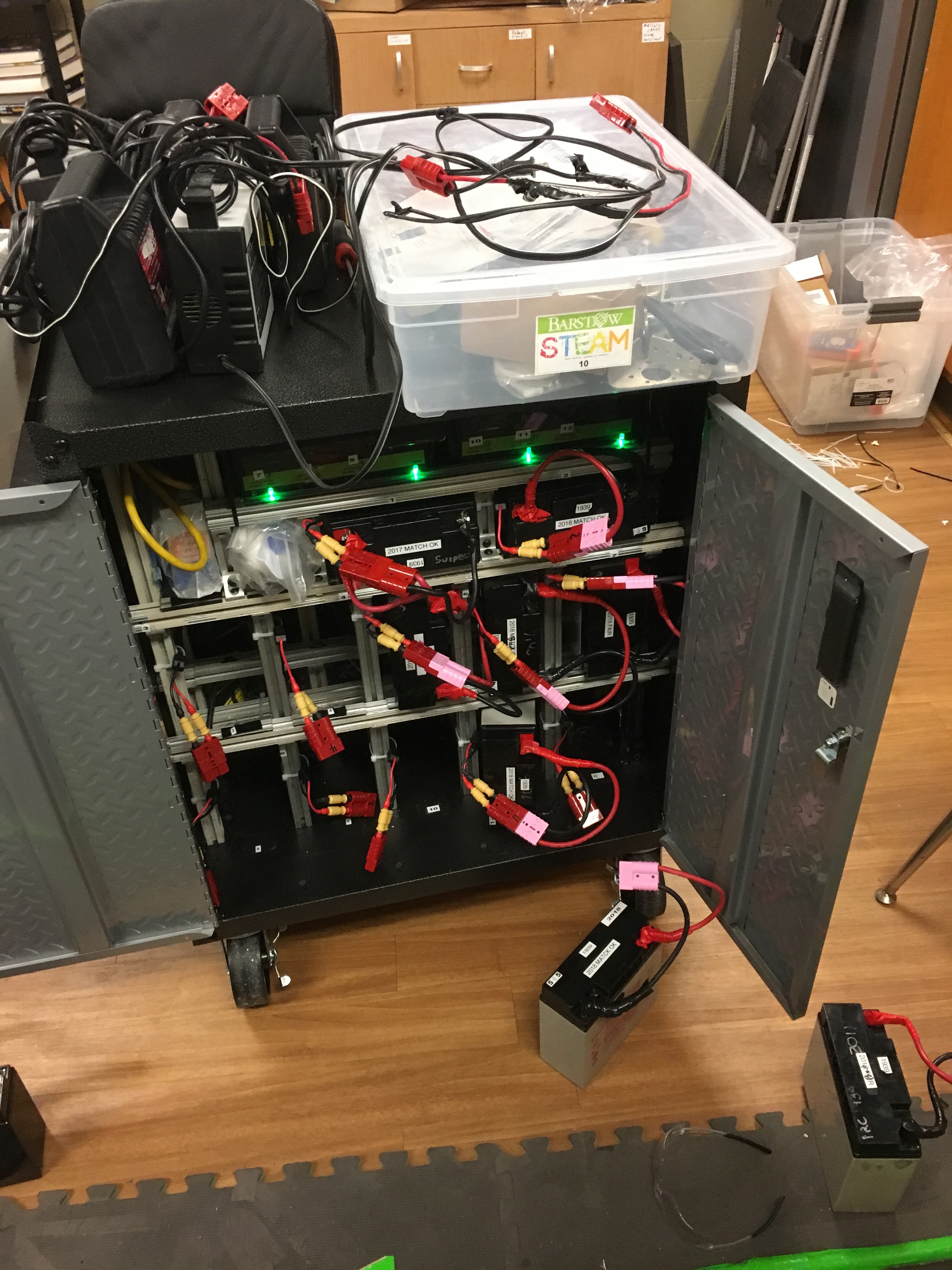

Team 1939’s battery cart
Here are the battery cart images that I promised in the last comment.

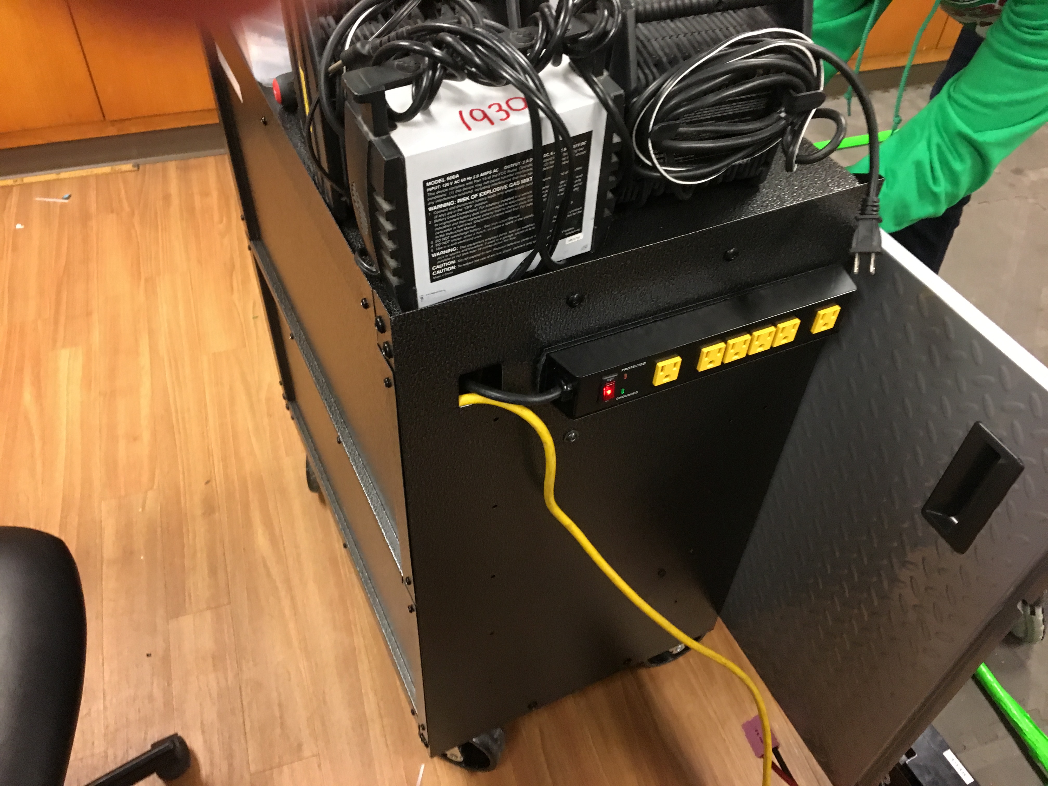

It holds 12 batteries with the 4 chargers towards the top to where you can see the lights. In the upper left corner there is an yellow cord that we cut a hole in the side where you just pull the cord out of. We also made the doors detachable but nobody ever took them off at competitions. We built it for 12 batteries because that is how many we had at the beginning of build season but now we have a few more so you should plan for a few extra batteries if there is a possibility that your team will get more batteries. Also one of our amazing mentors told us about why the battery spill kit needs to be accessible so that is why it is in the front of the cart. You also want your frame not to far back or not too far forward in the cart or else it will tip over more easily. We attached some lexand (a plexiglass type material) to the bottoms of each battery slot so that the battery could be supported After we finished we were thinking that ductape could have been an easier option instead of cutting each one to the exact size.
We did not get to paint the interior frame with time constraints.
I would not suggest a power strip with a switch in it because the switch got broken at competition and luckily it was switched to on at that moment. On the inside of the back I would strengthen it with more 80-20 so that it won’t get a huge dent like ours did.
Hope that this and my pervious post was helpful would love to see your finished battery cart.
