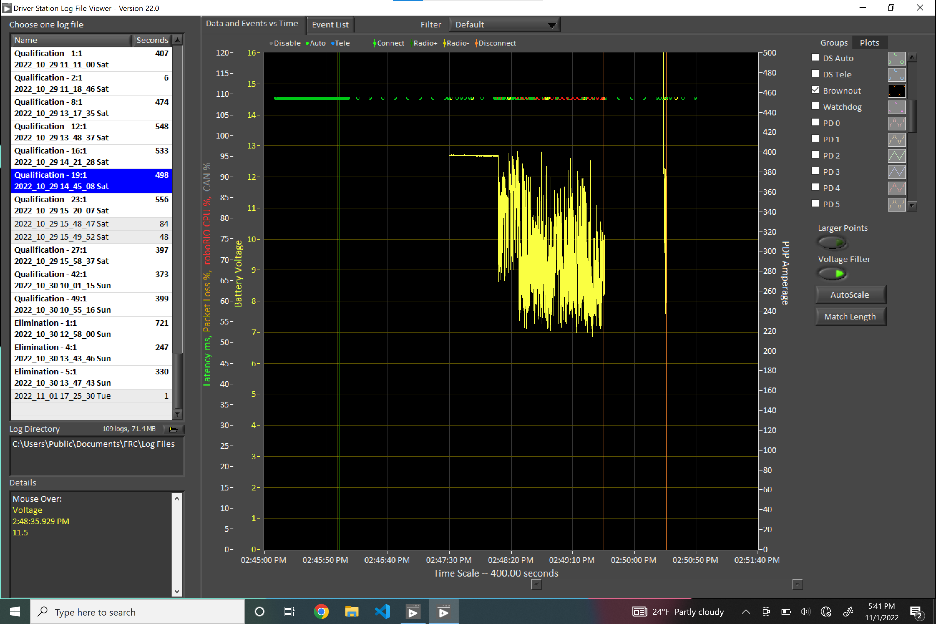

Quals Match 19
Details
  • Intake malfunctioned during auto
  • Heavy Defense by 4911
  • 4911 slotted under 7461
Untitled
Untitled (1)
  • Robot disables at 1:30
  • The robot comes online at 2:31
  • The robot combusts at 2:32
sushi_smoke
quals_19

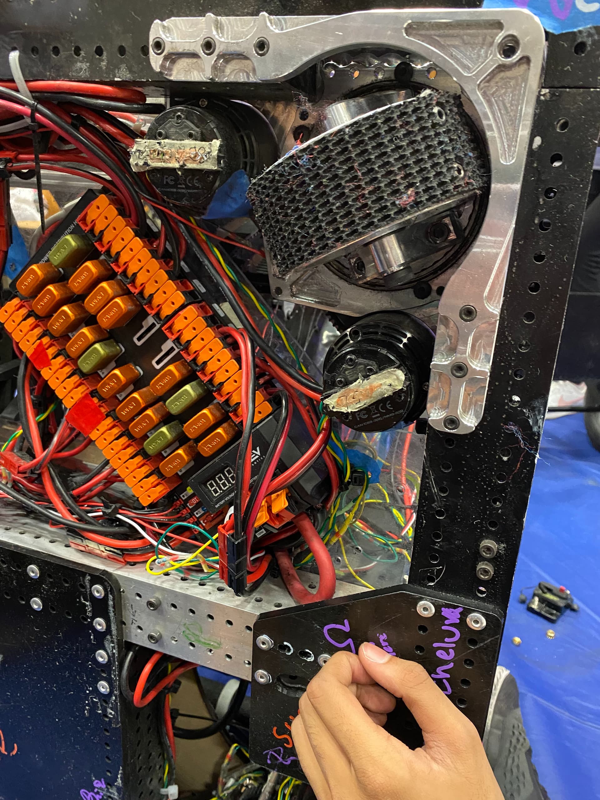

  • Post Match Electrical Inspection
  • Ground Wire lose from PDH
  • Power Wire metal shavings causing a short circuit between power and ground
  • Melts motor power wiring around the short
IMG_0819
  • Pit Crew Electrical Team splice power cables and replace them as necessary
  • PDH/ports are not fully inspected
  • The ground wire is placed back into the port after the splice
  • Electrical Systems check and subsequent intake testing are successful

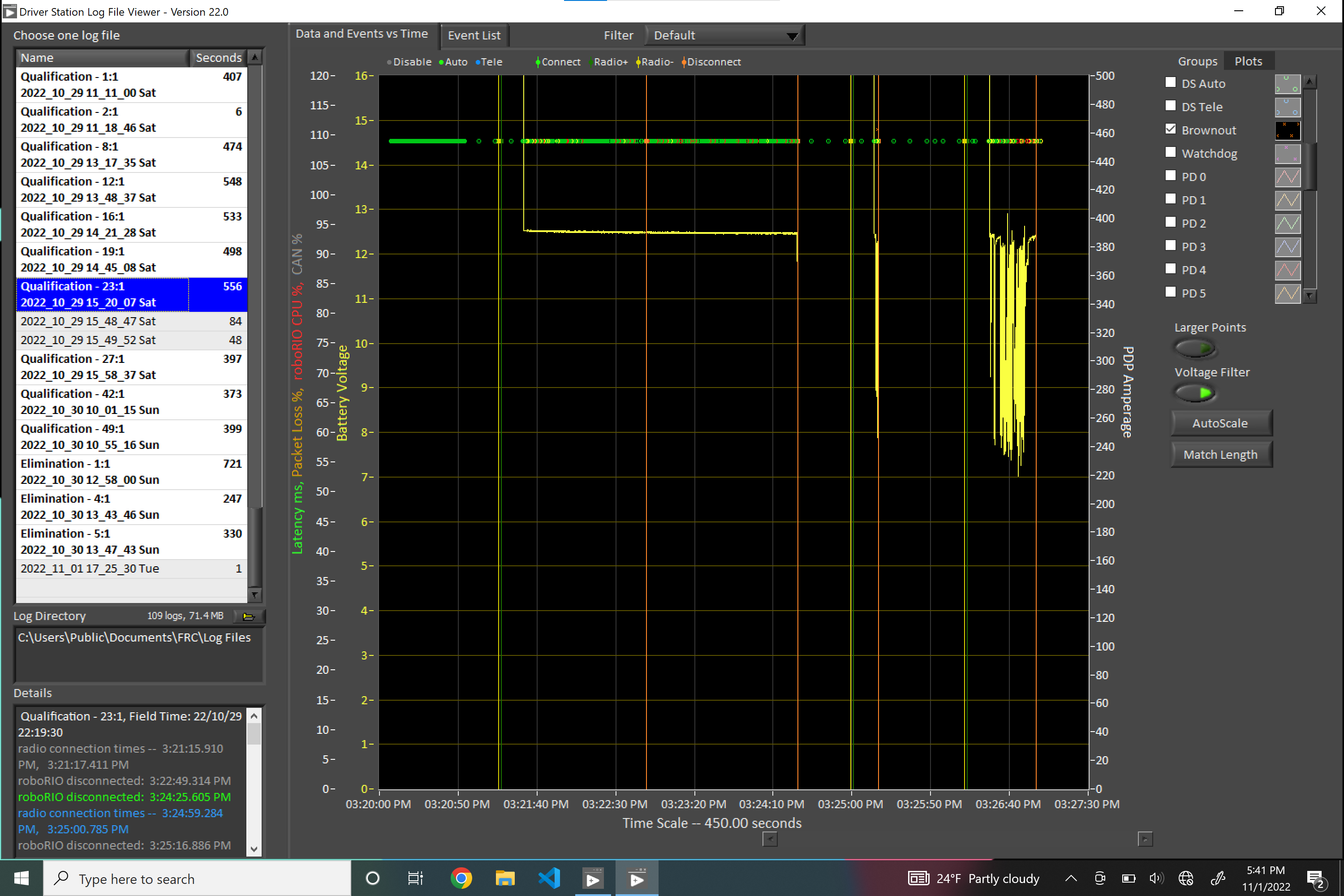

Quals Match 23
Details
  • Robot Fails on Startup
  • The robot restarts but shuts down
  • Robot Restarts near the end of the match
  • Climb works
quals_23
  • The problem is suspected to be a current limit issue
  • No Electrical Systems Check

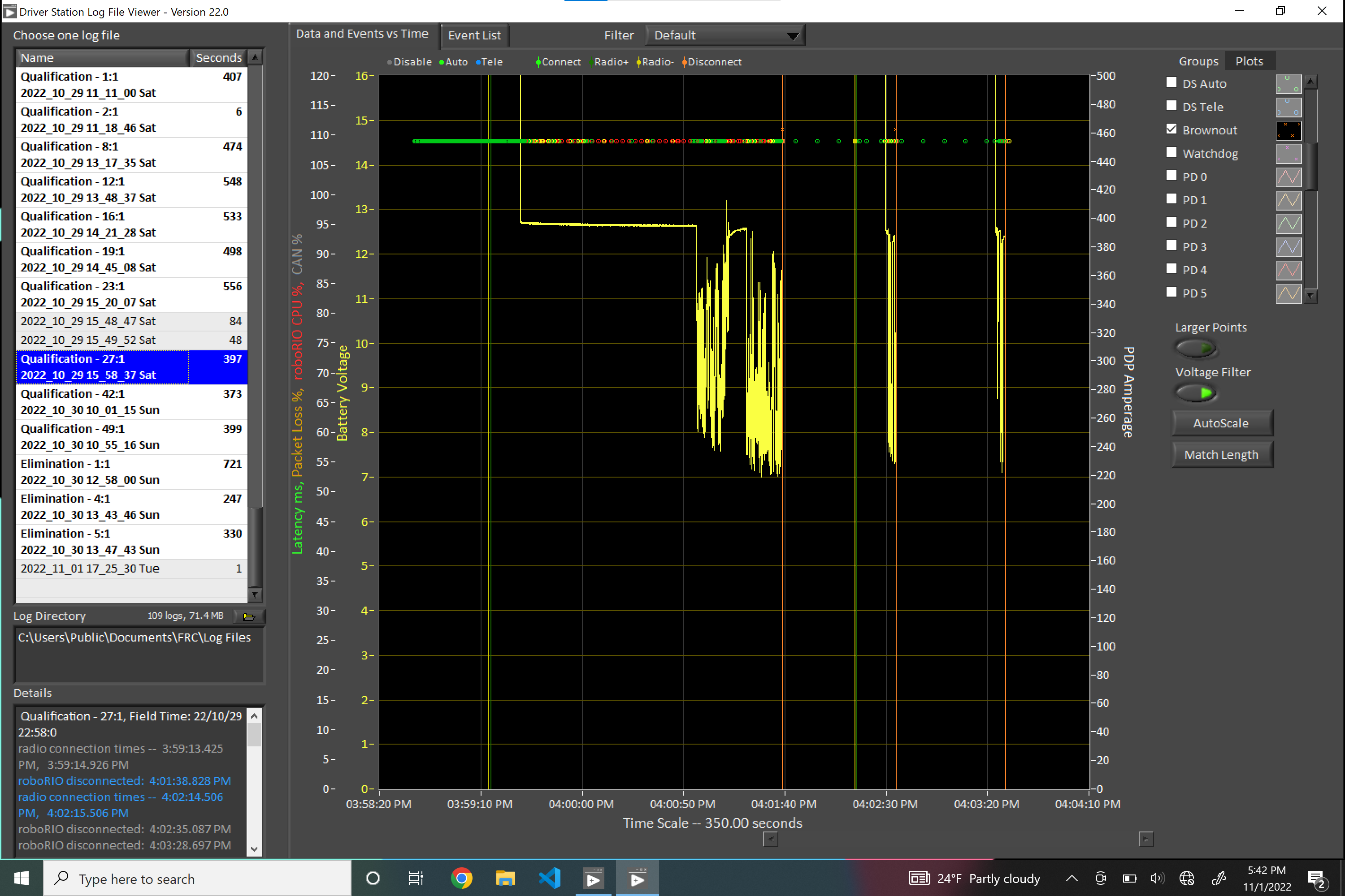

Quals Match 27
Details
  • Auto is successful
  • The robot fails multiple times during the match
  • FTA forces inspection of PDH
quals_27

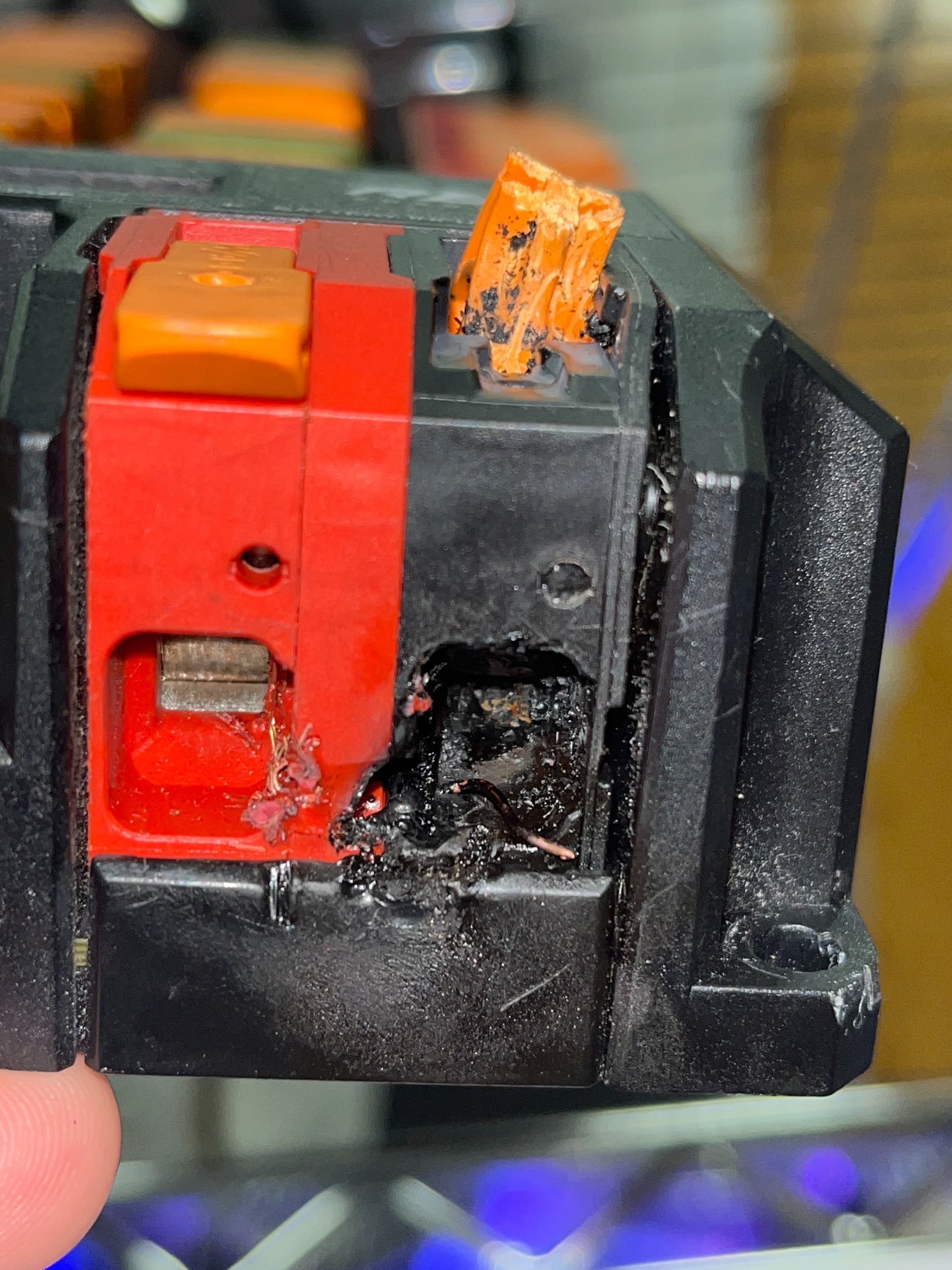

  • The breaker in the on position does not send power through the system
  • PDH has ground wire melted into the system
  • Wago connectors break when removing Ground Wire
  • Further, inspection shows previously molten material inside the wago connectors
0700DB93-1477-4750-A52E-3836F2552791

In match 27, the wire likely caused a short circuit that melted through the plastic casing on the WAGO connections.
