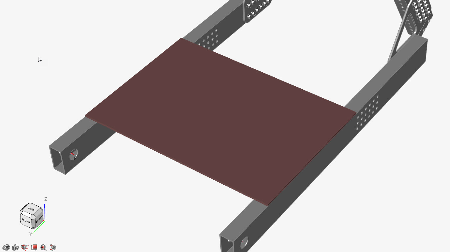

The Bearcats built a very stable robot. One way we ensured stability, while minimizing weight was using topology optimization, otherwise known as generative design. Here is one example.
Using Altair Inspire to give the general design space and basic loading (3 load cases):

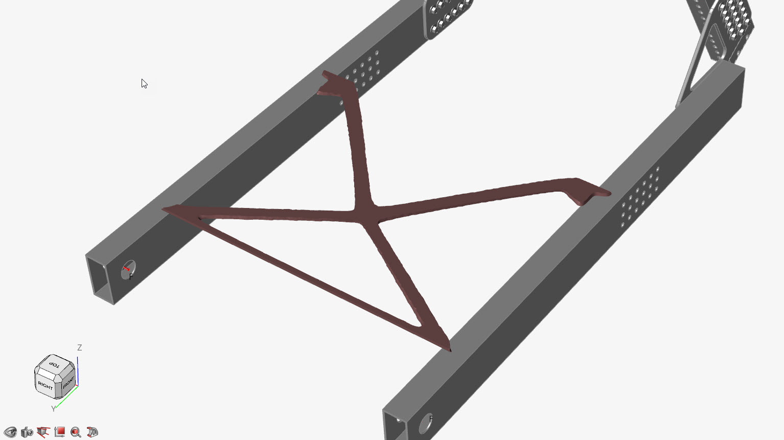

The most advantageous material layout and shape for the part was found:

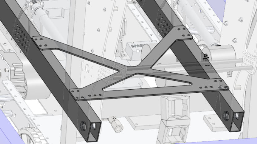

Interpreting the topology results and designing it in Onshape:

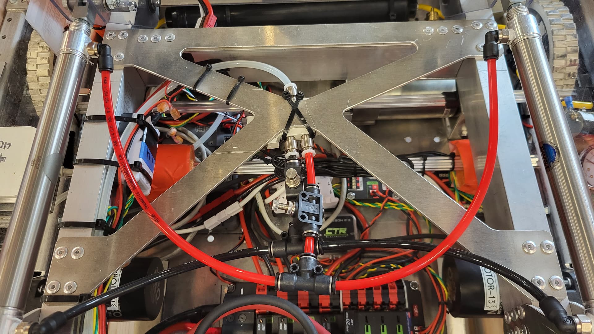

Now, produced and installed:
