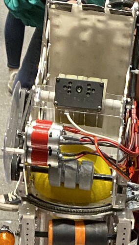

Team 2992 used a shooter design (almost) exactly like this. 2 x Redline motors (instead of 775 pro), 1:2 reduction (Vex 12T GT2 pinion pulley to 24T 1/2 hex pulley), 4 inch WCP solid roller wheels (4 x 1" wide). Additionally, we had pre-feed wheels (2" Andymark Stealth 50A) belted to rotate at same RPM to pre-accelerate PC. Approximately 2" of compression. We had originally planned on additional flywheel (stainless steel machined discs), but had to remove them due to weight issues.
We were easily able to shoot from the trench. Spinup time is about 2 - 2.5 seconds. Recovery time between shots is approximately 350ms.
We are using current limiting to protect motors, and closed loop PID in Talon motor controller, along with Rev hex encoder. Have not had any issues with overheating motors or motor failure.
Free speed of shooter wheel is above 8000 RPM measured. Shooting from trench, we are tuned to about 5700 RPM which produces a fairly line drive shot.
