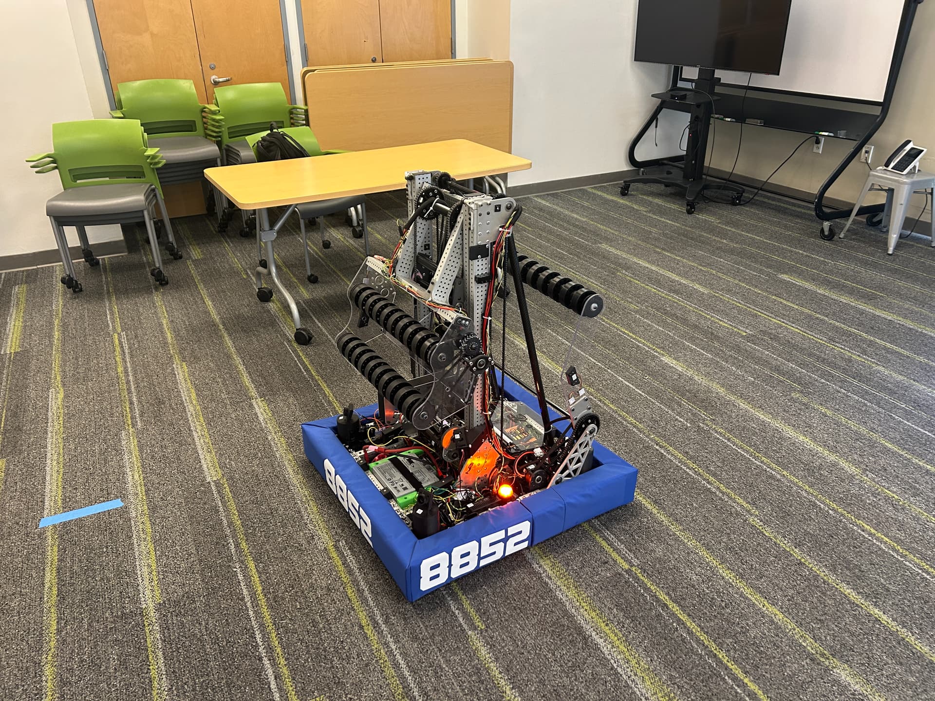

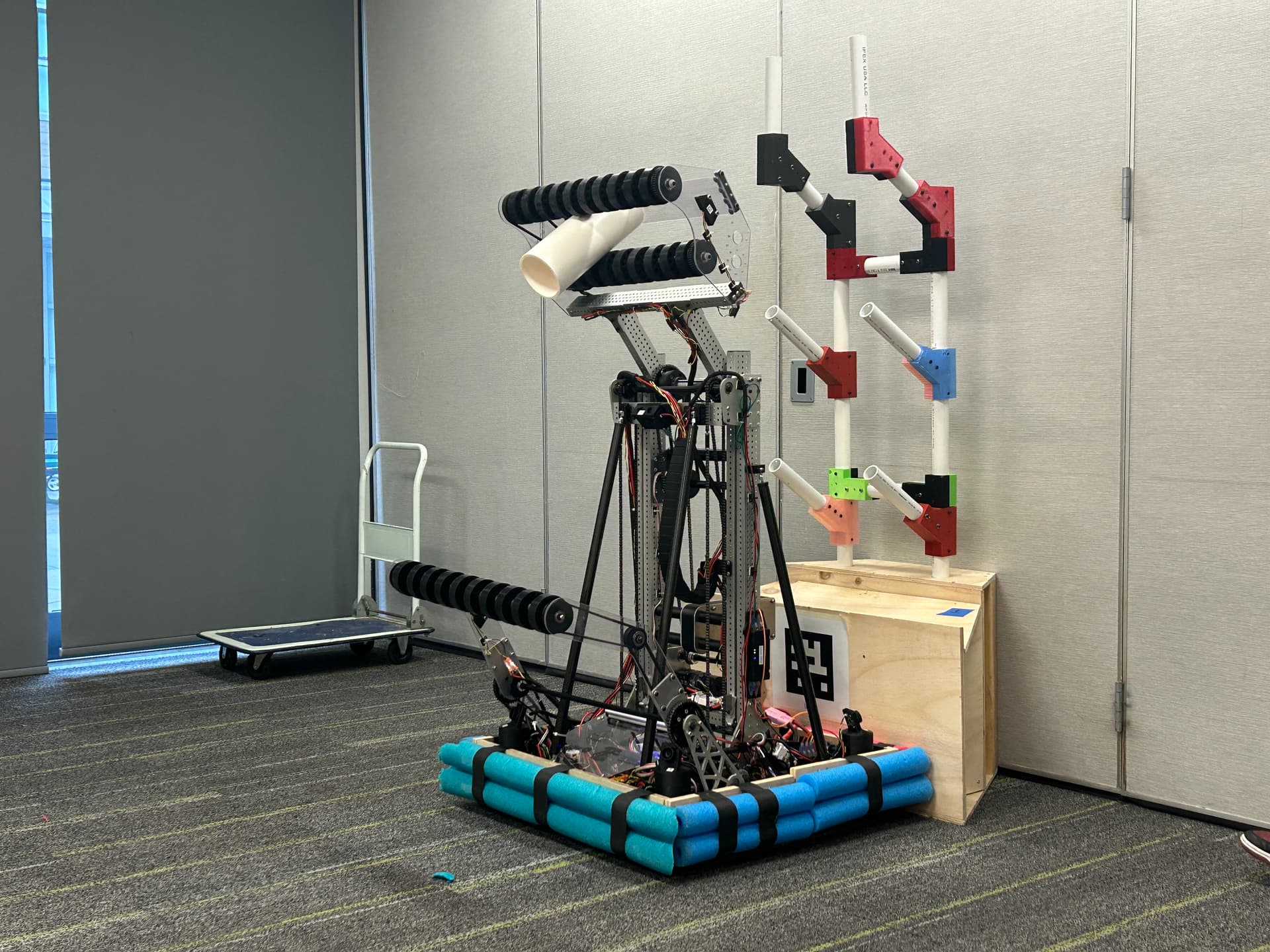

Team 8852 Drew Robotics is proud to present our Reefscape robot, Scoop.
Features:
  • Rev Maxswerve 26.5x26.5 drivebase
  • 1 stage “stage carriage” elevator rigged with chain
  • full width end effector that pivots on the elevator that allows for scoring out the front and back L1-4
  • end effector has a time of flight sensor to create different paths depending on where coral is indexed
  • processor mech on the backside
  • auto alignment to the reef and full field localization
    here’s a video of our auto align in action and our robot reveal.
See you at San Francisco and East Bay!

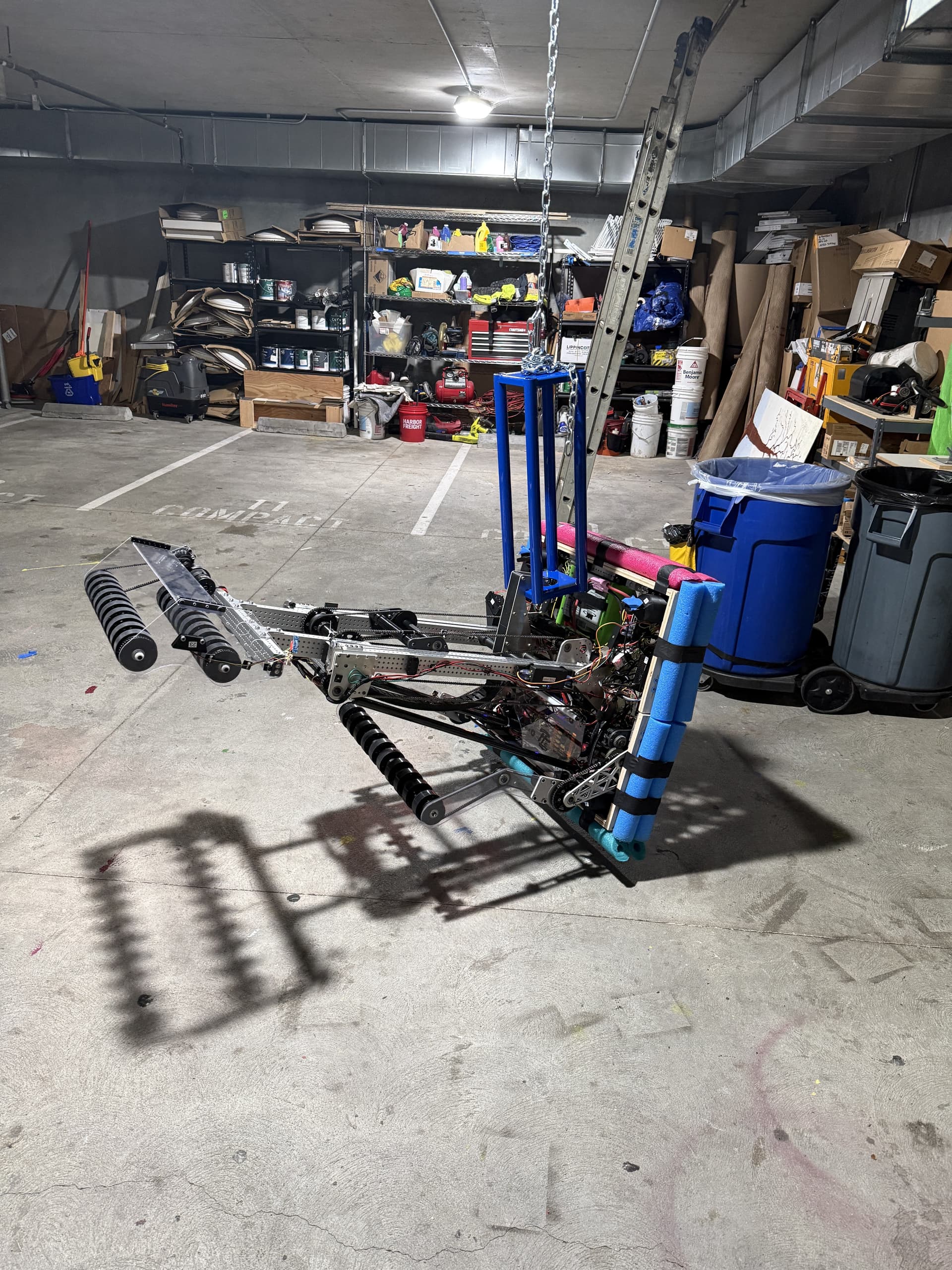

is this a shallow climb?
