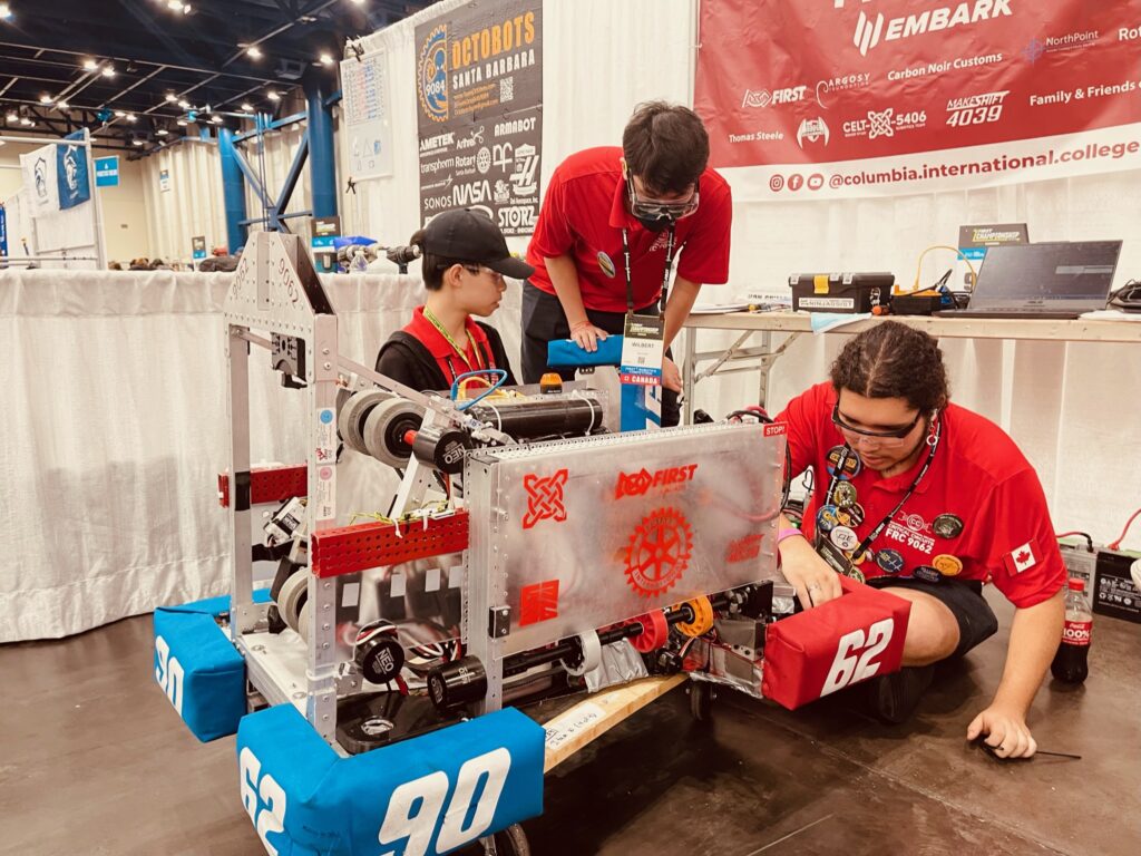

Team 9062 is a rookie team out of Hamilton, ON, Canada. This was a phenomenal introductory year for us as we competed at STEMley, Waterloo, McMaster, Ontario DCMP and the Newton Division.
We’re still learning how to CAD things, so our 2023 robot, Bryce, has an incomplete CAD. Despite this, we thought it would be nice to show off what we were able to accomplish this season in case people were hoping to build a long range cube shooter of their own!

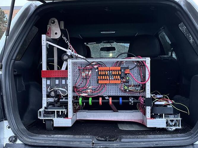

Key Mechanical Features:
  • L2 MK4i swerves
  • 38" by 22" chassis with 1/8" steel belly panel (longest swerve in the world to our knowledge)
  • 2 side roller intakes for cubes, 22" width each
  • Dual flywheel shooter with 4" Colsons on 2x 1:1 Neos at a 15 degree incline (35ft range, but proved inaccurate at that distance)
  • 6.5" Center of Gravity regardless of stick arm location
  • Originally had pneumatic cone nose gripper (similar to 2019 hatch grabbers, but ditched due to limited use and effectiveness)
  • ability to score low by ‘outtaking’ through the side intakes
  • designed for long range cube scoring and tiebreaking defence
Key Automation Features:
  • 2 piece balanced autonomous mode
  • 4 alternative autonomous modes
  • Limelight 2+ with auto-alignment for cube node AprilTags
  • Originally had a full pneumatics system for cone gripper, removed for DCMP
  • 1-button launch sequence for cubes with sequencer and shooter flywheel assemblies

Always great to see a compact robot that can fit in a car
Thank you! We are appreciative of all the support from Celt-X this season. Looking forward to our outreach on Sunday with you!
thanks! it fit with ~1" clearance in all directions with the seats up normally. This was not planned for and incredibly satisfying when discovered!
