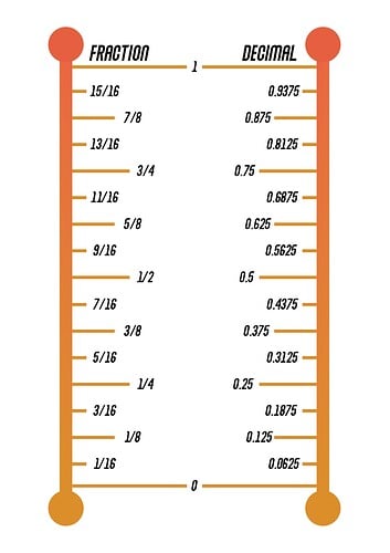

As for using a tape measure just use a chart find the closest match.
It will likely be close enough.

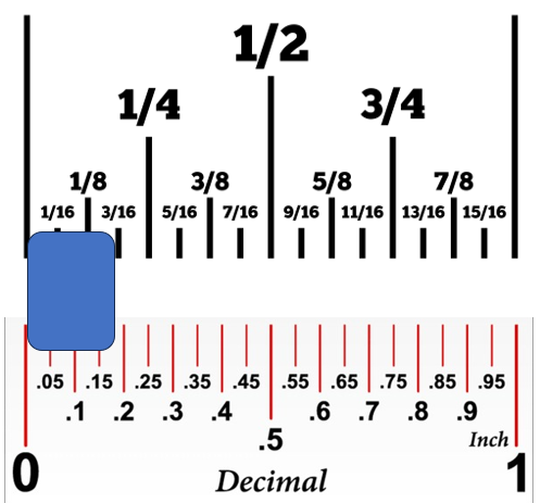

In general, what are the significant figures for fractional measures?
I can measure this piece and fairly confidently state that it is 3/16" because I have a fractional ruler. Could I state that it is 0.1875" ? I don’t have enough precision to know it isn’t 0.1872" or 0.1877".
For example using the decimal ruler, I can see that it is between 0.15" and 0.2", but would be forced to estimate the 2nd digit as I can’t determine if it 0.17" or 0.18".
Significant figures for fractional measures can be understood by considering the divisor a base-2 number, not a base-10 number.
When you are measuring in “sixteenths”, you are measuring in significant figures of 2^-4 inches.
When you are measuring in “sixty-fourths”, you are measuring in significant figures of 2^-6 inches.

Exactly the same principles apply. I was always taught that you estimate to half the smallest division on the scale, and then use that as your error. So in your picture, it’s clearly closer to 3/16, so you’d say that the length is 1/16 +/- 1/32. If it was about halfway between 1/8 and 3/16, you’d say it was 5/32 +/- 1/32.
