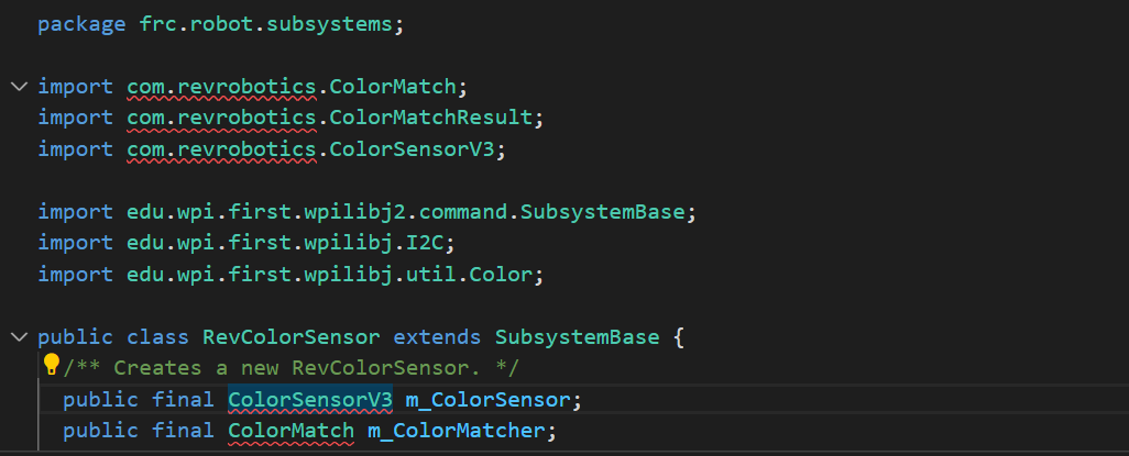

l have already installed the REVLib in my workspace .
However , when l open my project the next time, the REVlib seems to crash.

All of it would be nice so I could test my solutions but since I can’t. Can you at least post the import that caused the issue or is this all REV imports? Have you always had this issue or is it recent from something you added?

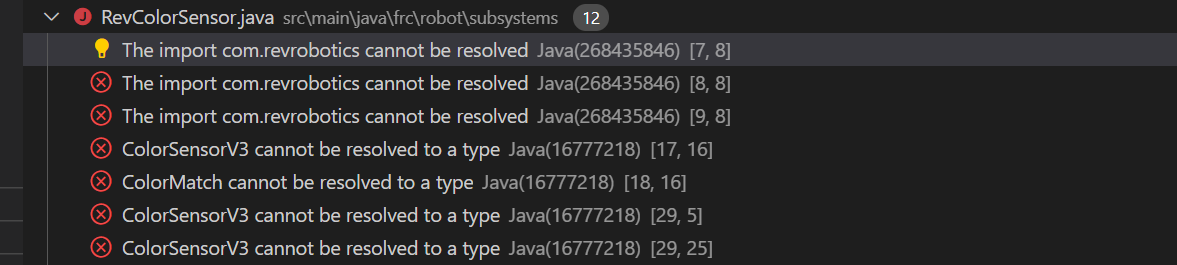

Does this code build? If not what errors do you get? To me it looks like you need to clean the workspace. I use that same code and it works fine.

Can you run ./gradlew build
in the terminal (like jdaming said) and see if the build is successful or fails? Sometimes VSCode doesn’t like to update the linter.
If it’s successful, then do Ctrl-Shift-P, type “java clean,” and press enter. Then in the pop up, press the restart and delete button.
Thanks , now it seems that there is no problem with it. That’s strange.
