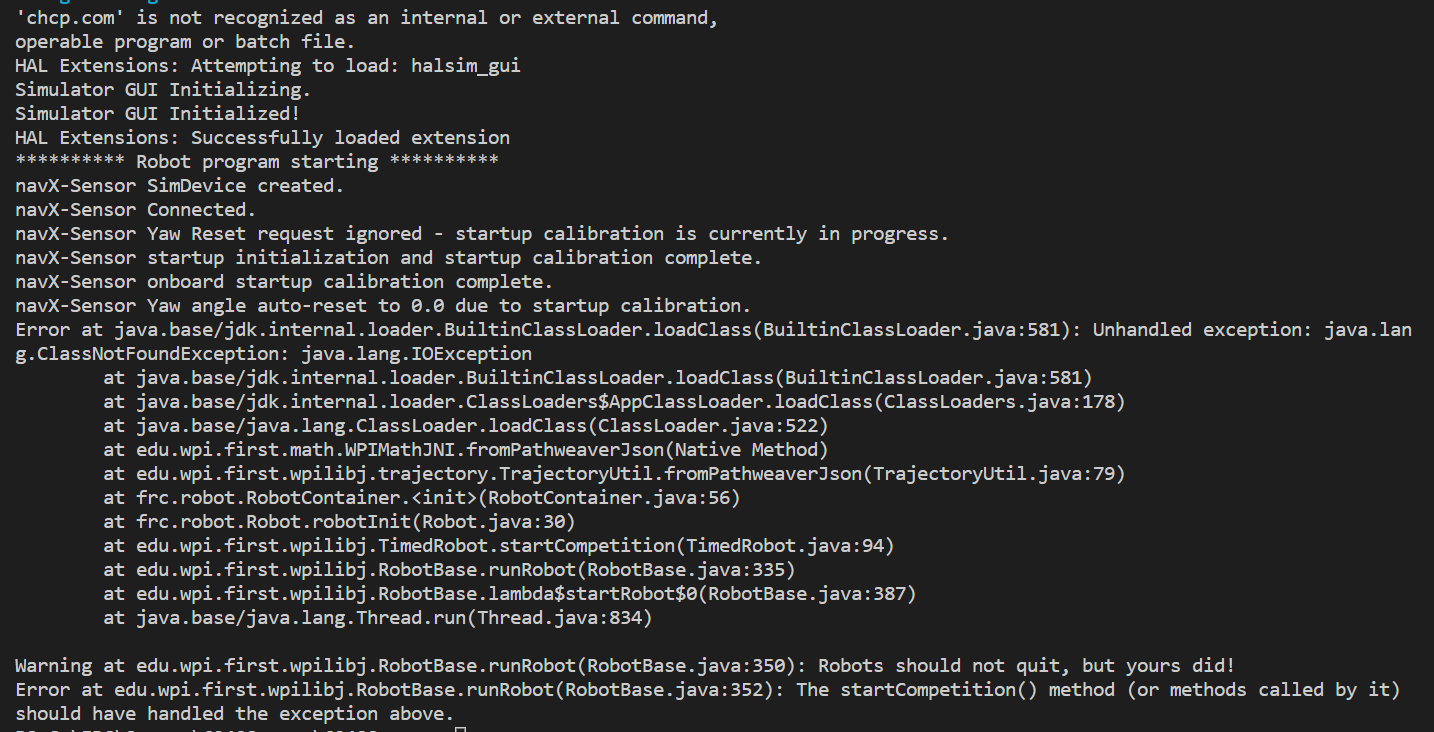

Above is part of my autonomous code , but when l simulate the whole code , it just quit . The error is below:
My whole code is here:

This was fixed in [wpimath] Fix IOException path in WPIMath JNI by lhvy · Pull Request #3485 · wpilibsuite/allwpilib · GitHub. Unfortunately, we haven’t made a new release since v2021.3.1 containing the fix. I’m not sure there’s a workaround either since the bug is in native code. Maybe downgrade?
Where should l change , it seems that l have already use the java.io.IOException.
It’s not a bug in your code. It’s a bug in WPILib that’s unavoidable for what you’re trying to do (calling TrajectoryUtil.fromPathweaverJson()).
So , is there any method to use Pathweaver’s path in an autonomous period?
No, it’s completely broken until we do a release or you downgrade.
So, now , we can only use Translation2d to make some points and use this to complete the auto line?
Yeah, making the trajectory in code instead is an option.
Will downgrade solve this bug? Why?
Is there any other solution? l think this is too difficult and complicated for a good auto code
Yes. The bug was introduced in [wpimath] Use JNI for trajectory serialization by prateekma · Pull Request #3257 · wpilibsuite/allwpilib · GitHub, which was merged after v2021.2.2. Downgrading to v2021.2.2 will fix the crash. It’ll just take longer to load the JSONs.
