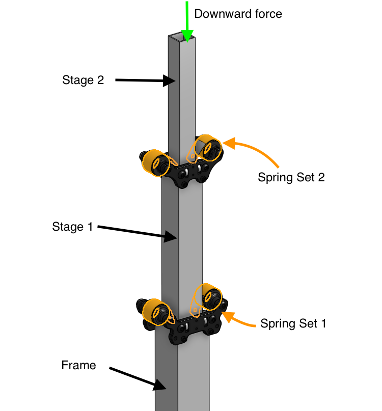

A question about constant force springs and telescoping tube arms
Our team is considering using constant force springs to power the extension of a telescoping tube arm, but we do not know how much force will be required to retract the tubes. The telescoping arm would be retracted with a rope that runs through the center of all of the tubes and is attached to Stage 2.
Knowns:
  • 1 individual spring is rated for 20 lbs of force, so each spring set will provide 40 lbs of force.
  • Stage 1 and Stage 2 move, the Frame is fixed in place
  • Spring Set 1 is attached to the frame and is pulling Stage 1 upward with 40 lbs of force.
  • Spring Set 2 is attached to Stage 1 and is pulling Stage 2 upward with 40 lbs of force.
Question: How much constant downward force (the green arrow) is required to fully compress the telescoping arm?
40 lbs.

Not quite, I would say 40 lbs minus the weight of the upper telescoping arm section

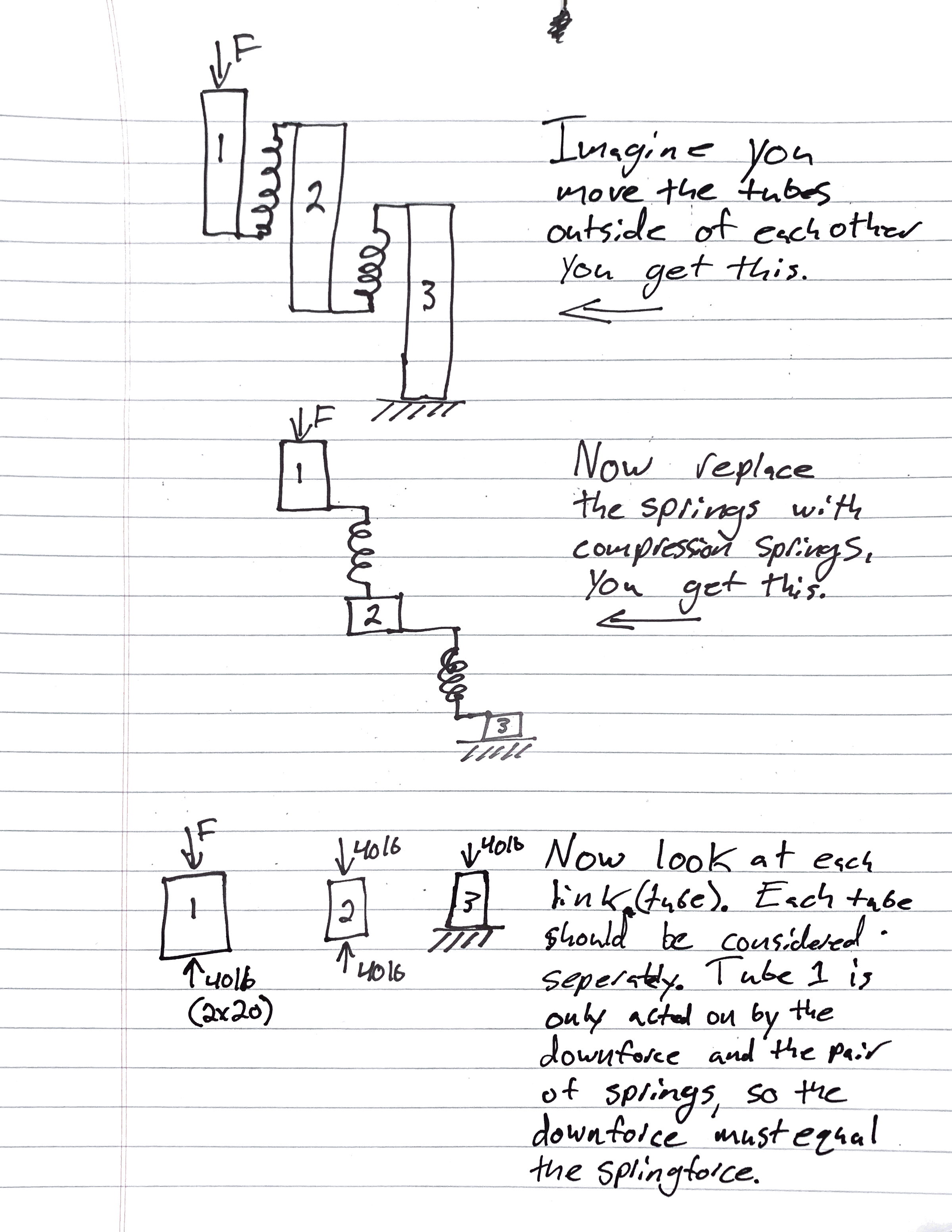

I did this on paper because I’m old fashioned:

To compress the arm, you need the force from the springs minus the weight of the arm (assuming you are vertical? You’ll need more if you aren’t vertical.) Of course, you should add a bit more to this when specing out motor/gearbox to account for friction. Then you should of course do torque calculations based on your pulley size (assuming you’re using a string).

Just to describe the free body diagram here:
Think of each spring as a separate entity and work your way from higher spring to lower.
Individually, because it’s a constant force, the spring will not extend until the normal force exceeds the spring force. In a vertical orientation, the total force is your motor power + weight of structure countered by the compacted spring.
Same deal for the lower spring, it doesn’t know about the upper spring, just that it’s countering structural weight and the motor’s force.
If the structure had the same weight as the spring force, the entire system would move and stop indeterminently and if the structure was 1 LB over the force of the springs, both would extend fully (minimal acceleration).
In this setup, the lower spring would start extending at a lower applied force than the upper spring, since the lower is countering more arm weight than the upper. Hence the lower arm would contract slightly before the upper part.
To better visualize, put a 10 LB spring on top and a 100 lb spring on the bottom. When force is applied, the 10lb spring would extend (pulling the upper arm down) first, and the second half won’t start moving until nearly 100lb force is applied
