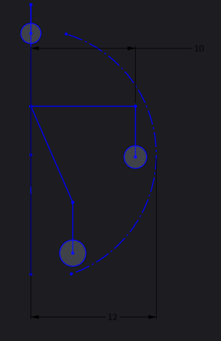

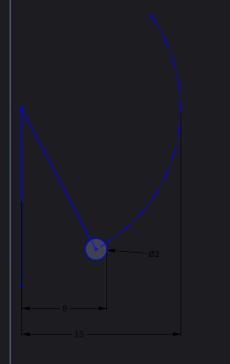

Our design this year implements an accumulator that begins within frame perimeter and folds out to 8 inches, however in the process, we reach a maximum extension of ~15.75. Big oops. This is simply to accumulate power cells, not to score or hang, so would this qualify as a violation of rule G18?

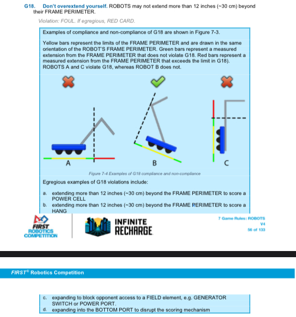

I believe that does violate G18 if at any point your extension goes past 12in
You can’t extend more than 12 inches outside the frame perimeter for any reason. It doesn’t matter if scoring is involved - that would only escalate the violation to egregious.

I suspect OP has a mechanism that deploys like this:
I’m sure they can figure out another way of achieving similar motion without violating the 12in extension rule. A 4-bar (or virtual 4-bar) would be one easy way to solve this problem.
You’re correct with that original drawing. The structure itself is more like the vertical and horizontal components of that line segment. I’ll check into your recommendation of a four bar, though it might be difficult to implement the same system… thank you!
