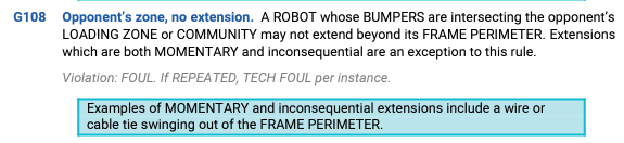

Do keep G108 in mind - the other alliance cannot extend outside of their FRAME PERIMETER if their BUMPERS are intersecting your LOADING ZONE. So unless they’re able to steal without entering your LOADING ZONE, your pieces are safe.

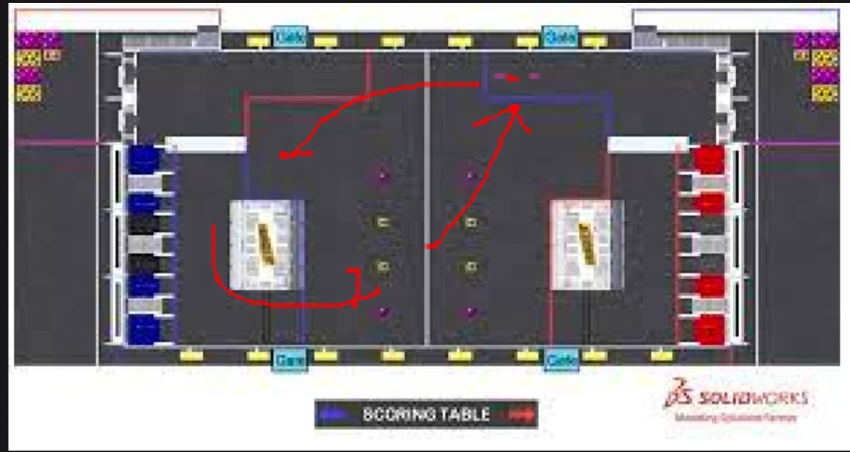

Our team discussed a similar strategy idea, but one robot on an alliance acts as a “shuttler” and delivers one cube/cone at a time to the community, with another robot lingering in the community with the intention of scoring the delivered cubes. Shuttlers would shuttle for the majority of teleop. It’s likely that an alliance’s feeder station will get crowded fast during teleop and the shuttler strategy would make scoring a lot quicker by keeping the feeder station freed up for two robots instead of one. Any robot that can intake from feeder and traverse the field fairly quickly can play as a shuttler. Having three robots constantly trying to enter/exit the community or feeder stations gets clunky.
