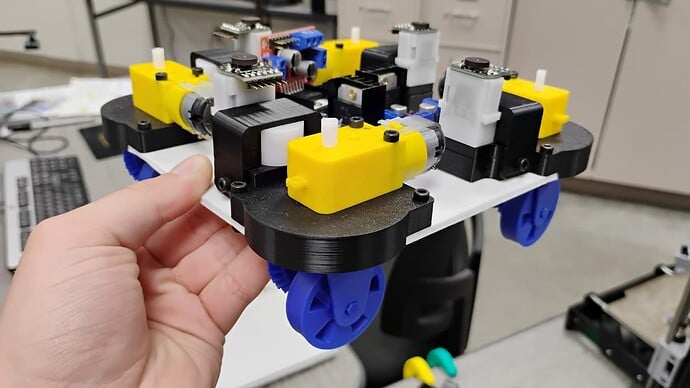

I’m trying to build a mini swerve robot that requires 8 motors, 4 of which have encoders. I previously tried to use ROMIs but quickly realized they would be insufficient.
prototype
The XRP has 4 integrated motor controllers, which is perfect for the azimuth motors. However, I need additional slots for the driving motors. All I really need for this is 8 DIO ports for direction, and 4 PWM ports for speed. it looks like it may be possible, but I can’t quite find the documentation that allows me to use these ports with the WPILib Java software.
I’m using the swerve library YAGSL and am hoping that it can also be used on the XRP to teach freshmen how to program swerve on our bot.

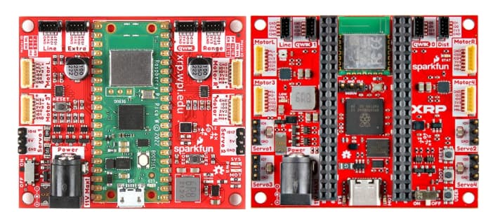

Also, is there a difference between these 2 boards?

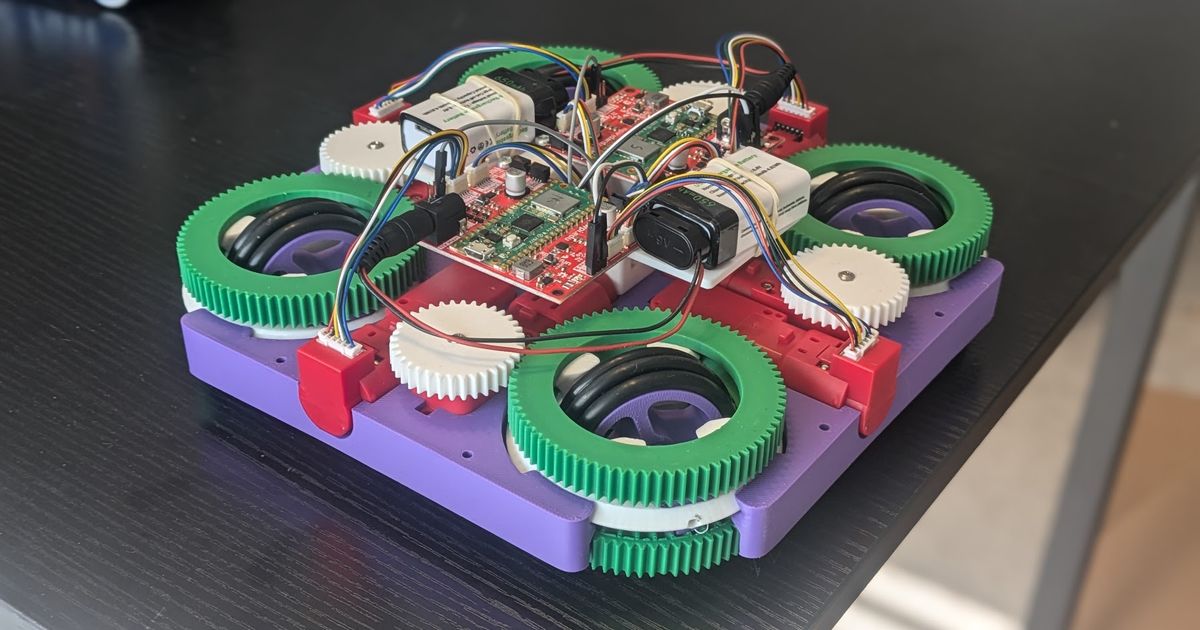

I’ve also seen this on Printables: XRP Differential Swerve Drive Robot! by Jacob Williams | Download free STL model | Printables.com
I know there is a swerve kit for XRP, but it is differential drive, not a traditional swerve. It also needed a custom protocol to talk to it, and the boards networked together. I don’t think it is fully useful for your purpose, but you might be able to learn from it.

It looks like the v1 board is now using a standalone RP2350 as a microcontroller rather than the Pi Pico (with RP2040). The RP2350 runs at 150Mhz (as opposed to the 133Mhz of the RP2040) and has 256KB more memory (520KB SRAM total). The RP2350 also has a better PIO implantation which should improve PWM handling.
It looks like if you are using the V1 board you are going to need to wait for at least the next WPILib release: [xrp] Update XRP for new SparkFun RP2350 Board (#7880) · wpilibsuite/allwpilib@dcd397e · GitHub
