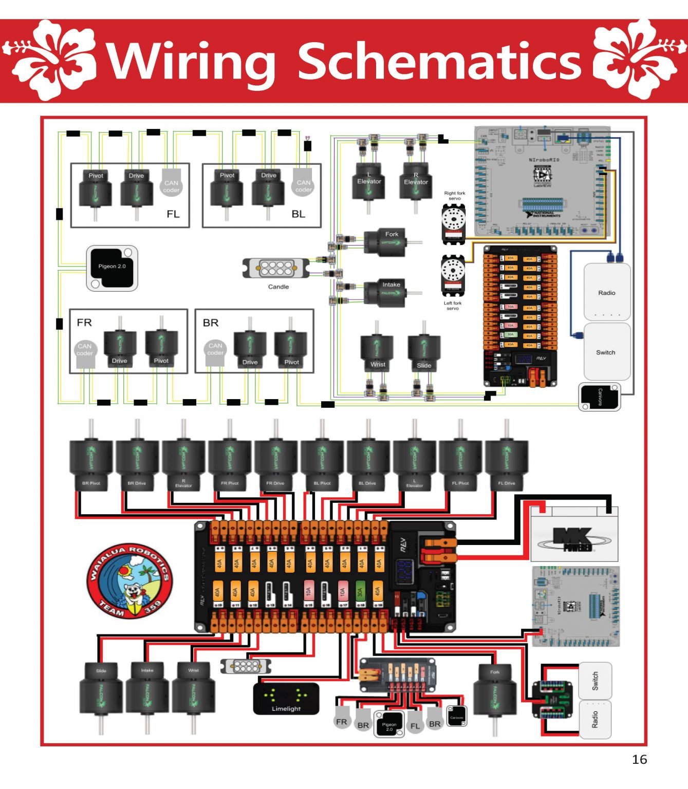

Hey, so we just finished trying to wire our things and we got power to the encoders and supposedly have a complete CAN daisy chain. We are using CAN coders so according to documentation you souldnt just connect to to the spark max directly. Your supposed to daisy chain it with the rest of the motor controllers, I saw no documentation on this (if you know any please slide) and all I saw was some wiring diagrams posted from other teams, showing that they connected they can coders straight to the Daisy train with the rest of the motor controllers
we did this, and I’m not sure what the status lights were indicating on the encoders, but I also Don’t remember the color, but they were red, then turn green for sometime and then the rest of the time we were trying to test I don’t know what they were. Apart from that when we tried deploy code, and just using the code that was already on there, and the driver station, we were getting a system log saying that the CAN id’s one through eight we’re not being found/identified.
I see that you define the drive and turning motor can ids, I don’t see where you define the cancoder can ids (it is these ids that need to be fed into the swerve code as the absolute encoder). BTW as a best practice we avoid having anything with canid 0 as this is often the default of most devices so easy to have conflicts, and our swerve modules are all configured as:
 Module Location       Drive Motor Can ID     Azimuth Motor Can ID   Encoder Can ID
 Front Left                    1                   11                  21
 Front Right                   2                   12                  22
 Back Left                     3                   13                  23
 Back Right                    4                   14                  24
This allows us to easily identify problems based on the 1’s 10’s 20’s value and we preset all of these same values on our spare swerve modules so we can hot swap them at events if needed and then only have to change the offset value for the absolute encoder an we are back on the field. We have our modules wired such that we have a can wire in and can wire out to make the module swapping simple.

For some reason, I thought you were using REV products. Wiring is a bit different over there. We still daisy chain. You could think of the CAN network (in the code side) as sending a message and knowing that there is a subscriber to that message in the network. There may be some differences from REV to CTRE, so I will slowly back into the nearby bushes… Sorry I couldn’t help!
