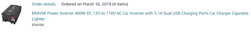

Here’s what we run:
Sorry, the 'zon link isn’t good anymore.
Works great, and has an auto “battery is too low, I’ma gonna whine and shut off”
