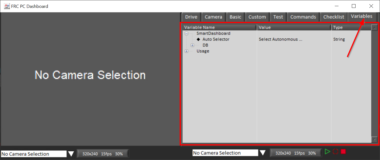

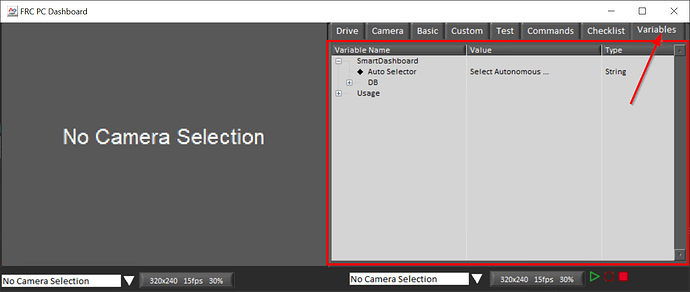

I would also add that you can see all the network tables data in the FRC LabVIEW Dashboard, and I would check there first if the names you are trying to fetch do exist:

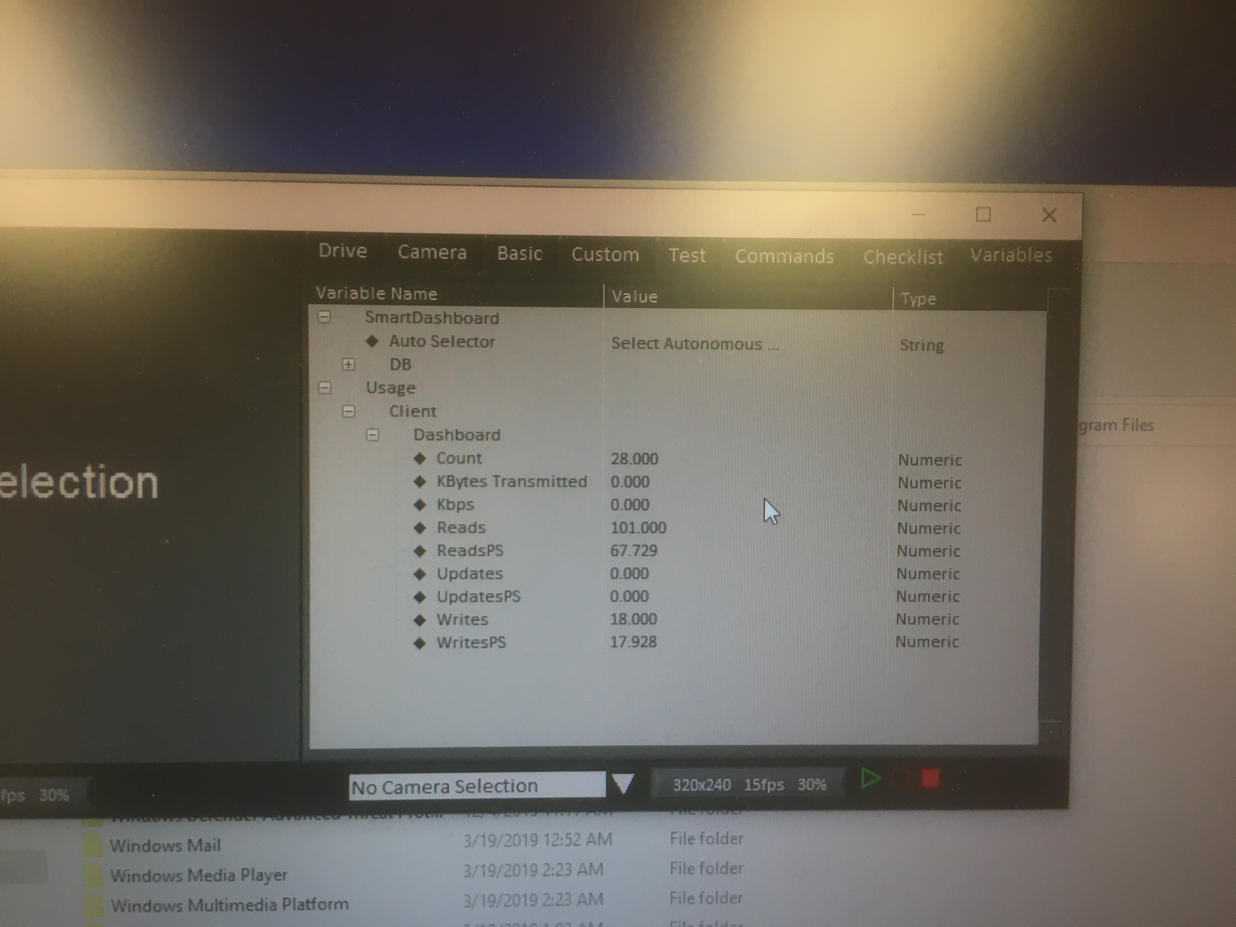

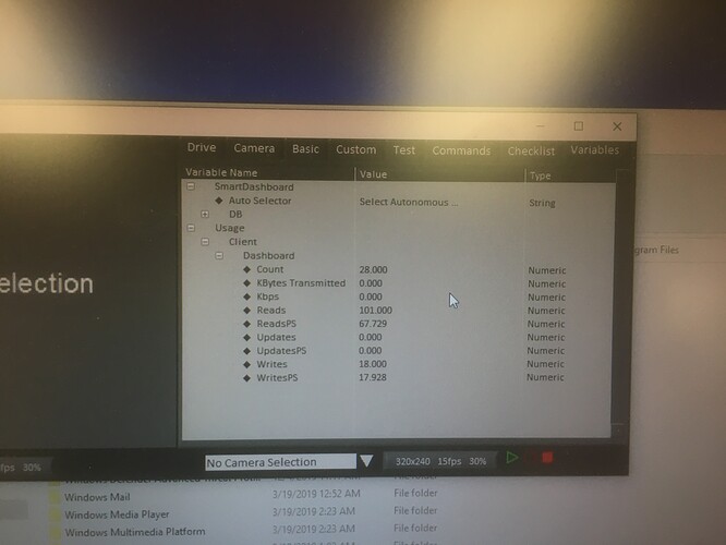

Upon further research, it appears OutlineViewer is only included in C++ and Java installs, which explains why I wasn’t able to find it. According to WPI, the “Variables” tab of the LabView dashboard has the same functionality, so I used that:

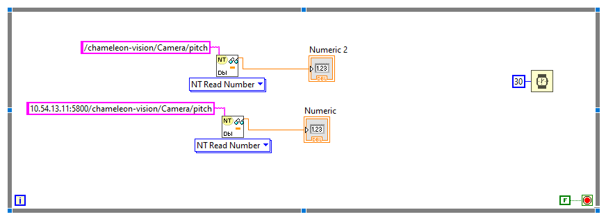

I tried changing the path to use a lowercase C, with no success. This is what the LabView code looks like now:

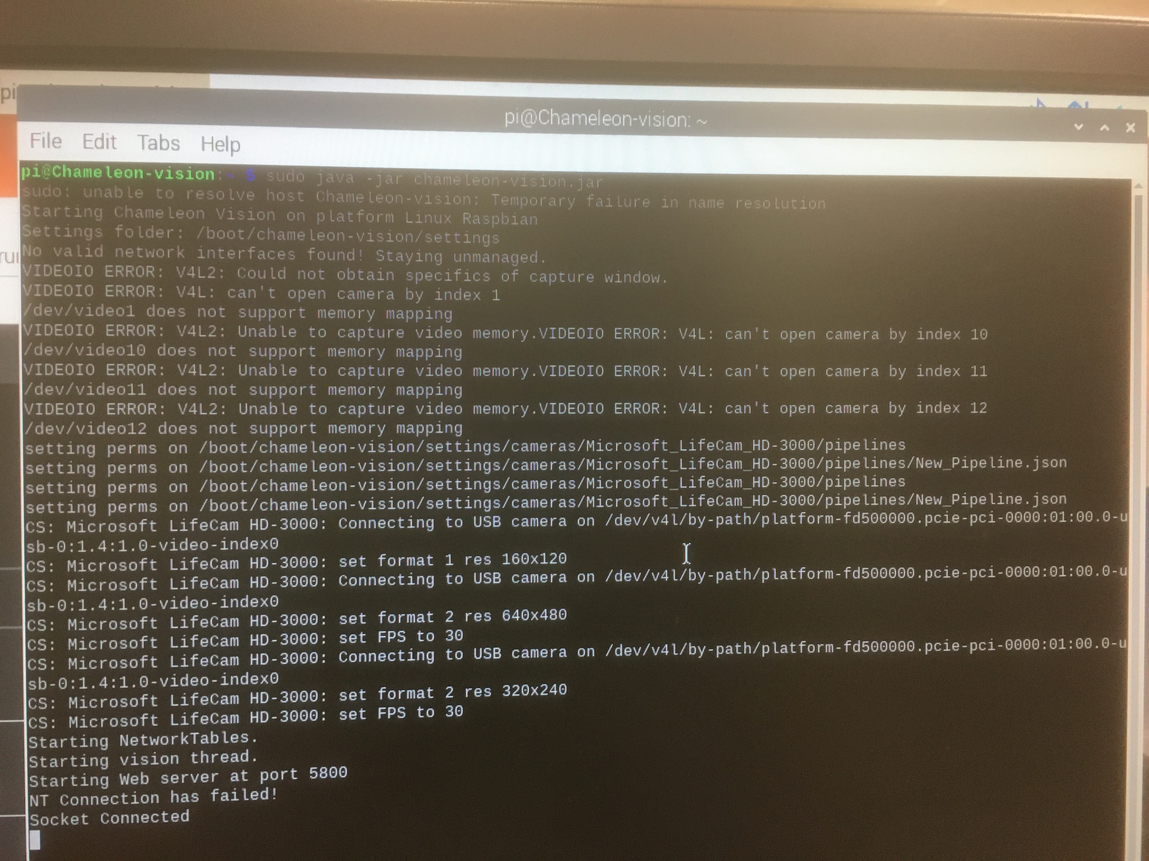

The terminal window I ran the Chameleon server on spit out some errors which appeared to be related to the network tables as well:

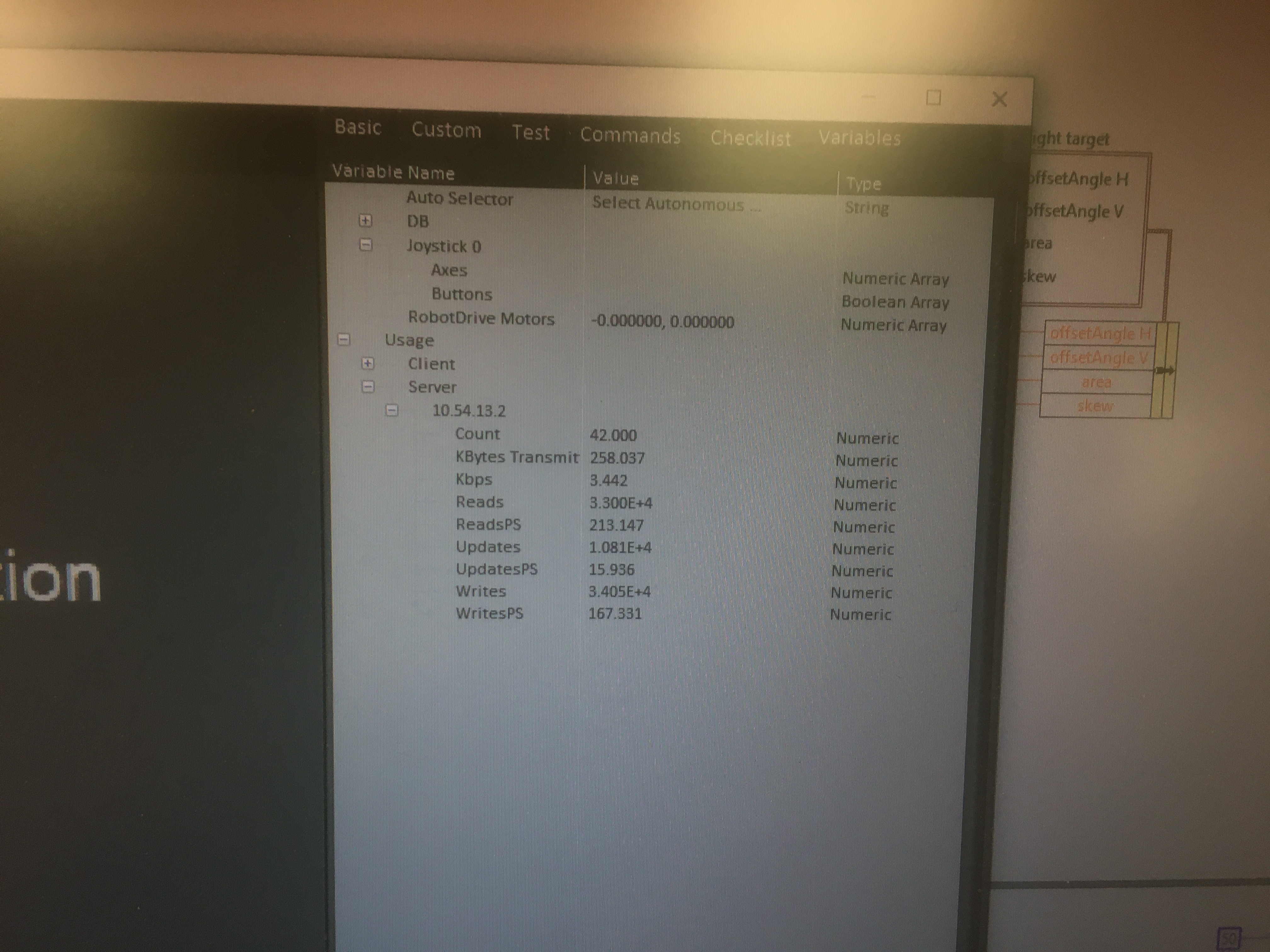

I also tried shutting down the chameleon server, running code on and enabling the robot, and starting the server again, which added a network table (I assume) at 10.54.13.2, but we still weren’t able to access any data (pictured below).
Based on what you are describing and the screenshots you publish, I agree that the RPi is not connecting to the NT Tables, and therefore we cannot read them from LabVIEW or from the LabVIEW Dashboard’s variables tab.
I recommend you focus first in having a successful NT connection in your Chameleon server, and then adding the LabVIEW portion to read from them.

That NT Connection Failed message means it couldn’t connect to your roboRIO’s NT server. You do have to have the Raspberry Pi on the robot network, with some user code loaded on the roboRIO. That will make the NT server available. Be sure you have set your team number correctly in the Settings tab, and then restart the program.
