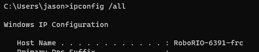

I actually figured this out a while back. You can access the limelight from simulation you just need to rename your computer so Windows automatically creates a DNS entry for it. Mine is named: RoboRIO-6391-frc. You will want to replace with your team number.
This basically tricks the LL into thinking your computer is a roboRIO.

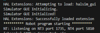

So for my understanding - when you run robot simulator the server is ran on the local host, correct?
Based on the below picture, network tables are accessed on port 1735 and 5810:
So the limelight, if it thinks my computer is a robotRIO will automatically look to host on one of those two ports?

Yep that seems likely it is hijacking it. If I run ipconfig /all in the command prompt I get:
