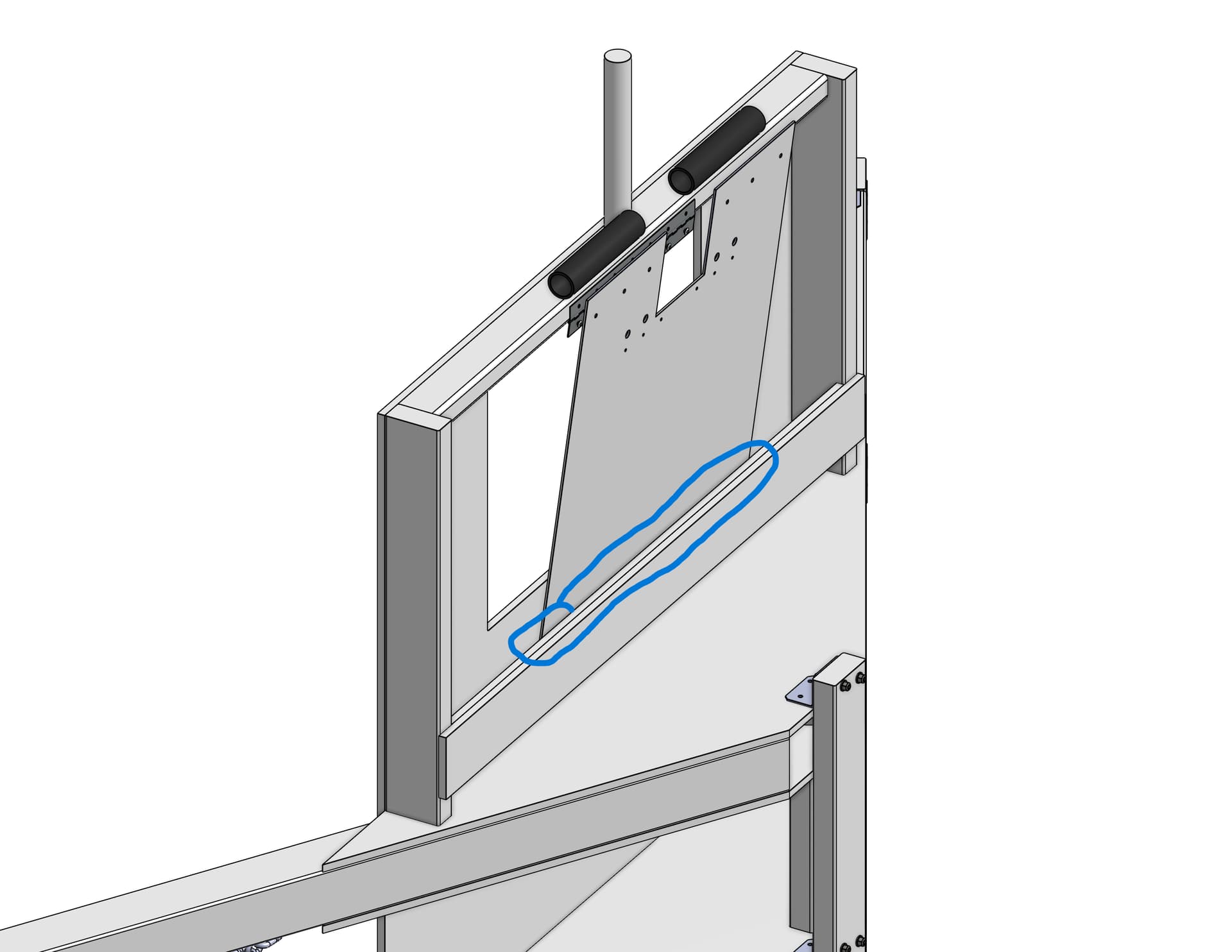

The other HUGE thing to look out for (and is not tied directly to the AndyMark door) are the dog ears that act as stoppers on the backside of the chute. This really limits the travel of the door and severely affects the way the NOTE drops into the trap. This right here is a game changer, literally. If you are attempting to shoot into the Trap, you must simulate this to the best of your abilities. Check out the official drawings.

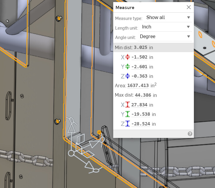

The team version Trap TE-24200 includes this piece of wood, which limits how far the Trap door opens to exactly the same as the real field (3")

We did install our own version of that but find that it might not accurately produce the same results as the real field version. The plywood provides a rigid backstop with no give. The field version is a piece of 1/8" polycarb that looks like it will have some give to it. We plan to modify our setup tomorrow and will let everyone know what we find. We hope that it will make the Trap shot more feasible.
