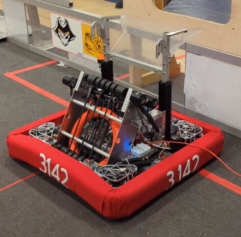

Hey @John_Bottenberg , did you end up using two REV linear actuators to climb?
Yes, we did! While I don’t have any close up videos of our climb, the general robot design (including the climber) looks like this:
And here is an example of a match in which we climbed:
