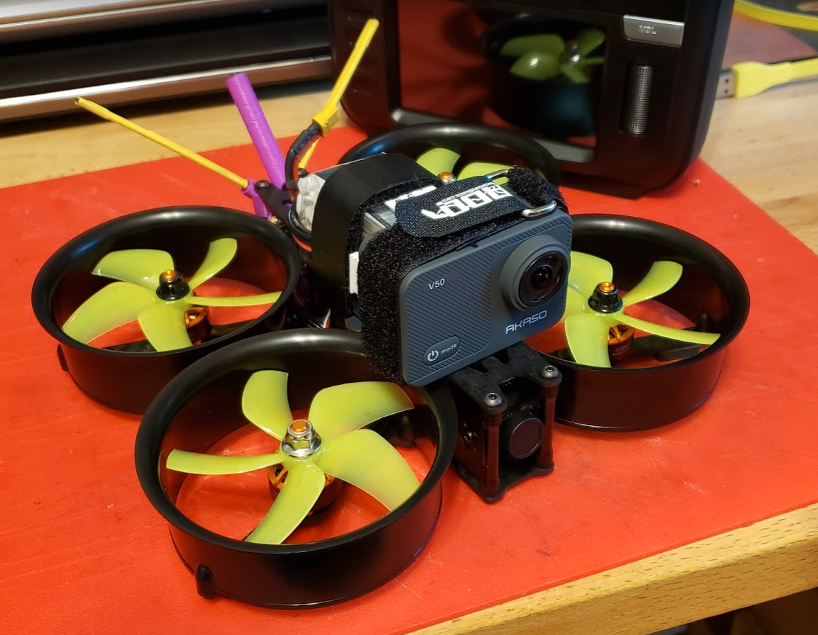

Some other teams have expressed interest in the status of this project, so we’ll give an update. To date we have 17 participants, with 3 quads completed, and more under construction. The actual cost per participant came in under our $750 budget at $647. This was largely due to cost savings from participating in the BuddyRC STEM team program. BuddyRC supplied the highest cost items (transmitter, goggles) at a great price and waived shipping costs. Final list of parts and supplies here: TORC Program Description.

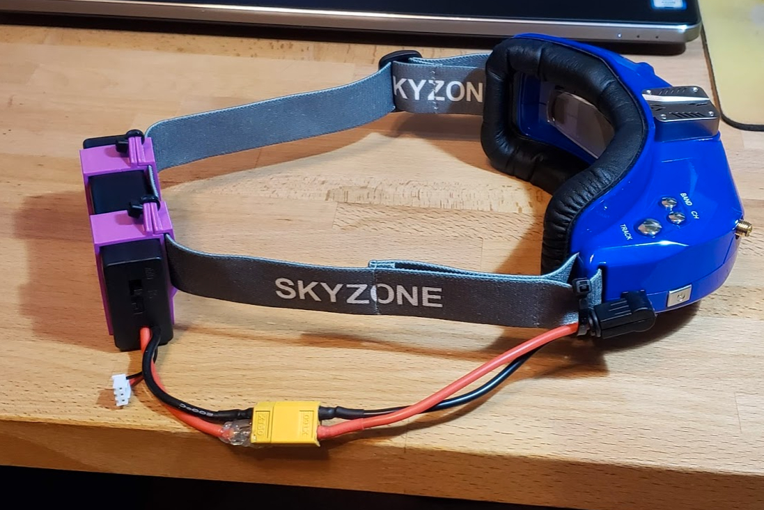

To make this more technically challenging than simply assembling a kit, we used the electronics and motors from one kit and mounted them in a different frame. This requires soldering skills developed by building a battery pack for the goggles, and several battery charging cables. Video guide for making the battery pack is on our YouTube channel. There is also a drone build guide to help the students through the process of building the drone, programming the transmitter, and initial drone firmware initialization.

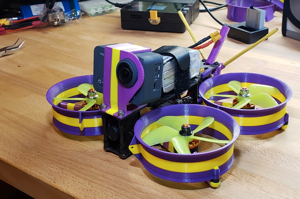

And, just for fun, here’s my drone, all tricked out with Triple Helix colors.

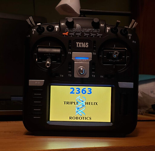

Our transmitter.
Our goggles.
