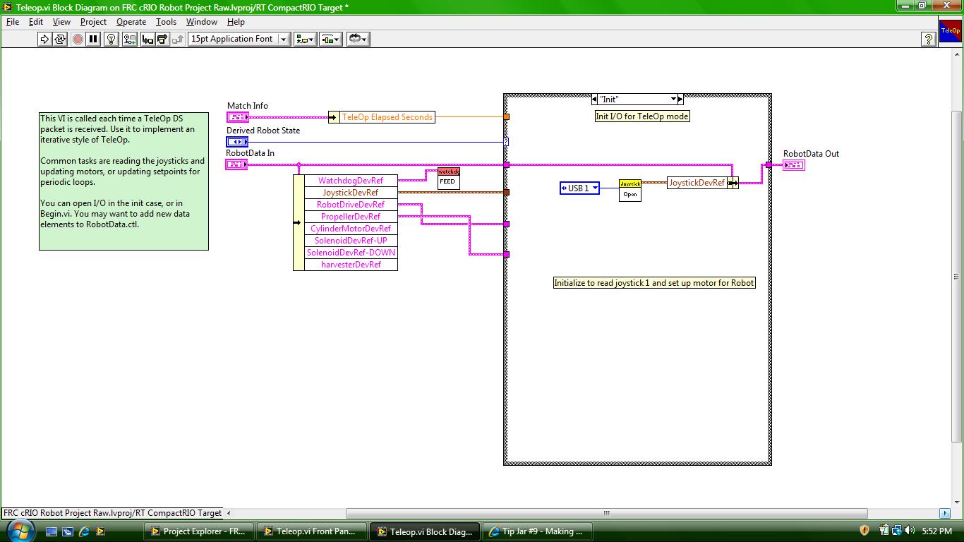

adding a second joystick to TeleOp Init

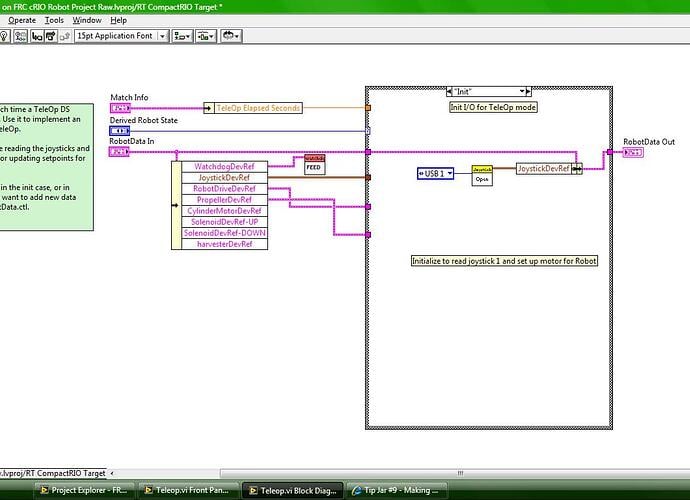

We are using the Advanced Framework. In there, the joystick (USB1) is initialized in TeleOp-Init. How do we make a second one there? The JoystickDevRef is what’s confusing us…
[see attached image for where I mean]
You need to edit the typedef for the Robot Data In control. There are at least three ways to open the typedef. Use any one of the these three:
  1. Select the Robot Data In control on the front panel and select Edit->Customize Control… from the front panel
2.or right click the control and select “Open Typedef”.
  1. or Goto the project explorer, open the TypeDefs folder, and double click RobotData.ctl
Once the typedef is open, add a 2nd JoystickDevRef and name it to reflect what it does. Save the control

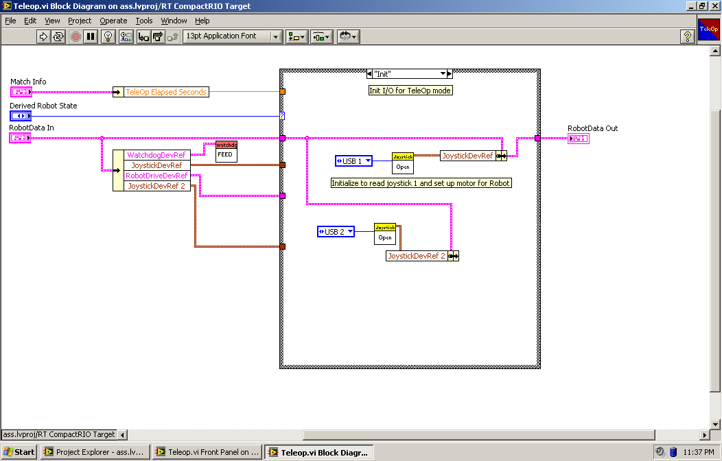

I believe the problem is that in your Teleop.vi you never initialized the Joystick DevRef 2. You definitely ought to Open the joystick and assign the Joystick DevRef 2 before using it.
OK, looking back at the image I posted at the top…

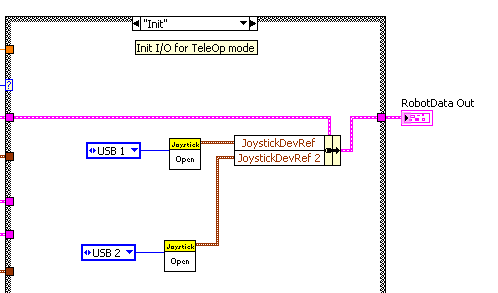

I created the second DevRef as instructed. I added it and set it for USB2. I expanded the bundle on the left to now show “JoystickDevRef2” and sent the brownish wire out of that into the case structure (Init). Then I branched in the pink line (RobotData In) as the input cluster. However, if I try to send the output cluster to RobotData Out I get an error that states: Wire connects to an undirected tunnel.
So, the question: once I create the second JoystickDevRef, how do I get it’s output to continue on and be used in the RobotData Out?
PS: With it configured as above, the RUN arrow is not broken…
You can do this one of two ways:
(by the way bundle refers to the operation of putting values into a cluster. Unbundle refers to the operation of getting values out of a cluster).
  1. bundle them one at a time (see 2nd picture)
If you bundle each value one at a time as you are doing, you need to wire the output of one bundle (the right most connector of the bundle) into the input of the next one (the middle connector of the bundle).
  1. bundle them both using the same bundle function. (see 1st picture) Assuming that the cluster has more than one value in it, you can stretch your Bundle By Name function so that it has more than one input. Then for each bundle value, you can select the name of the value that you want to bundle.

My init case looks exactly the same as yours. The problem must lie deeper… When I get accesses to the robot I’m going to start checking for physical issues. I already have checked the robot wiring, so I suspect that there may be something wonky with our O/I station.
Pausert,
The REX build up zip that you posted yesterday at 07:15 pm is missing a Joystick Open in the Teleop.vi Init case. The USB 1 Joystick is opened and assigned to JoystickDevRef, but the JoystickDevRef 2 is unassigned.
This could certainly create strange behavior.
