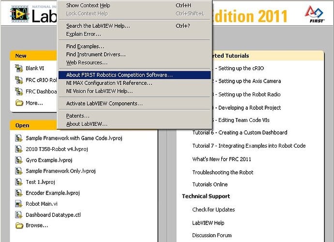

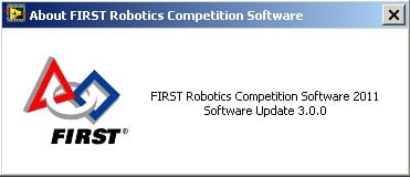

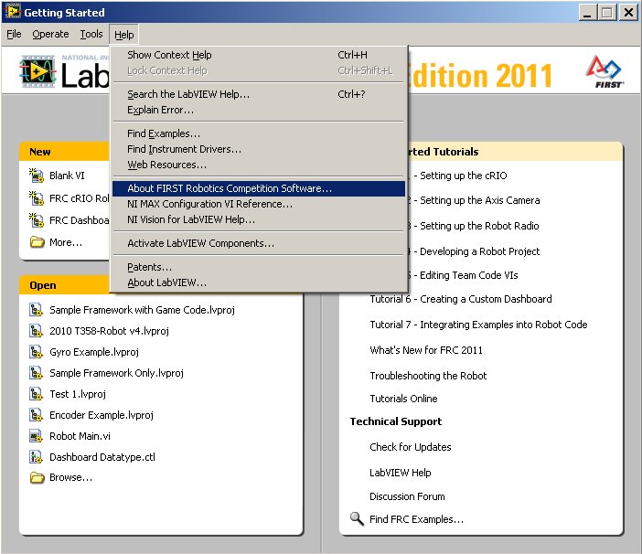

Let’s check your LabVIEW version first.
On the top menu bar look under “Help” for “About FIRST Robotics Competition Software…”
to see if you have Software Update 3.0.0
I’ve attached pictures of what you should see.
If you do not even see the choice then you do not have the LabVIEW update installed.
My laptop shows ver 3.0.0. I’ll have to wait till I get to school this afternoon to check the development computer.
