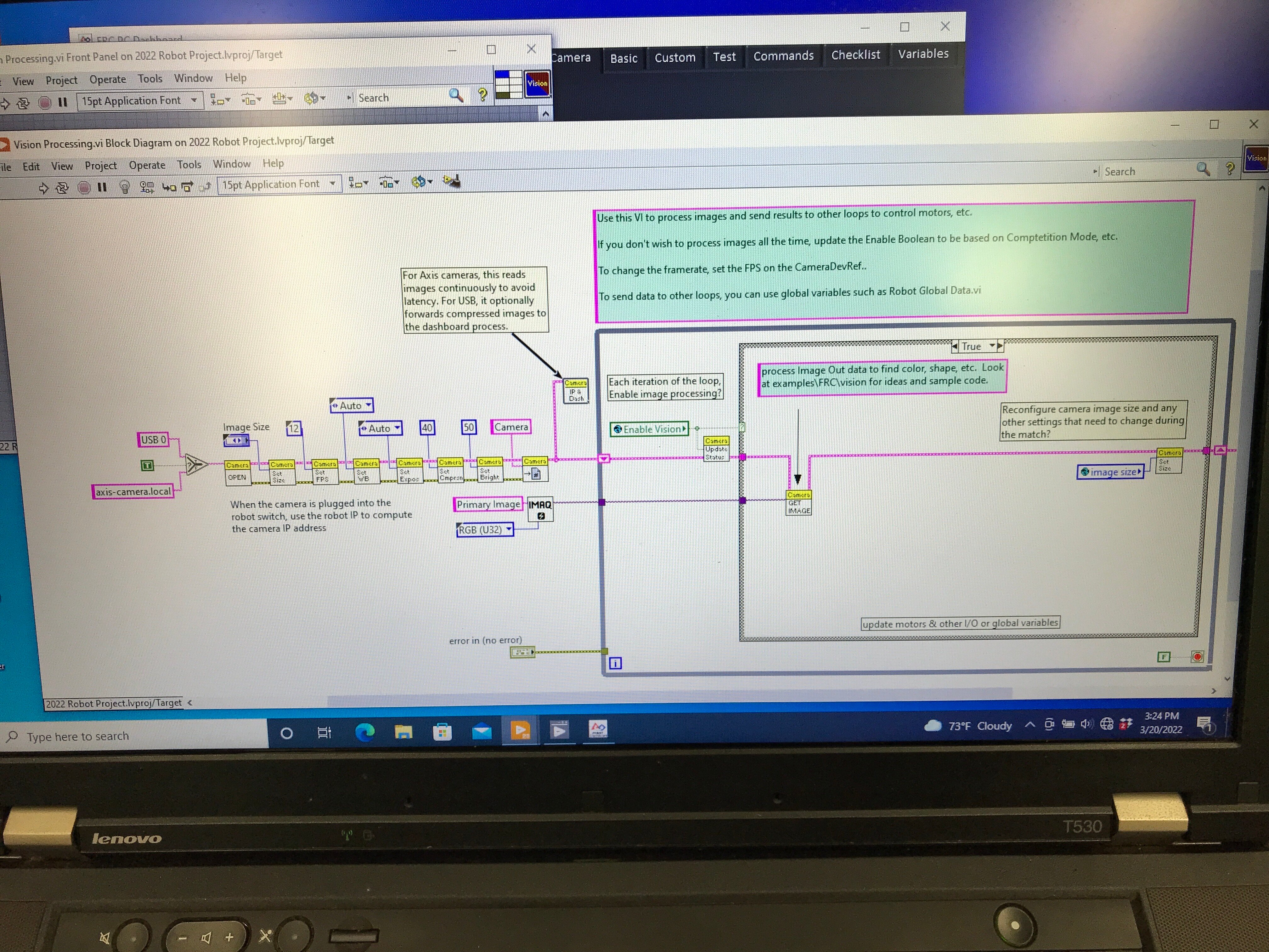

Hello all,
We are trying to add a second camera to our driver station and can’t seem to get it working in labview. So far, we have tried replicating the existing code within vision (while just renaming the second camera to USB1), but with no success (still doesn’t show up on driver station). We are running two Microsoft Lifecam 3000 cameras. Can we get some assistance with this? Thank you!

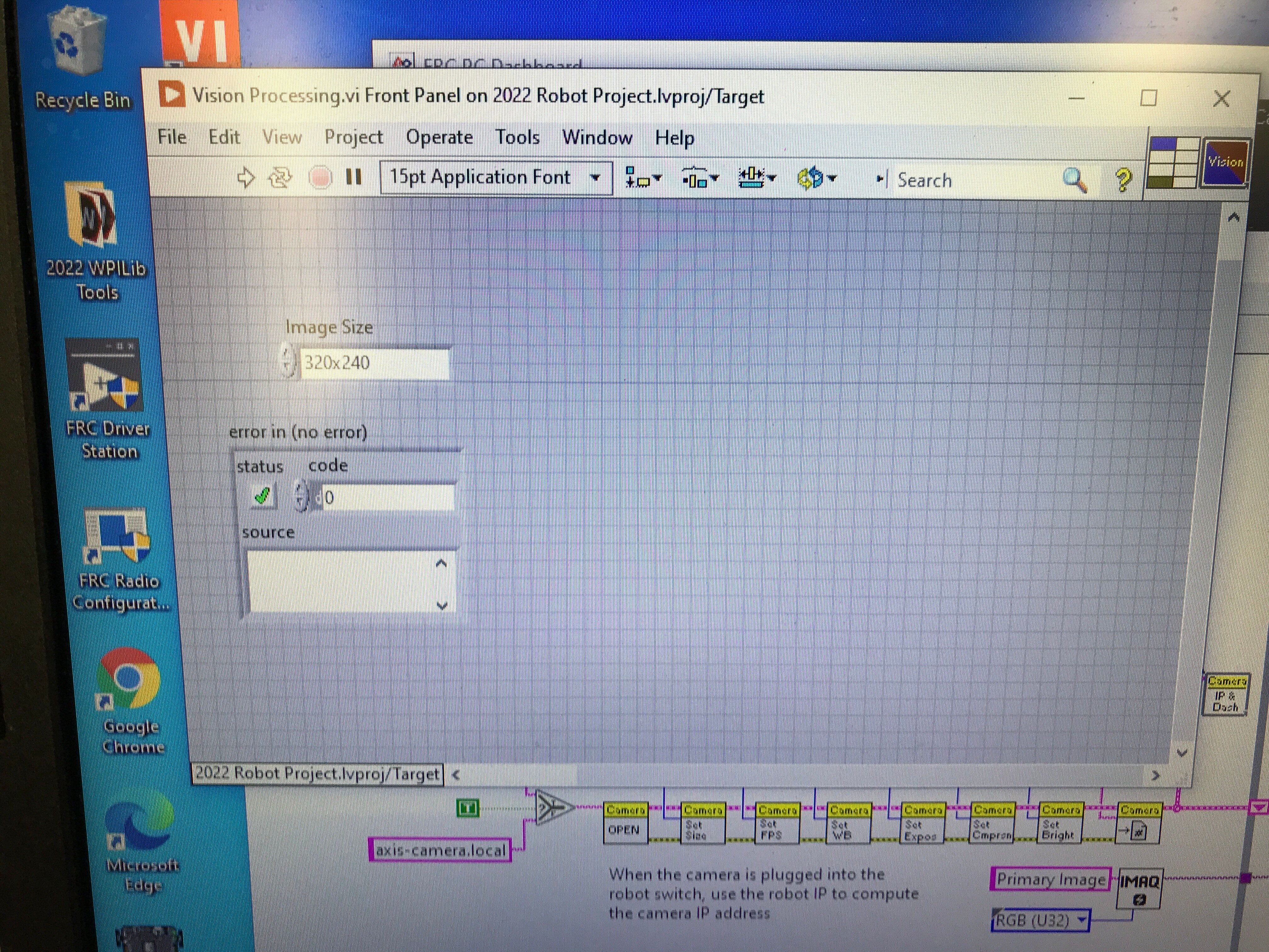

The Vision Processing.vi isn’t called by the default project.
The multiple cameras are handled by default in another way.
Got it. We used the default “FRC RoboRio” Project.
We got it! Ended up just needing to drag the Vision Processing.vi into our Robot Main. Thank you!
