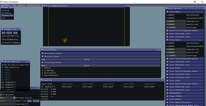

Hey there! my name is Liran and I am from NeatTeam #1943. After I finished making a basic drive train simulation I started looking around and saw that you can change your simScreen characteristics to look like the current season’s layout. Currently I am in a bit of a struggle adding the image to the layout… is it just a jpg? Can I get any image? where can I find these images (they are not in the simulation guide in wpilib)

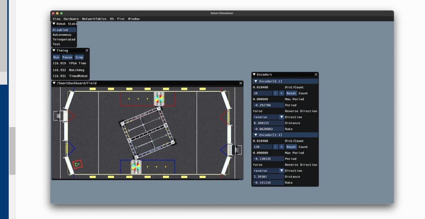

poof of concept :point_down:
Current:

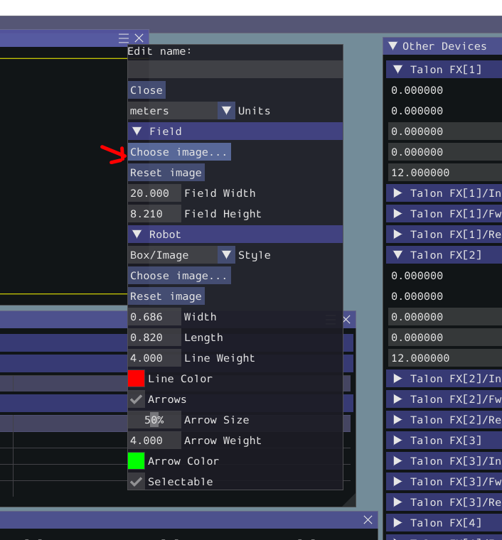

I got to the screen →
but I can only add the picture here… where does the json fits?
One option for the “image” is to select the json file. The json internally then points to the image.
