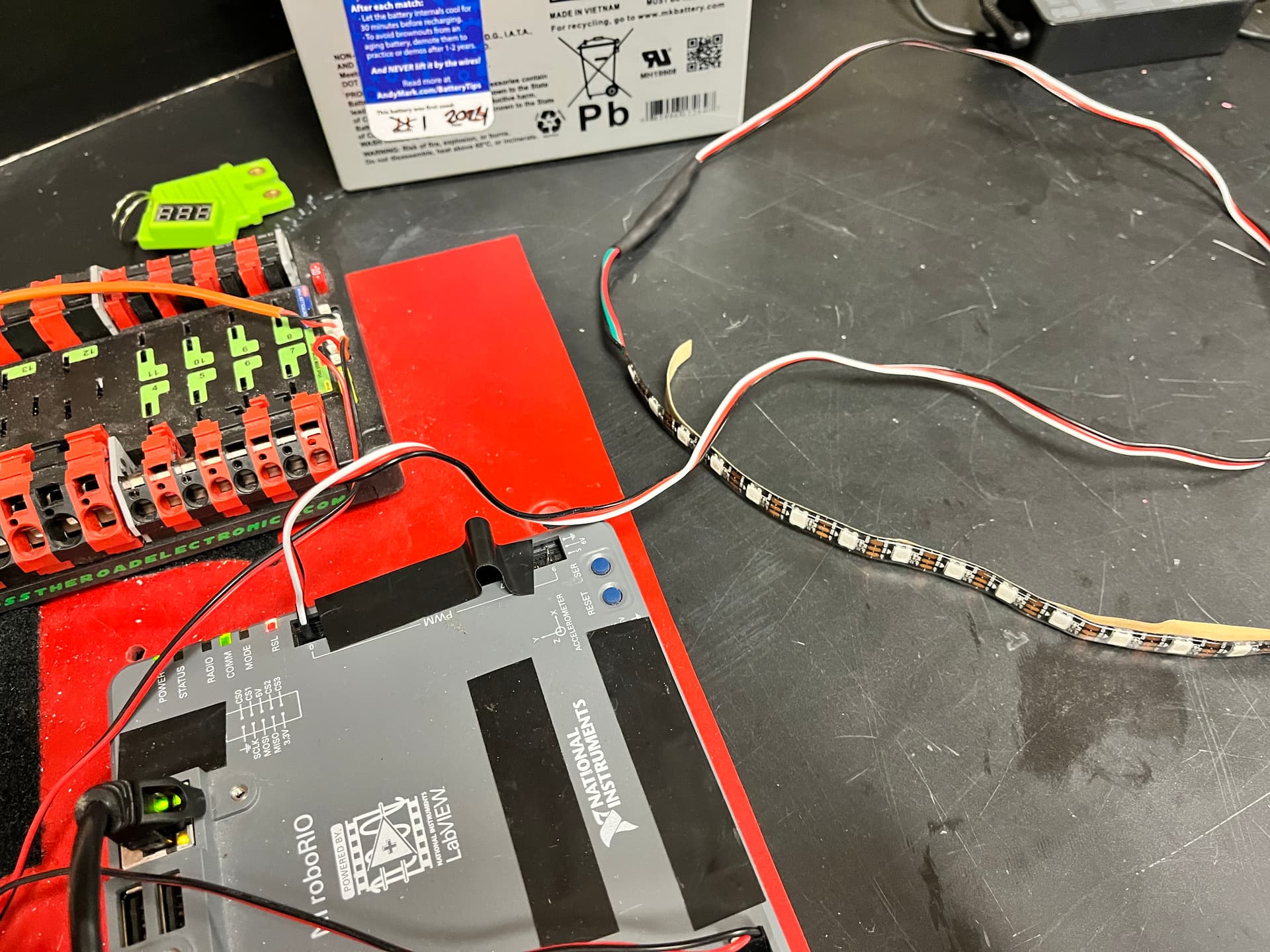

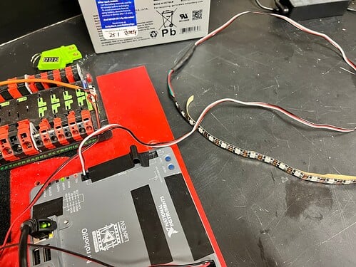

This is our current setup for LEDs. We have WS2812B LED Strips and a roboRIO 2. I read on WPILib’s documentation about AddressableLEDs that WPILib has an API for controlling LEDs via the PWM port, so we just soldered a PWM cable to the LED strip. When we try to run the code, it does not light up. What’s wrong with our current setup?

Try swapping start and setData() so that you start it first. You call setData() every time you want new data to show.
This is most likely a wiring issue. Most LED strips you’ll find operate on 5V, however the RoboRIO’s PWM output pin supplies 6V. I suggest that you power the LEDs from elsewhere (such as the VRM) and only route the signal wire to the RoboRIO.
Also, be mindful about the current draw of those LEDs, a strip of 60 probably requires at least 3 to 4 Amps from what I’m guessing.

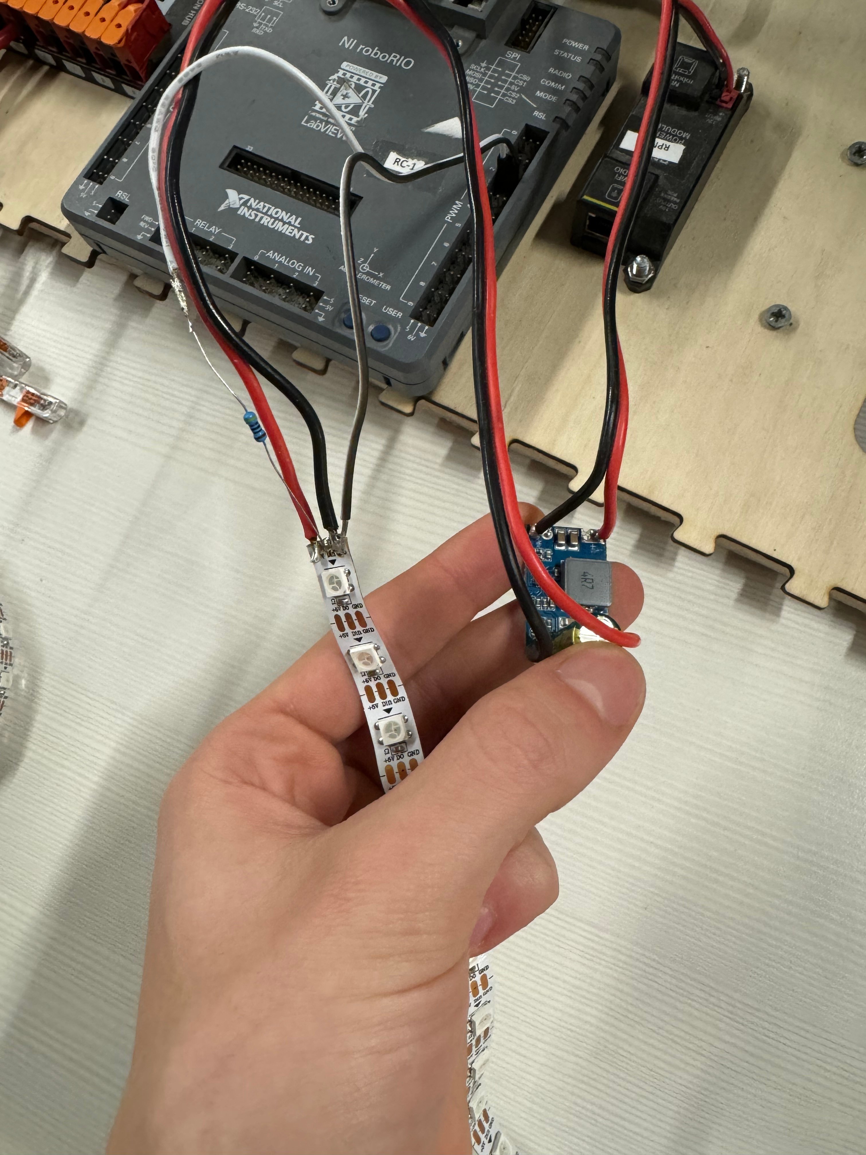

I’m not currently at our shop however, I found a picture of one of my test setups (it was still a test, the final product is tidier):
In the picture you see on the right a 12V to 5V-5A Buck converter, which has a capacitor soldered to it.
You can also see a black and a white wire going to our RoboRio, the white one is the signal wire and black is the neutral wire.
Both the neutral of the buck converter and of the RoboRio are soldered to the neutral of the LED strip. The +5V of the buck converter is soldered to the Vin/+5V of the LED strip and the signal wire of the RoboRio is soldered to a 470 Ohm resistor which is soldered to the Din of the led strip.

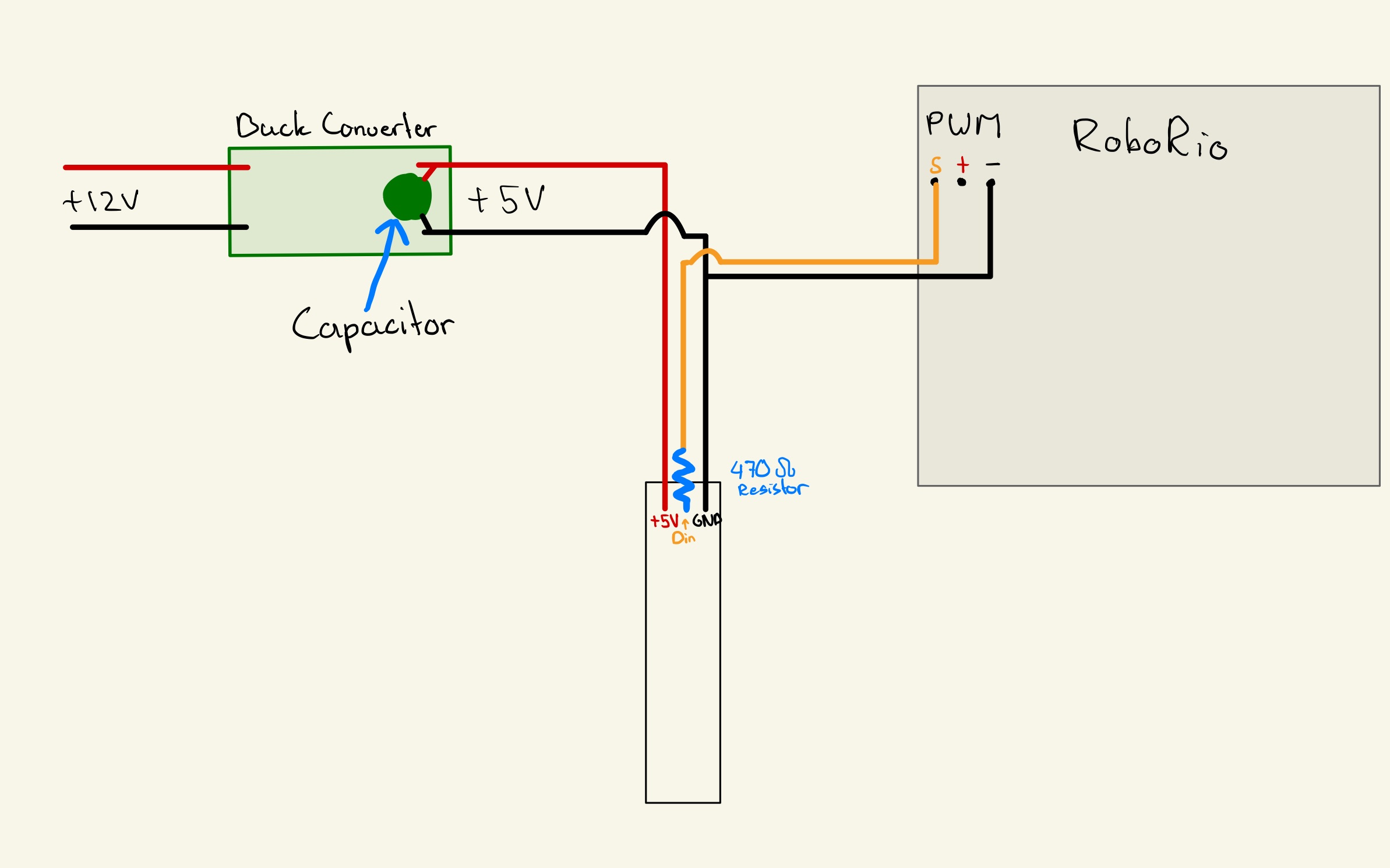

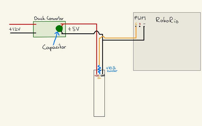

Here I drew a schematic:
Little extra info:
  • The added capacitor is for stabilising power going to the LED strip
  • The added resistor is for filtering out some signal noise
This is the way we will be connecting our LED strip this year. Not sure if it’s the best way but it’s our way of doing things :smile:

Also, these converters work well, and pretty easy to use (doesn’t have to be this seller). Use the wiring diagram from Julianvdh. Amazon.com
