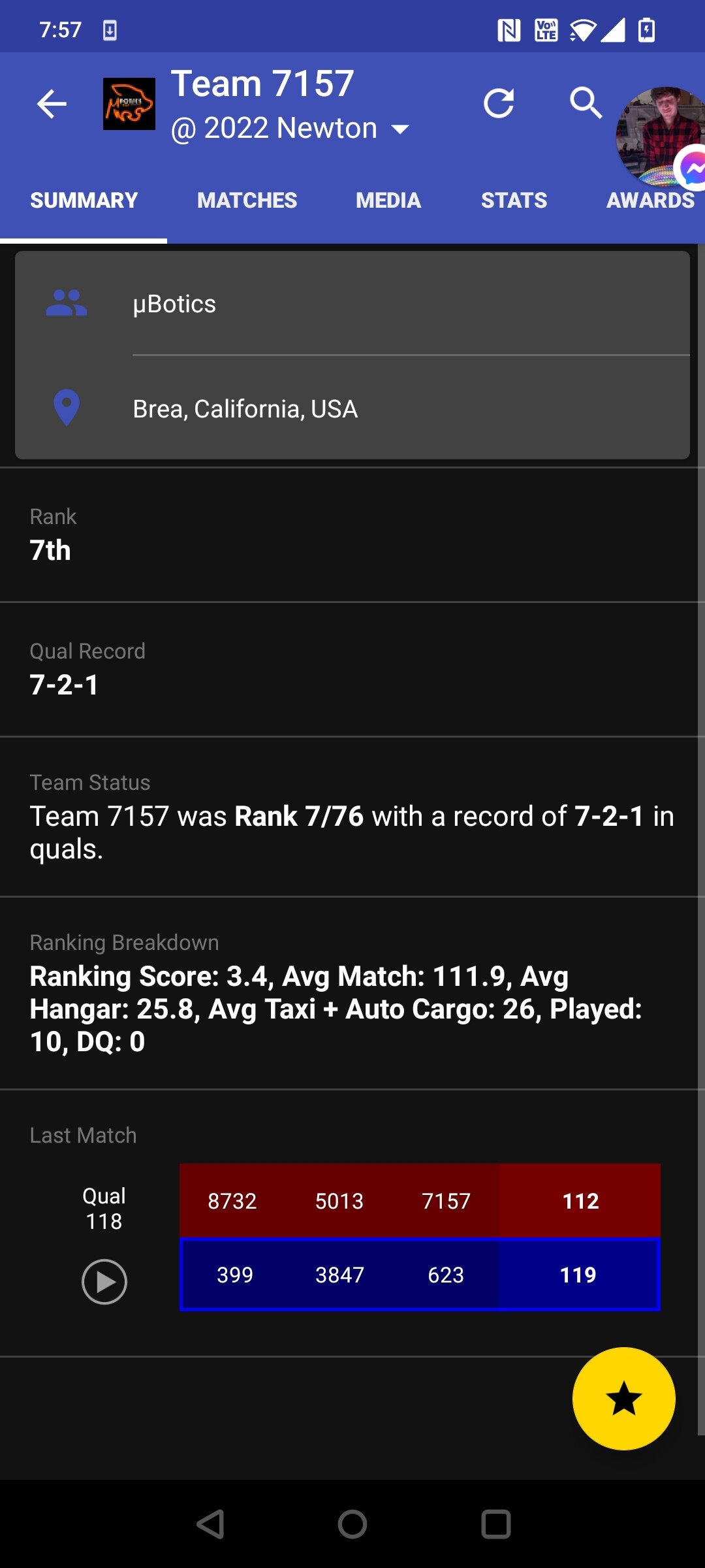

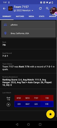

973, 8033, 604, and 7157 are all really good shooters with fixed shot angles that shoot amazingly well. However, a fixed angle does mean that you either lose access to close or far shots - 973 can only shoot from a certain distance away. The other listed teams all tend to lose accuracy the farther out they go, so they can’t make launchpad shots easily.
I also just found that 7157 was finalist at three events this year, but didn’t qualify for champs. Weak.
