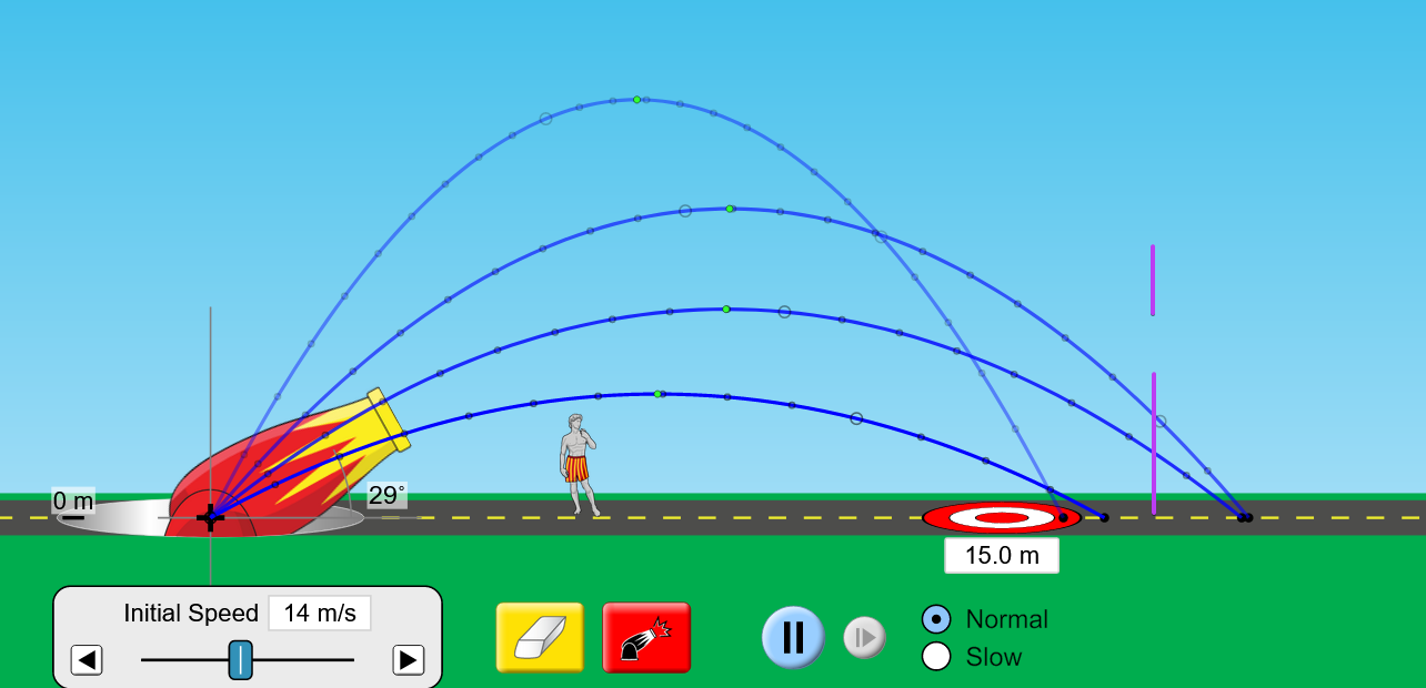

‪Projectile Motion‬ is a good simulator to fiddle with to help visualize the concept.
Both shooter RPM and release angle have the ability to change the trajectory of the ball, but the key is that they change it in different ways. If you have the ability to reliably control the release angle of the ball, you gain an additional degree of freedom to pick the velocity vector of the ball as it passes through a goal.
For a year like 2020, having a flat trajectory through the goal is preferable to maximize your chances of going through the goal. An adjustable hood allows you to get this flat trajectory at the goal from a much wider range of starting positions.
Roughly, in pictures: Here’s shooter velocity changing, but fixed angle:
Here’s angle changing, but fixed shooter velocity
The two have some similarities, but aren’t exactly the same.

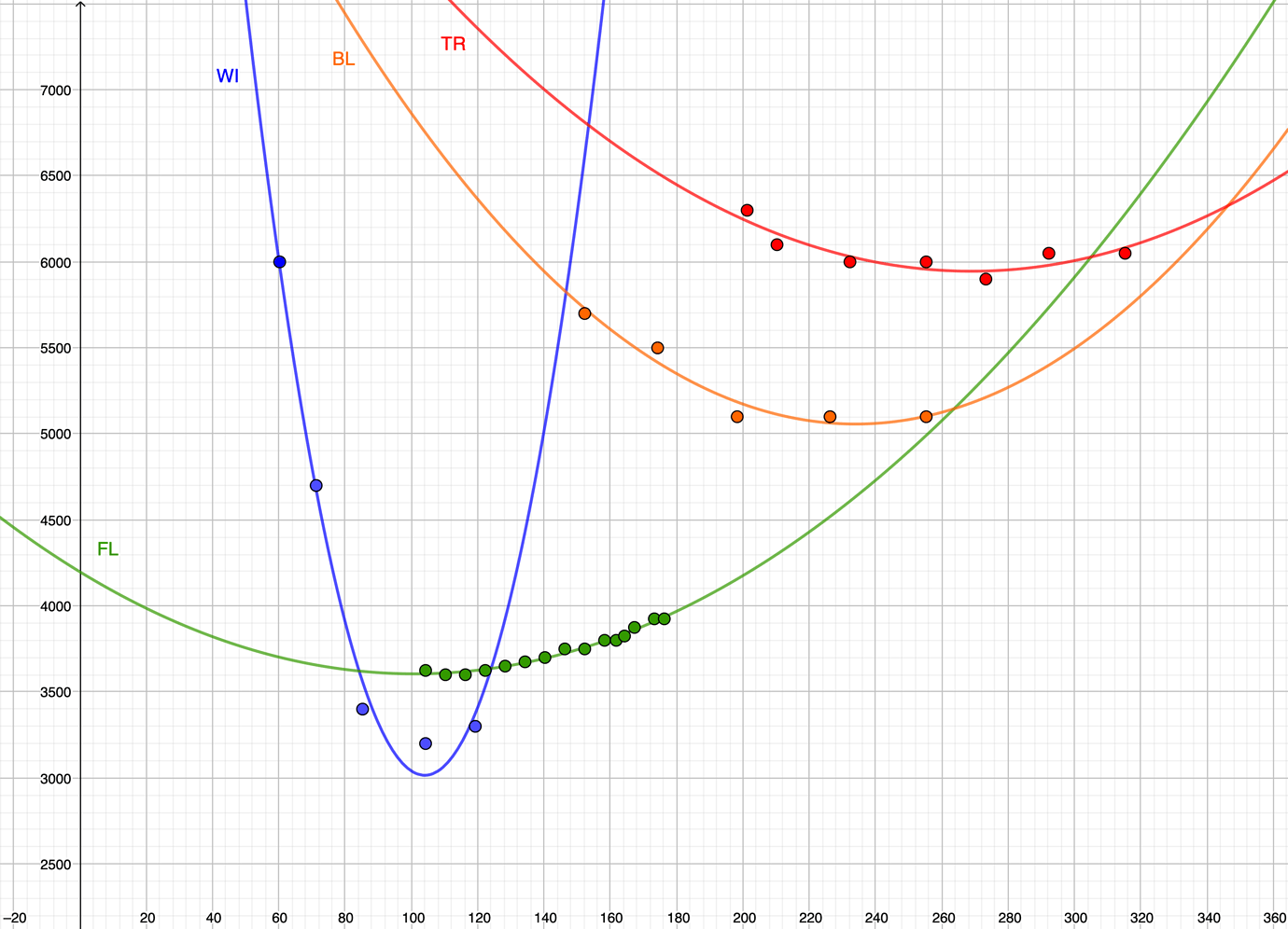

If you’re interested in seeing some graphs of measured actual results… 6328 did a hybrid approach using multiple pneumatically-operated hood stops with variable flywheel speed, ultimately covering the whole field range. In our build thread we initially talked about the characterization process and curve-fitting for our original 3-position hood and then moving the middle stop and ultimately deciding to change to a 4-position arrangement. We felt this was a good mix of mechanical simplicity and range flexibility; our final arrangement with the flywheel-speed curves fit for the 4 positions looks like this:
