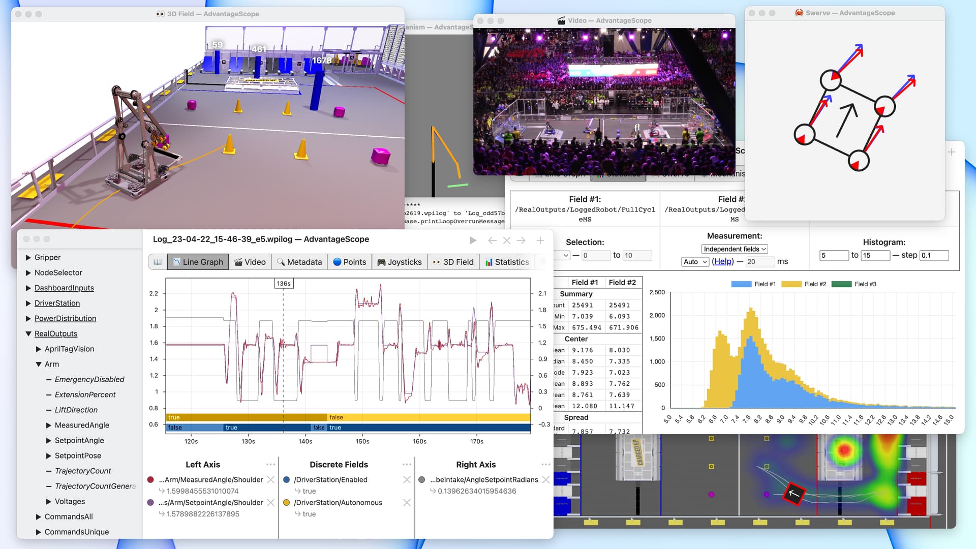

For those unfamiliar, AdvantageScope is a robot diagnostics, log review/analysis, and data visualization application developed by Team 6328. It was released initially for the 2022 season, then split from its sister project AdvantageKit for the 2023 season. AdvantageScope enables a variety of visualizations for any WPILib project, both live over the network and by opening robot log files. We are humbled by the community response to this project, and AdvantageScope now has almost 6,000 downloads :heart:.
For a more complete picture of what’s possible with AdvantageScope, my conference from the 2023 Championship provides more examples and detailed explanations:

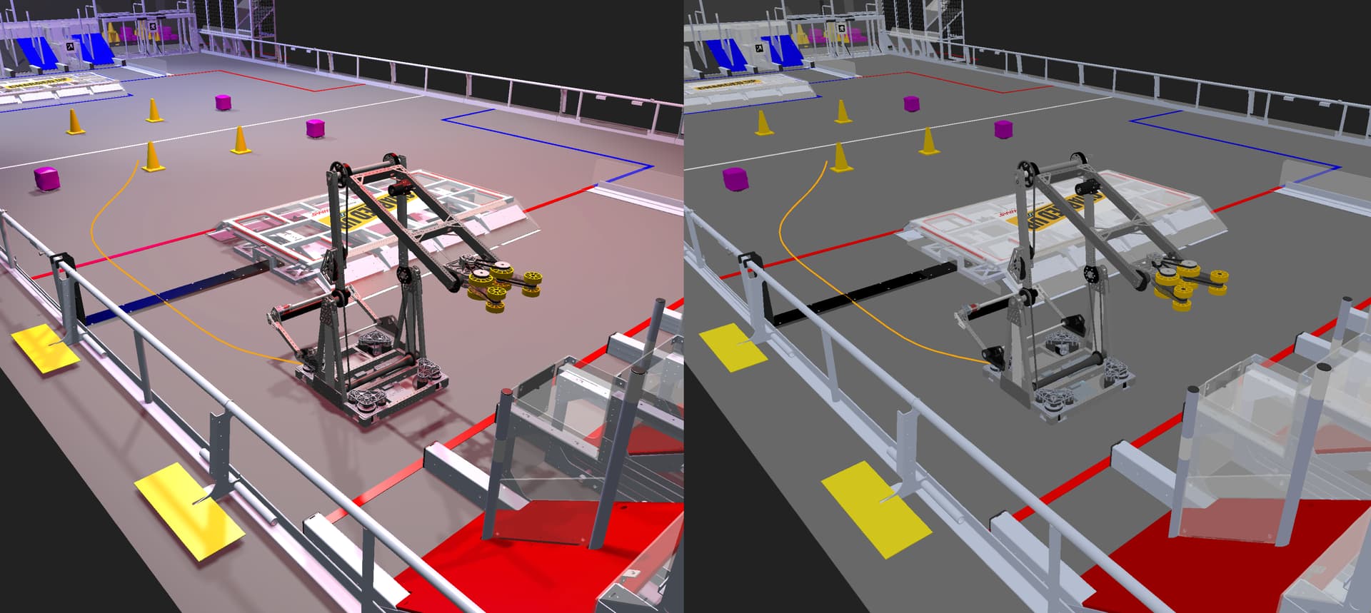

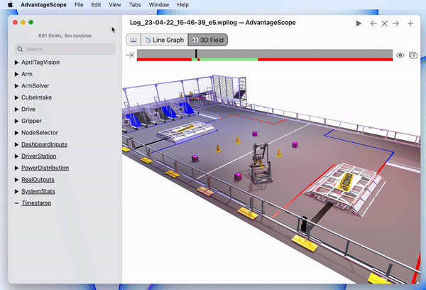

Cinematic Mode
Cinematic mode is an alternative 3D rendering mode that includes shadows, lighting, and reflections for a more realistic look. The default rendering mode is unchanged, since cinematic mode requires a decent GPU to run smoothly. The comparison below shows the difference in quality between the cinematic and standard rendering modes (standard is equivalent to AdvantageScope 2023).

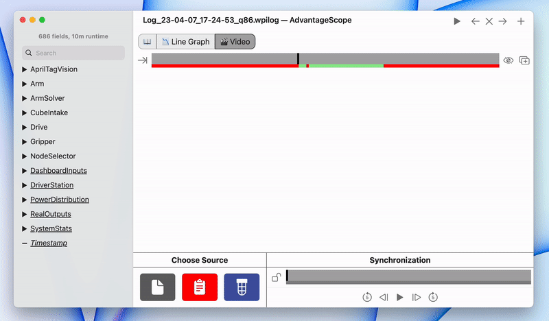

TBA Video Download
Powered by The Blue Alliance.
AdvantageScope supports synchronizing a match video to a log file. However, the 2023 version required a local video for this feature. Now, you can find and load a match video from The Blue Alliance with a single click:
TBA Video Download
AdvantageScope finds the match on TBA using metadata stored in the log file, and offers a selection of videos to download if multiple are available. You can also provide a YouTube URL directly for matches not available on TBA.
Documentation is available here.

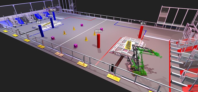

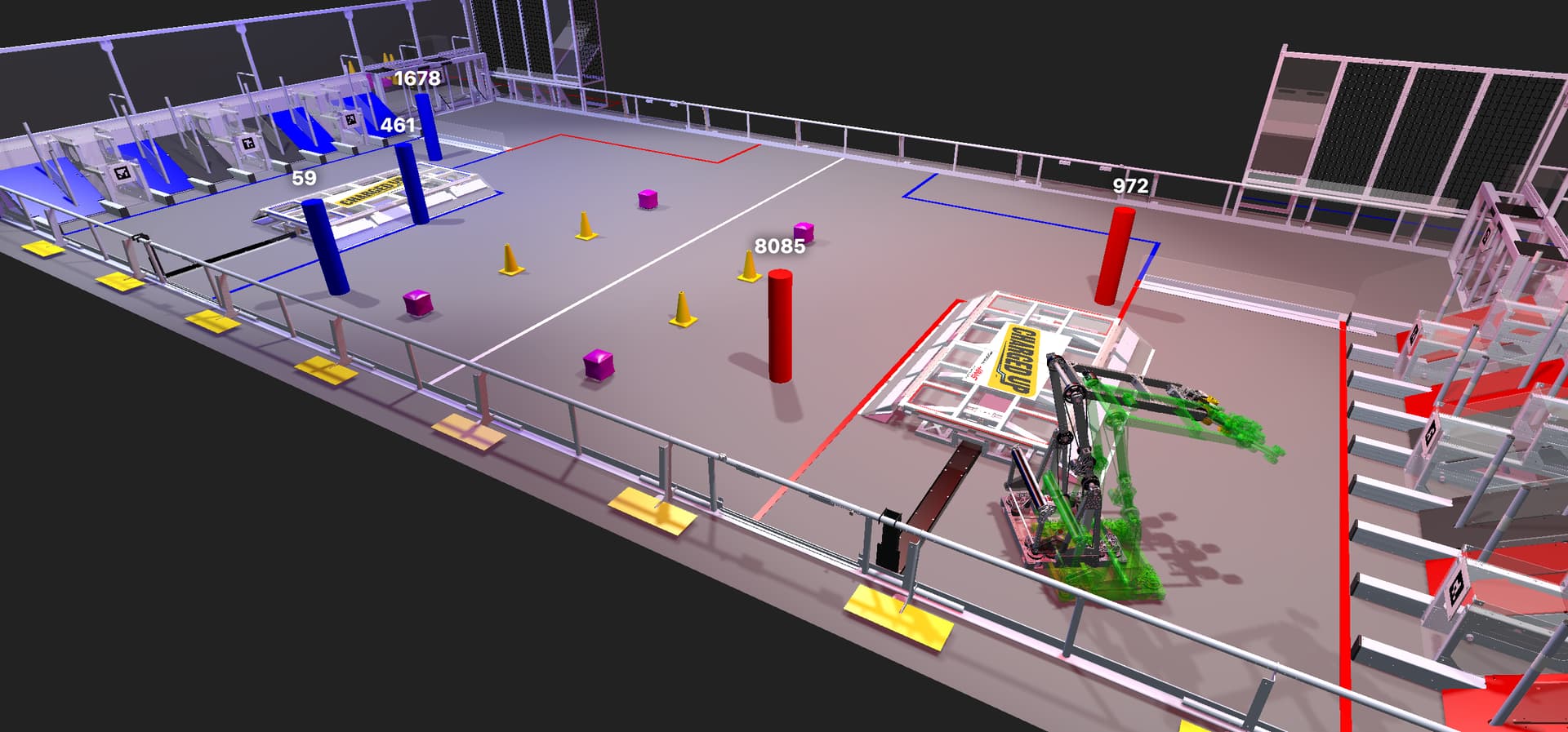

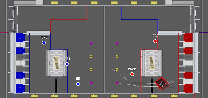

Zebra MotionWorks Integration
Zebra MotionWorks data is available at some FRC events to track the position of robots throughout the match. I’ve written before about 6328’s work to compare Zebra data to our robot’s onboard localization. This was typically an arduous process that involved a Python script, AdvantageKit log replay, and other custom tooling. I’ve pleased to demonstrate the new and improved process built in to AdvantageScope:
Zebra Download
This uses the same logic as the TBA video download to extract match metadata from the log. Zebra data can be visualized on the odometry or 3D field views, as markers with team number annotations or as a translucent “ghost” robot (both types are shown in the examples below).

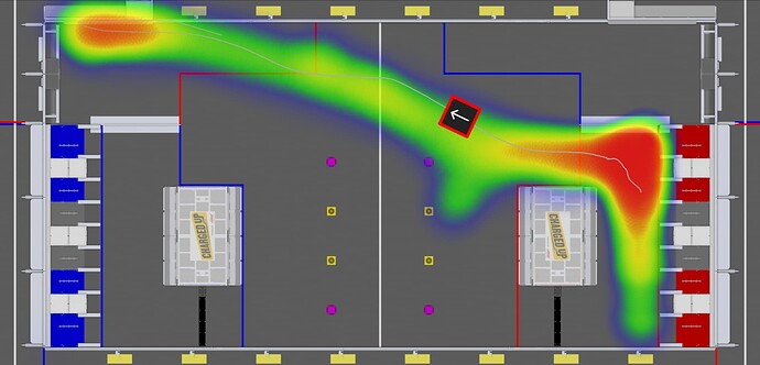

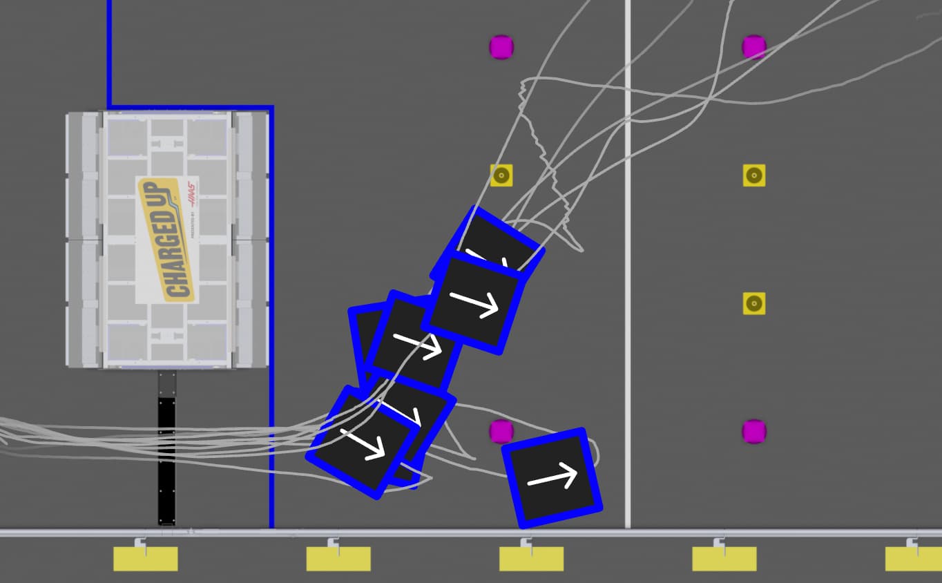

Odometry Heatmap
As onboard robot localization becomes increasingly accurate, it’s often reliable enough to assist in analyzing match strategy. AdvantageScope’s odometry tab now includes a heatmap visualization based on the provided pose data:
You can generate the heatmap using all pose data, or limit it to times that the robot is enabled. It can also be combined with all other standard object types.

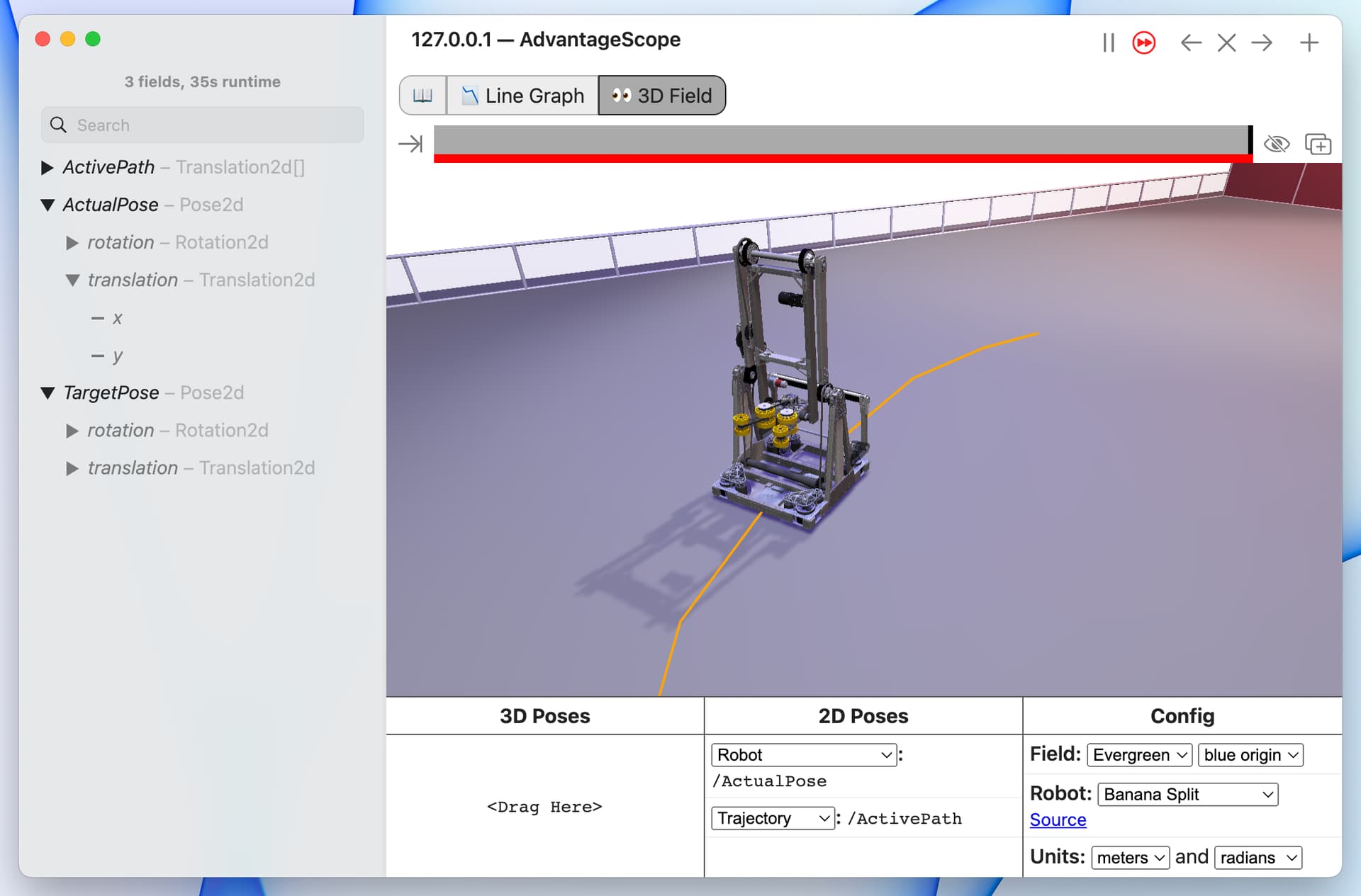

NT Publishing

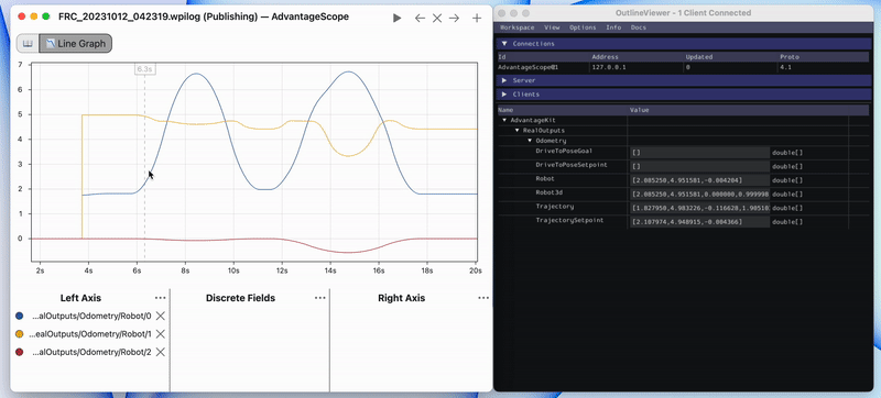

For logs that include NetworkTables data, you can now publish all (or a subset) of fields to a NetworkTables server in real time. Possible use cases include:
  • Replaying matches in simulation for debugging.
  • Mimicking data from a coprocessor on a real robot.
  • Debugging driver dashboard applications using realistic match data.
This example shows several poses being published from AdvantageScope to an OutlineViewer (NT server) instance:
NT Publishing

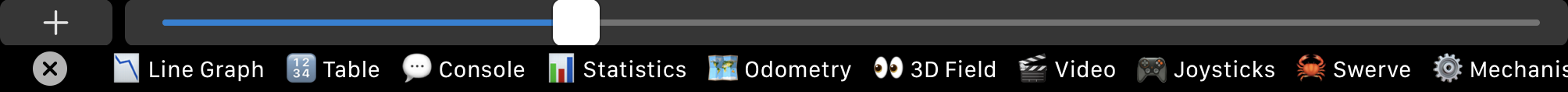

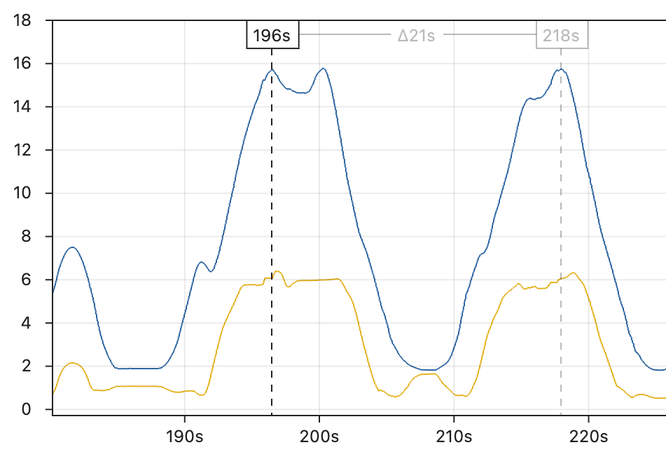

There are a variety of quality of life improvements for navigating log data. On the line graph, the selected and hovered timestamps are displayed along with the delta between them:

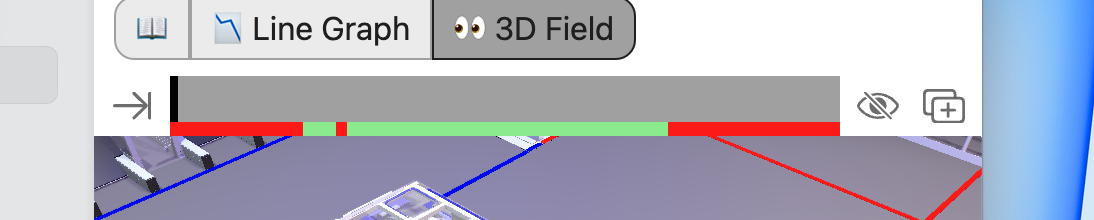

The timeline controls are improved too, with buttons to jump to the first robot enable and hide/show the visualization controls:
On MacBooks with a Touch Bar, you can now scrub through the log or add new tabs using a touch interface:

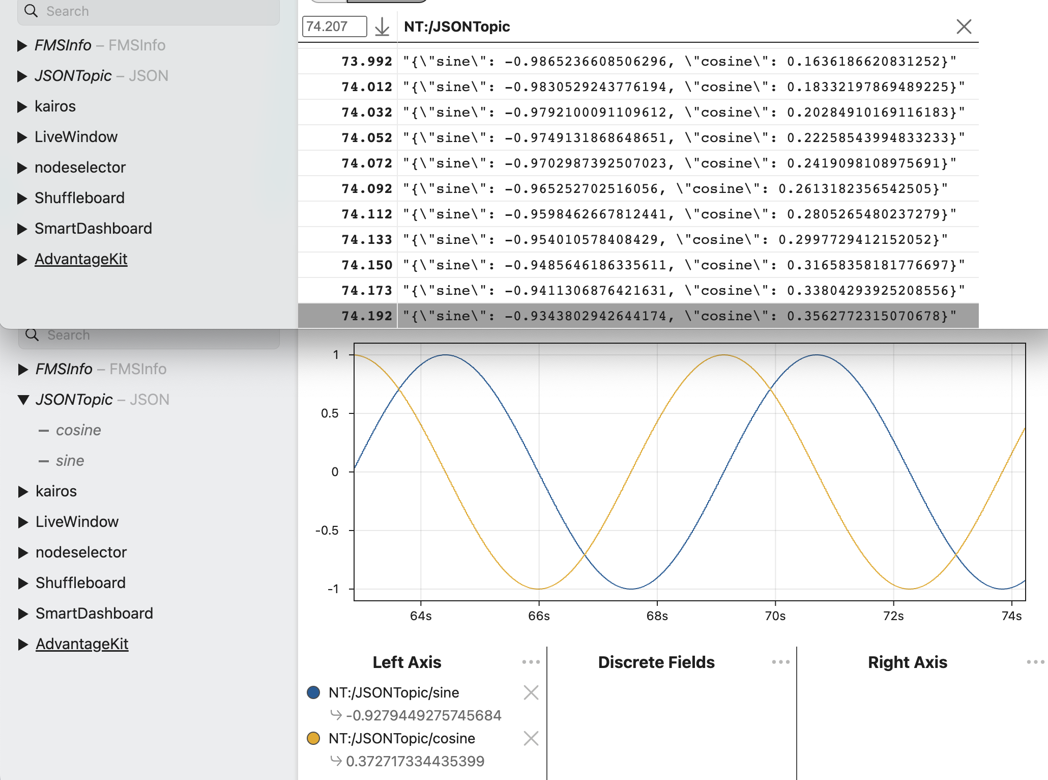

JSON & MessagePack Support
You can now individually view fields contained in JSON or MessagePack data. Here’s an example with a JSON field containing two numeric fields:

Do multiple heatmap field objects just add datapoints to the same heatmap layer? I’m trying to merge logs and view the heatmap of the robot pose overall.
Yes, all of the heatmap poses are added to the same layer. It’s normalized automatically, so the overall heatmap won’t become more red as you add more data.

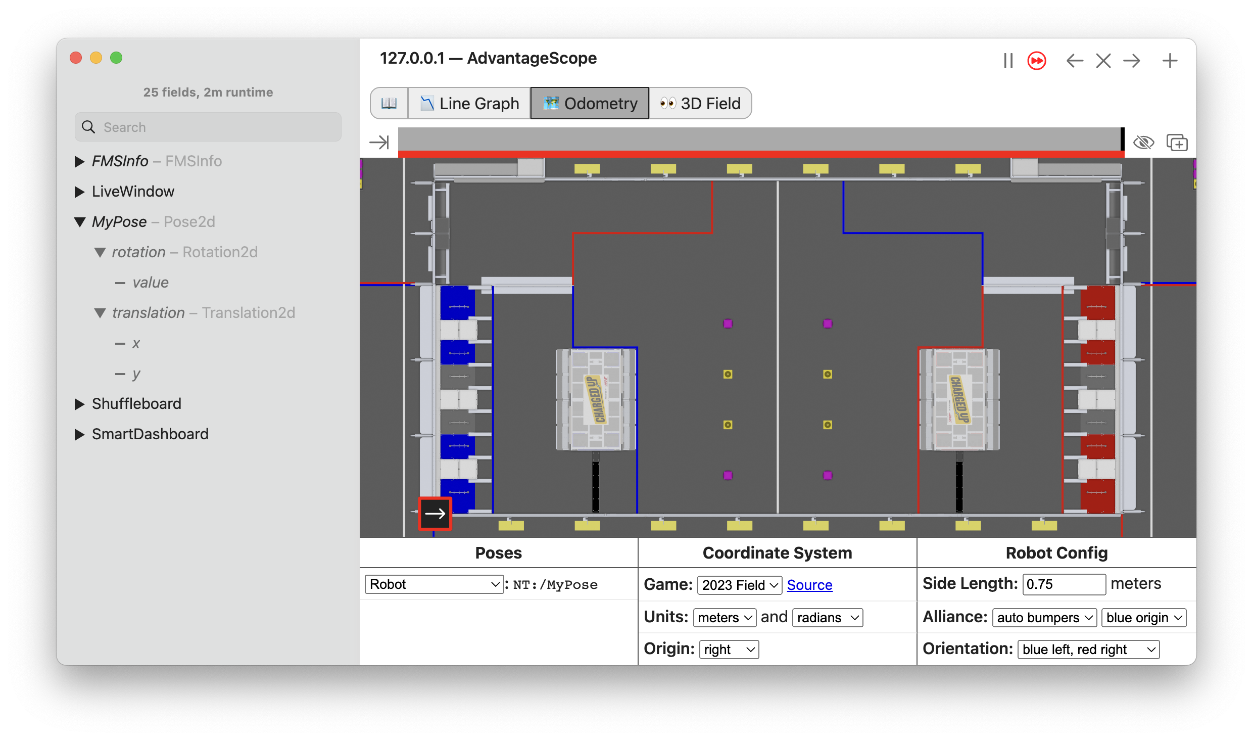

AdvantageScope Beta 3 adds support for struct & protobuf serialization with NetworkTables and data logs. This is a new feature just released in the second WPILib beta, so detailed documentation isn’t available yet. To give some idea, here’s an example of how a pose can now be published to NT:
StructPublisher<Pose2d> publisher = NetworkTableInstance.getDefault().getStructTopic("/MyPose", Pose2d.struct).publish();
publisher.set(new Pose2d());
AdvantageScope recognizes data types like this, so you can inspect individual fields or visualize the pose itself. This system also ensures that objects are only used in valid contexts, so you can’t mix up a 2D and 3D pose. Some specialized object types are also supported — if you send a Trajectory, AdvantageScope will automatically visualize it as a “trajectory” rather than a “robot.” And of course, these fields can be opened and replayed from a log file.
Keep an eye out for updates to this feature in the future as we improve documentation, examples, and support for more objects. AdvantageKit users won’t be left out of the fun either…

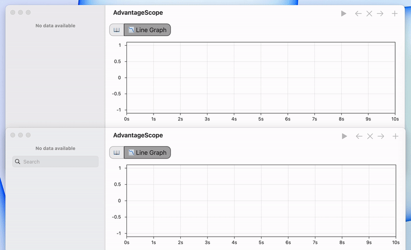

I was messing around with some of the 6328 Einstein logs earlier and I have a few suggestions regarding the multi-window support. Could there be a button to bring all windows to the front? It would make it easier to configure layouts and not have to press Alt+Tab a million times. Similarly, could there be a draggable grid layout thing for different data viewer widgets? I’m not sure if this is possible since I know first hand that this type of feature is a pain, but if it’s possible it would be really useful. Lastly, I’m not sure if there’s a shortcut to pause/play a log since I didn’t have the time to check, but if there isn’t, could there be one?
I absolutely love these new features, keep up the good work!
I wouldn’t rule it out, though I’ve been trying to rely on the OS’s native windowing support as much as possible (I generally find it frustrating to use apps that do their own thing for arbitrary reasons). macOS has a button in the menu bar to bring all windows to the front, but I don’t know about Windows and Linux. On platforms that don’t support it natively, I’d be willing to add a button for it.
Part of this is about the complexity of the implementation, but it’s also about scope creep. AdvantageScope is not a driver dashboard, and I’d rather avoid adding features that bring it closer to one (because the inevitably conclusion is continuing to add features in that direction until it becomes impossible to maintain). I get that there are other use cases for a grid layout like this, but I think the multi-window system makes the use case clear while being significantly easier to maintain. Projects like Elastic and FRC Web Components are designed as driver dashboards from the ground up, so I think it makes sense for AdvantageScope to remain distinct in terms of functionality.
You can press space to toggle playback, though you sometimes need to be careful that there isn’t a text box selected.
