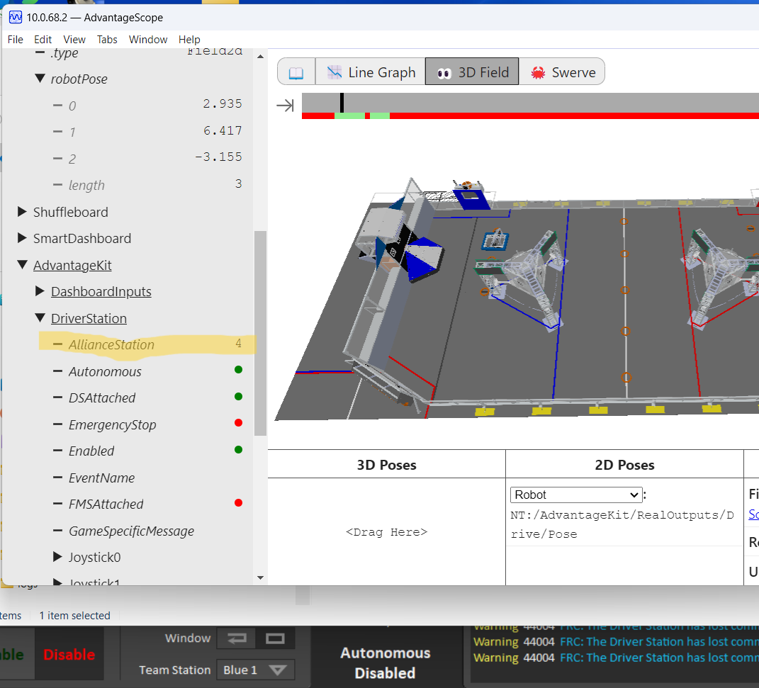

sorry, this is probably a simple question. In AdvantageScope I see station 4 reported. drivestation is set to blue 1. Does that make Red1 alliance station 1? or something strange like Red3 is alliance station 1.
I found elsewhere:
Blue1 Red3
speaker speaker
Blue2 Red2
Blue3 Red1
Yes your assumption is correct
Red 1 - 1
Red 2 - 2
Red 3 - 3
Blue 1 - 4
Blue 2 - 5
Blue 3 - 6
